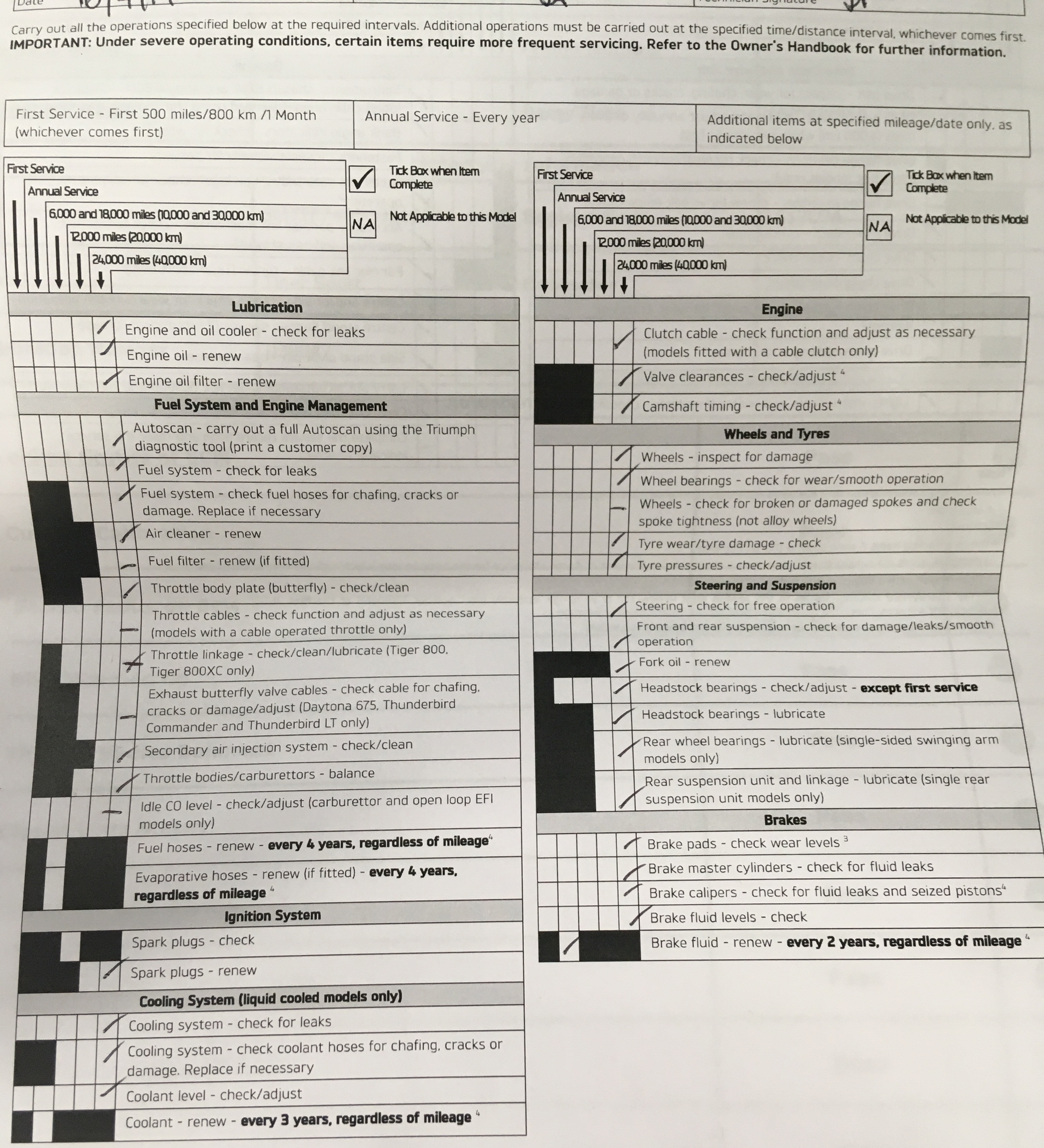

    I’d be interested to hear how you get on after a few more miles on them. I’ve had Road 5 on my Tiger Sport for a while and they don’t feel as “sure footed” as the Pilot Road 4 I had in the past. It’s odd, but these are the 2nd set of Road 5 I’ve had and when I look at the profile of them, they look “bumpy” - with the rubber at different heights by the groves/threads, if that makes sense :S Probably done over 4k miles on this set and never noticed this before.
    See photo of rear where the shadows hopefully highlight what im trying to describe.

    lumpster.....do you carry a pillion regularly? Is your rear suspension up to it? The wear characteristics on that tyre looks like it was caused by a rear shock not up to the job being asked of it.

    Yup, that’s definitely a suspension problem, not a tire issue.

    Hmmm, I never thought of the suspension, nor its setting. No pillion, though I do have a top box for the laptop/commute. Keep them above 40PSI, and typically spot on the 42PSI (cold) recommended by Triumph, checking them monthly. Bike had its 24k service last week where Triumph dealer checked the whole bike (see photo of checksheet), indicating suspension and tyres check didnt find anything suspect. :S Thanks for your reply Chewie and SteveRS - I’ll go and investigate it further and post back here when I have an update. Ps just got a puntchure on rear tyre today, so looking to replace now :S #luckyguynot

    The mechanical check is for safety, ware and maintance it's not for settings.

    I agree with Sprinter, that’s just a safety checklist. Sag settings need checking as well as how old the oil is in the suspension. If compression and rebound has to be clicked a long ways in to achieve correct settings, then the oil is done. Have other tires presented the same ware? If so, maybe suspension setting have never been setup properly.

    Was good to meet you this morning, (I was gettin the MOT done on my Speed Triple and met Lumpster by coincidence while his tyres were being sorted) rear tyre is certainly suffering the effects of suspension not being set up properly
    As mentioned, call me when free and I am more than happy to go over suspension setup with you and see what we can find
    I do recon the spring isn't up to the job though and the bike would benefit from a new shock (Nitron is my recommendation) - happy to help you fit this too.
