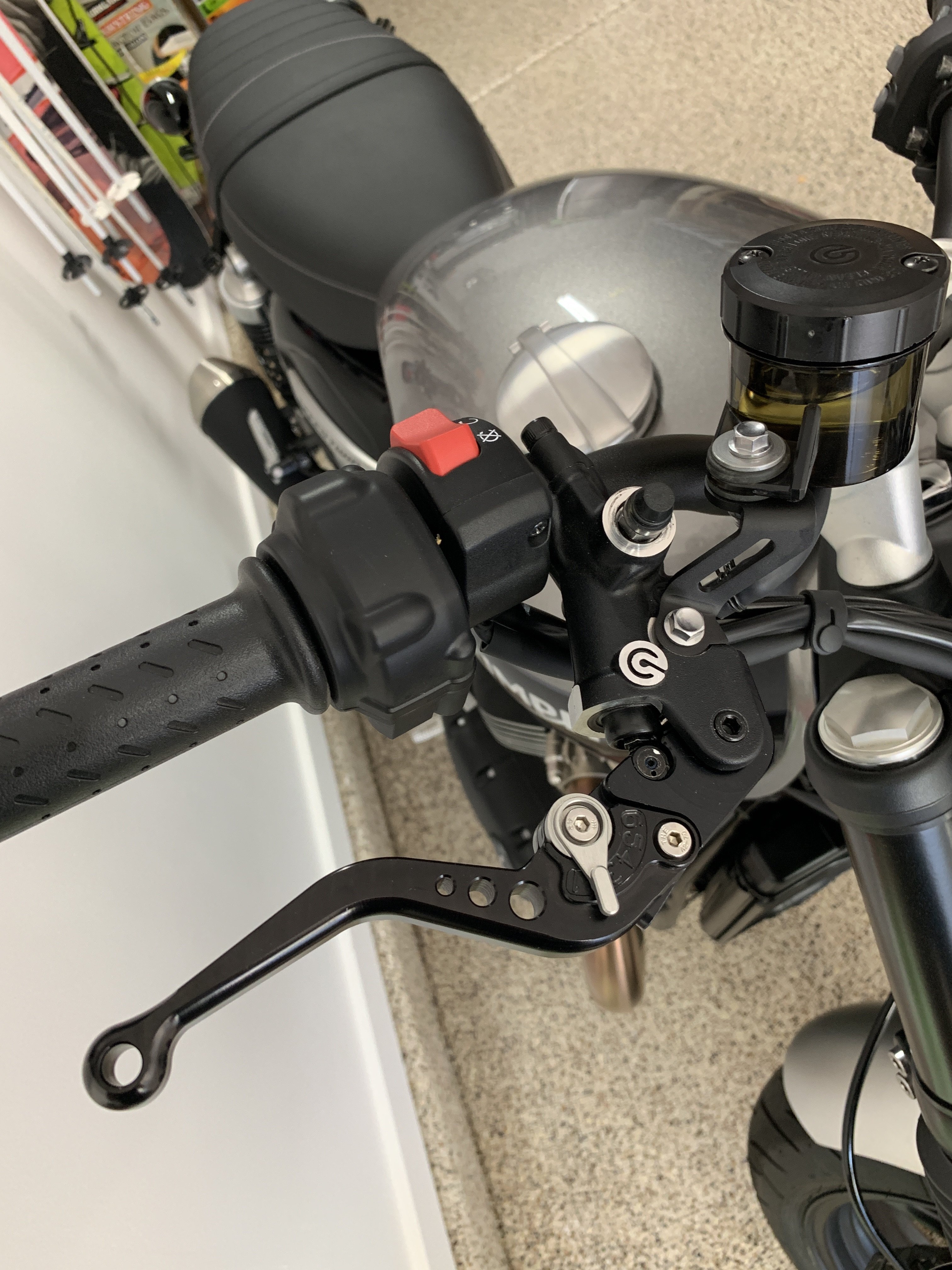

    What did I do wrong? Just replaced the stock levers on my Speed Twin with Pazzo shorty levers. Easy enough job, I’ve done levers on other bikes in the past with no issues. After doing these however, the initial pull of my brake lever feels slightly spongy. If I release and pull again it grabs like it should, but the first pull definitely has more travel than before I swapped them. Also, there is an occasional squeal when pulling the brake lever at low speed. Anyone experience anything like this before? Any help is greatly appreciated!

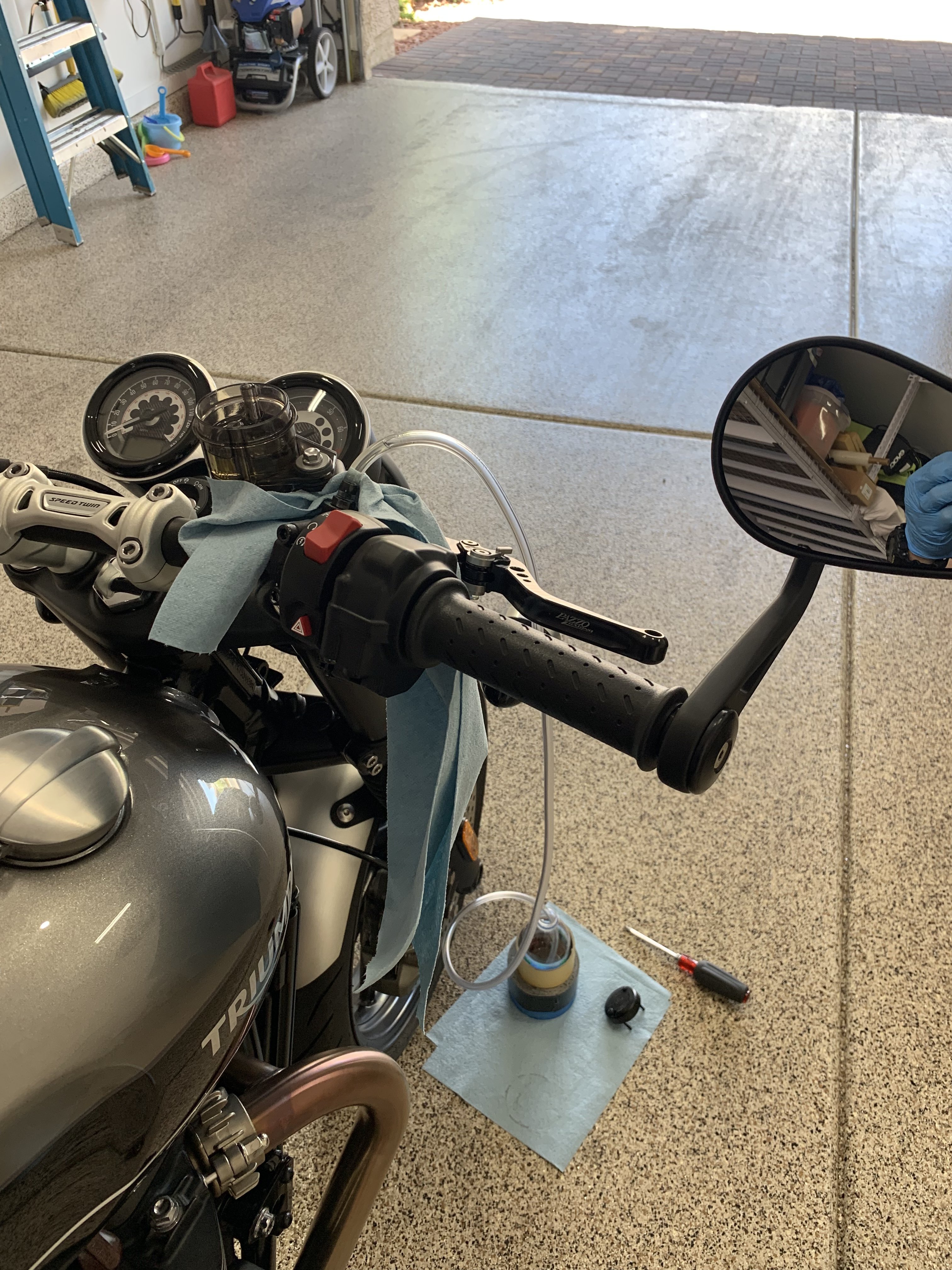

    Welp, brakes are bleed and are now rock solid! It was shocking how much air I got out of the system, wouldn’t have thought it possible. So ended up being a bit more work than just swapping levers, but still very much worth it. Shout out to EuroCycle Las Vegas for the help.

    During...
