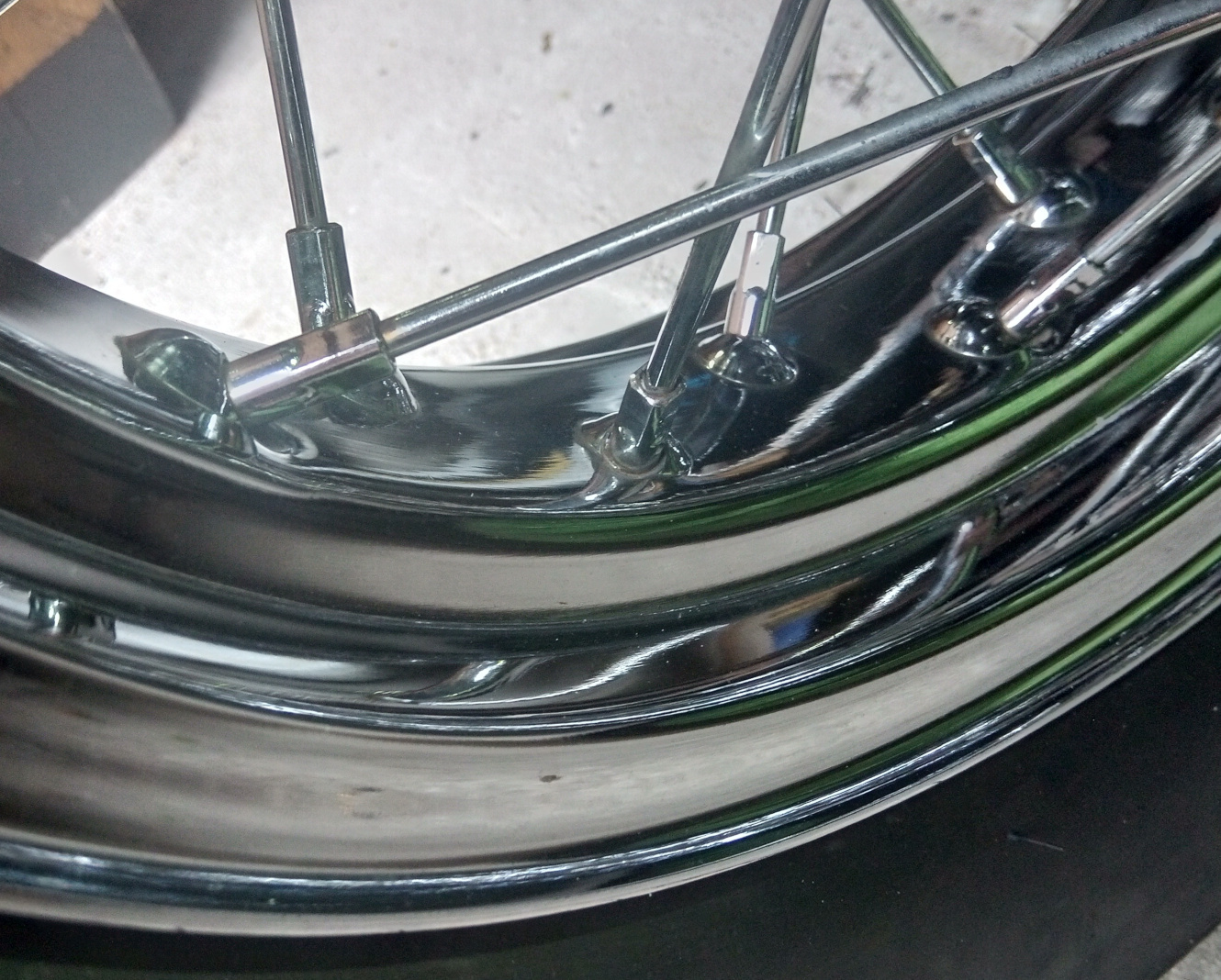

    I'm in a similar situation. I have a Speedmaster (same wheels as Bobber), bike is stored outside in makeshift lean-to, and I ride all year. But I do only ride for pleasure, so don't usually go out if it's raining unless on tour. I do go out in winter though when roads have been salted and county lanes are damp and muddy.
    I haven't treated bike with anything, just hose down, use normal spray-on cleaners and/or shampoo, then rinse and use a bike dryer. Spokes show a little rust where they screw into nipples, and where nipples go into rim; also some spots on the rim I occasionally rub off with aluminium foil. The spokes get a bit grubby and I don't bother cleaning then much, only do it thoroughly every tyre change. Oh, I do give the rim a rub round with a microfibre cloth after most washes, using my finger to get between spokes.
    I've done nearly 30,000 miles and wheels look fine to me, you have to get very close to see any rust.
    Sorry the picture is just with phone and isn't great. It's raining and didn't want to unlock bike and get it out to do a proper photo with DSL camera. But you get the idea that the condition is OK.
