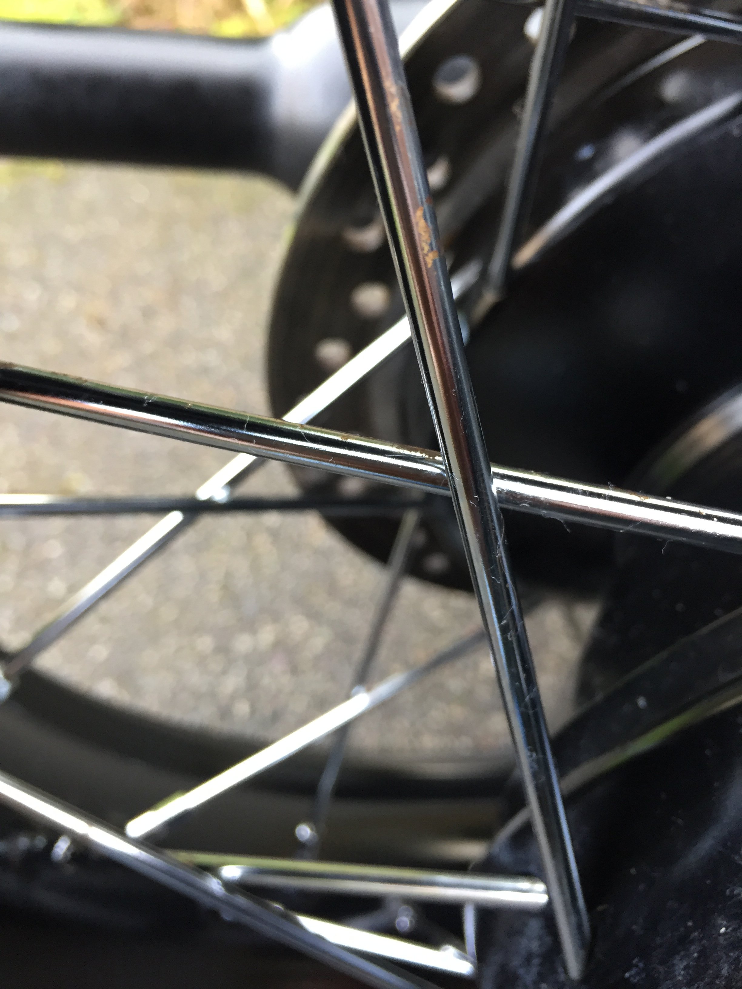

    Was giving it a thorough clean this morning ready for a few months hibernation and noticed that the rear spokes are starting to pit and have rust spots showing through. Front spokes ok and still as shiny as when new. Have notified the dealer but haven't heard back from them as yet.
    Anyone else with this? I accept it will happen with time, but after four months?

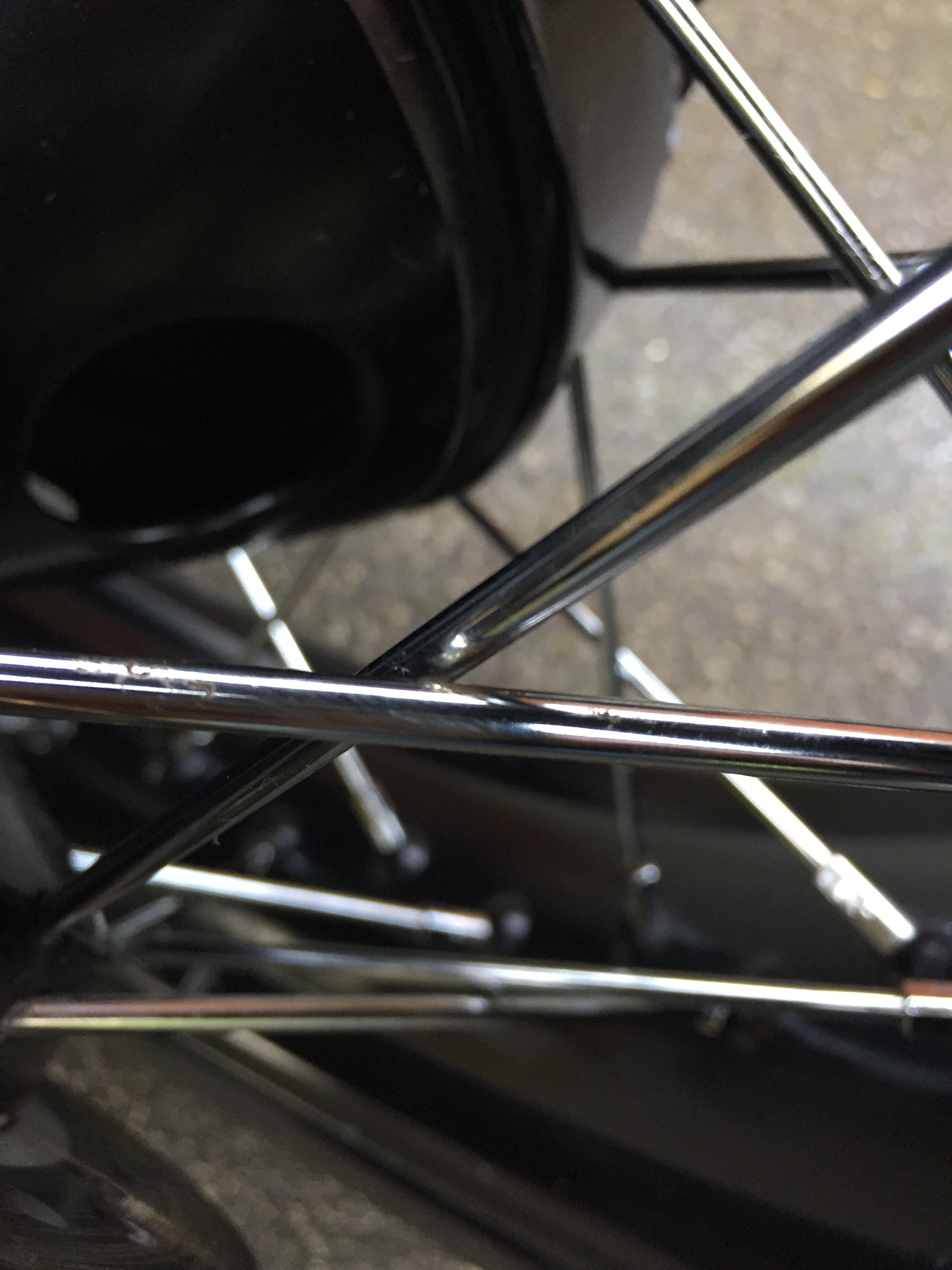

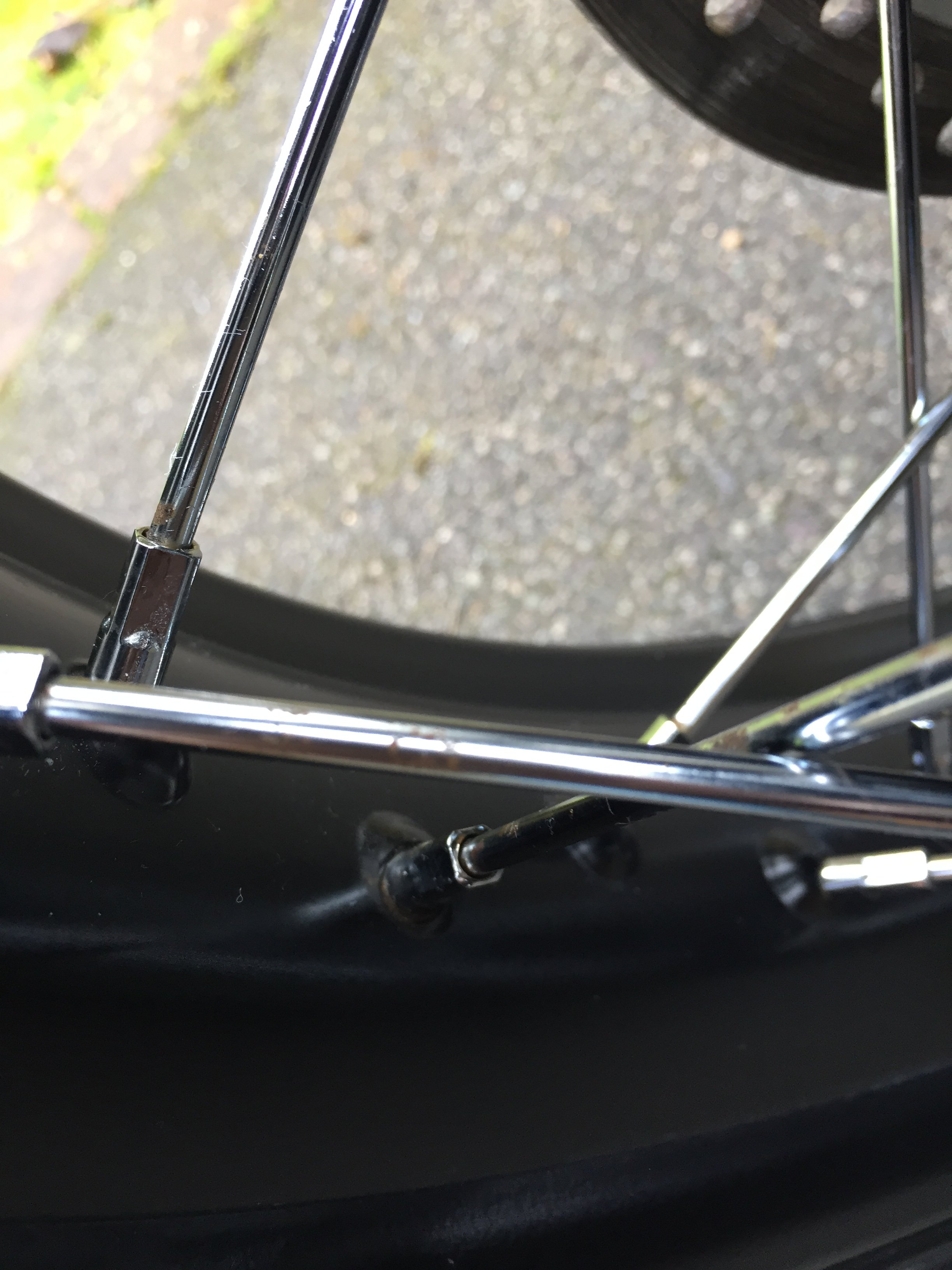

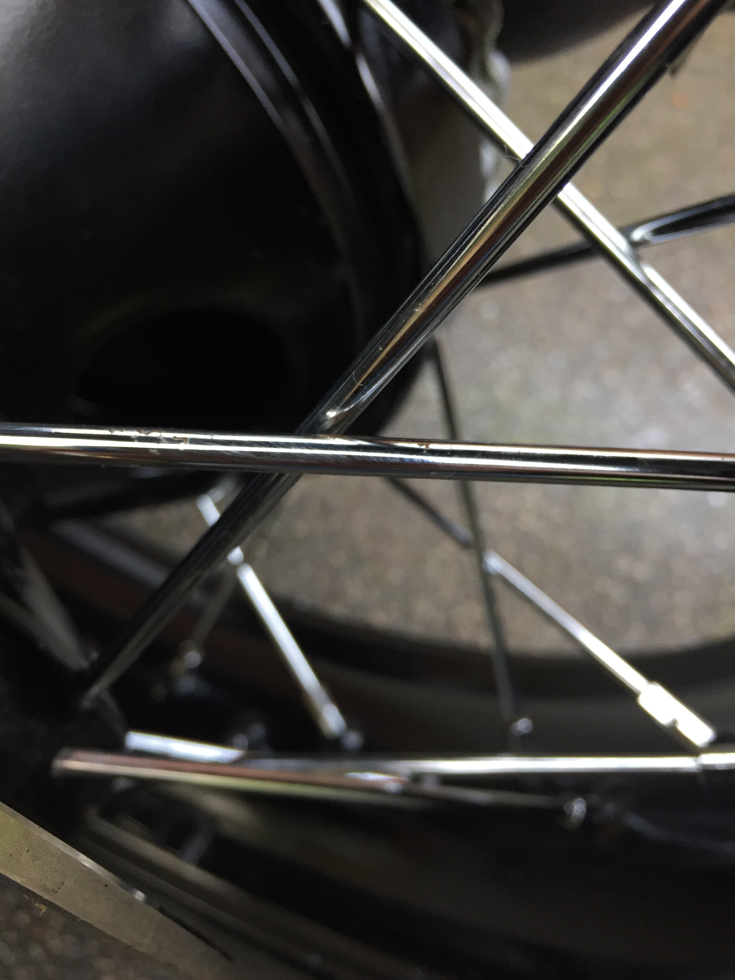

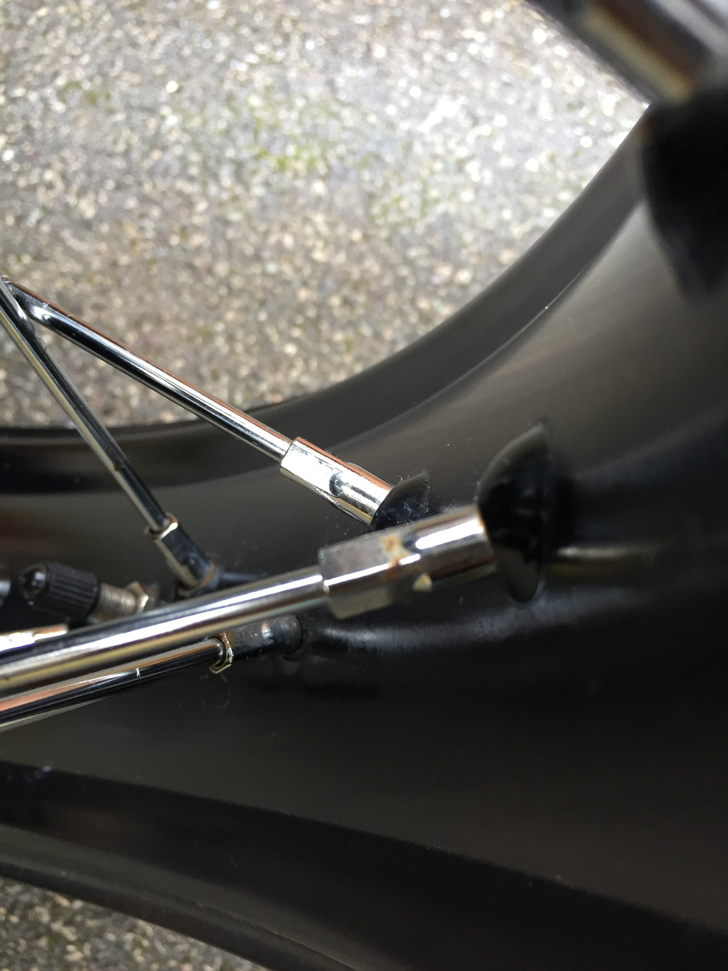

  10. pasher
    pasher Well-Known Member
    Sep 23, 2016
    138
    Nottingham
    (Focussing on an iPhone a bit tricky close up ;-) )

    WOW ! You can see the fibres from the polishing cloth.....
    What are the spokes made of ? I had mine changed to Stainless when I had the wheels powder coated. I owned a Ducati Sport Classic years ago and they started to show rust, made by Excel also..

    Mine are also starting to rust where the nipples contact the rim and where the threaded part of the spoke enters the nipple. Bike was new in late August. Not happy and will be contacting dealer next week. I have never bought a Triumph in the past and very much doubt I'll buy another. My 2009 FJR has done nearly 50k and has no sign of corrosion anywhere.
