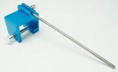

    One other thing, I recommend using the tool below to ensure the chain is properly aligned. Using this is way more accurate compared to using the simple markers on the swing arm. I bought mine for $12 on line. A good investment.

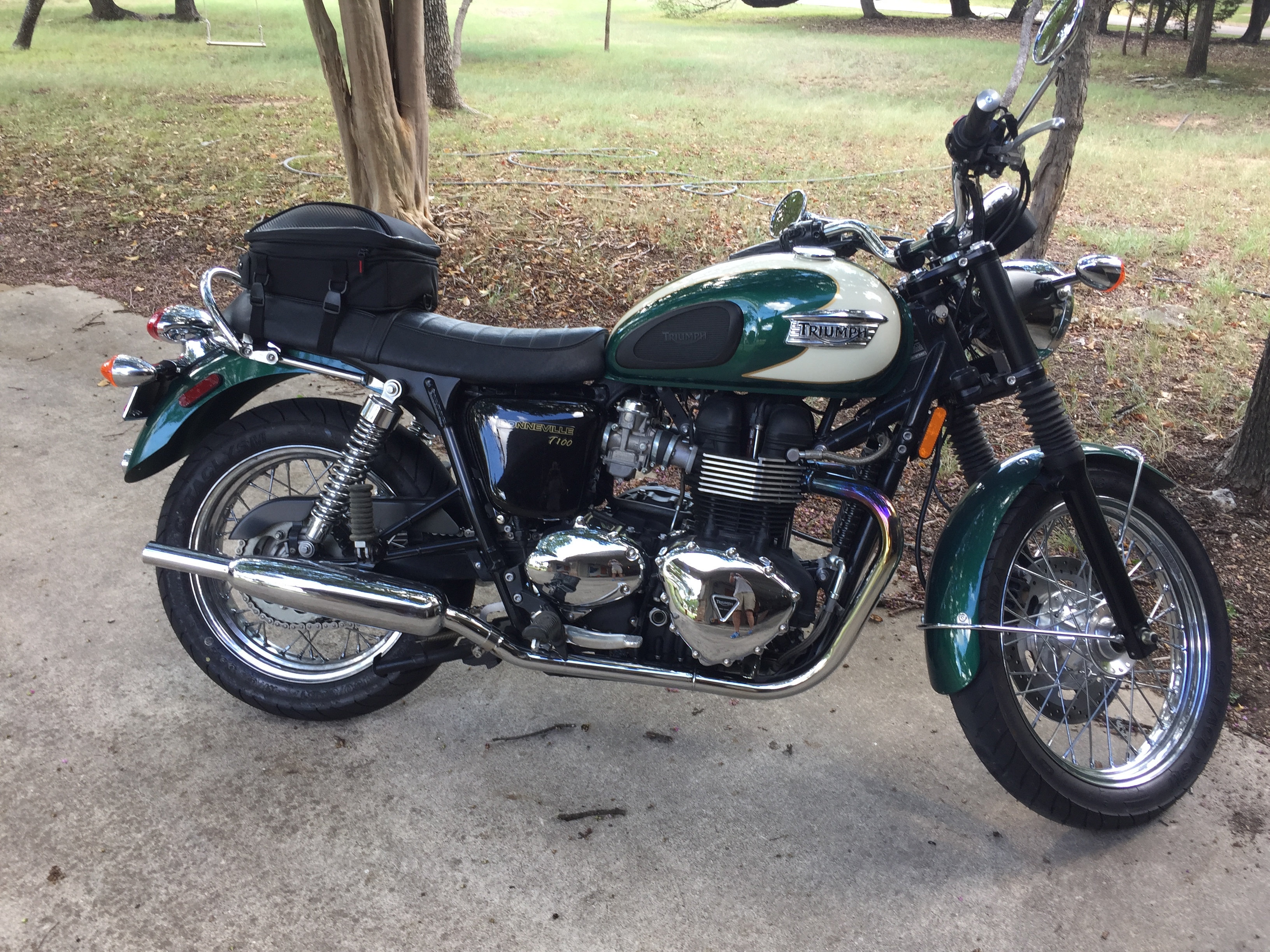

    Attached is a picture of the bike.
    I just installed the seat bag, and trying to decide if I like it.
