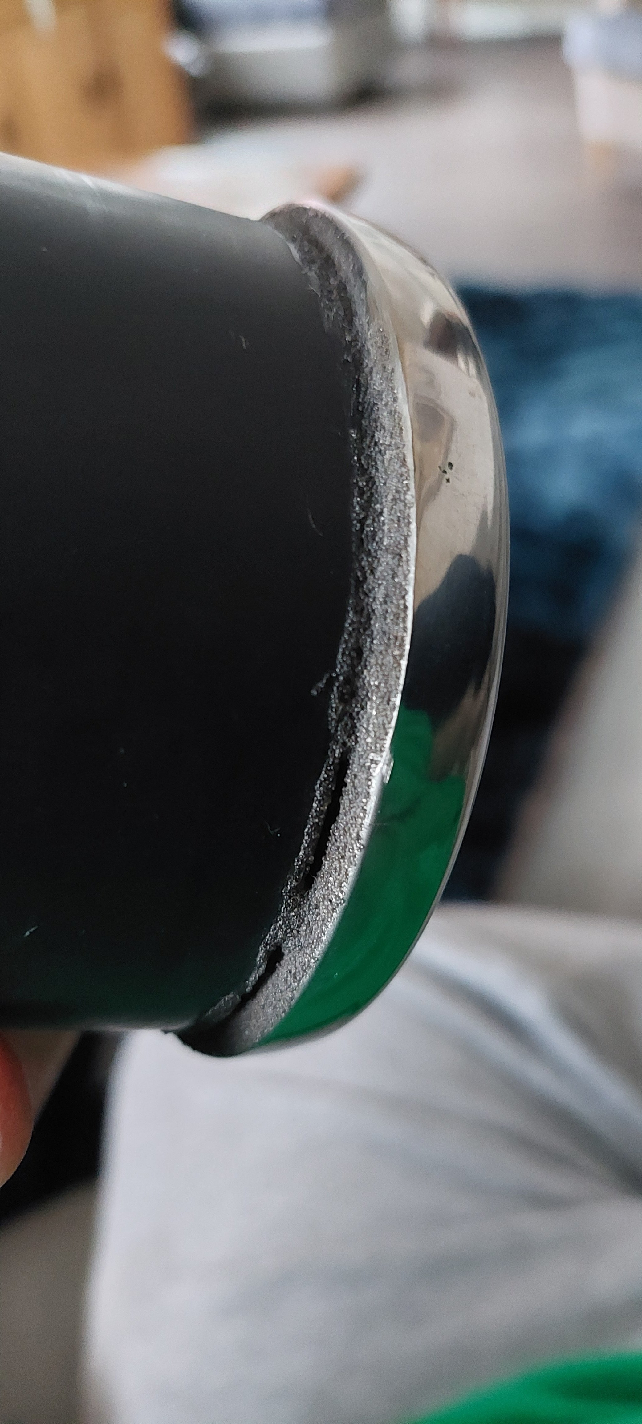

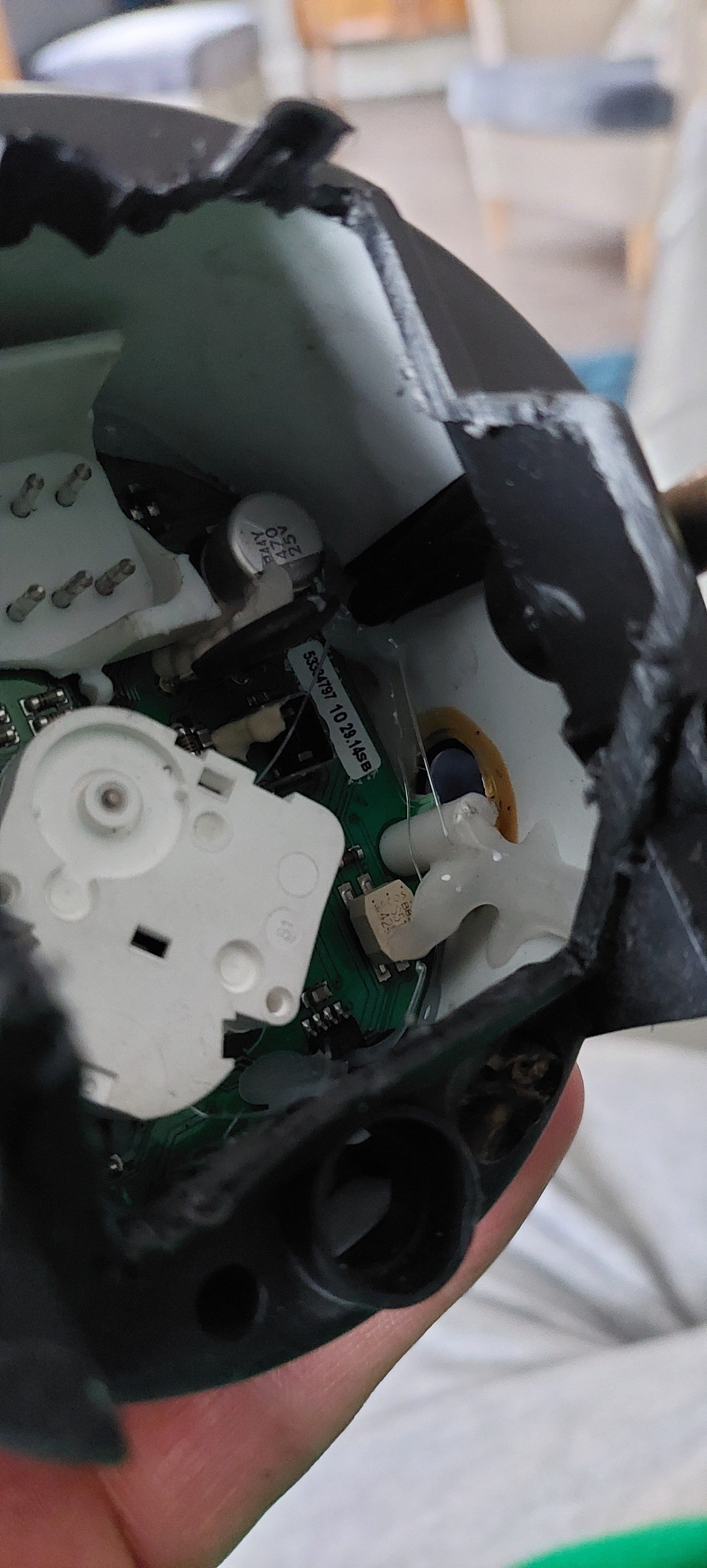

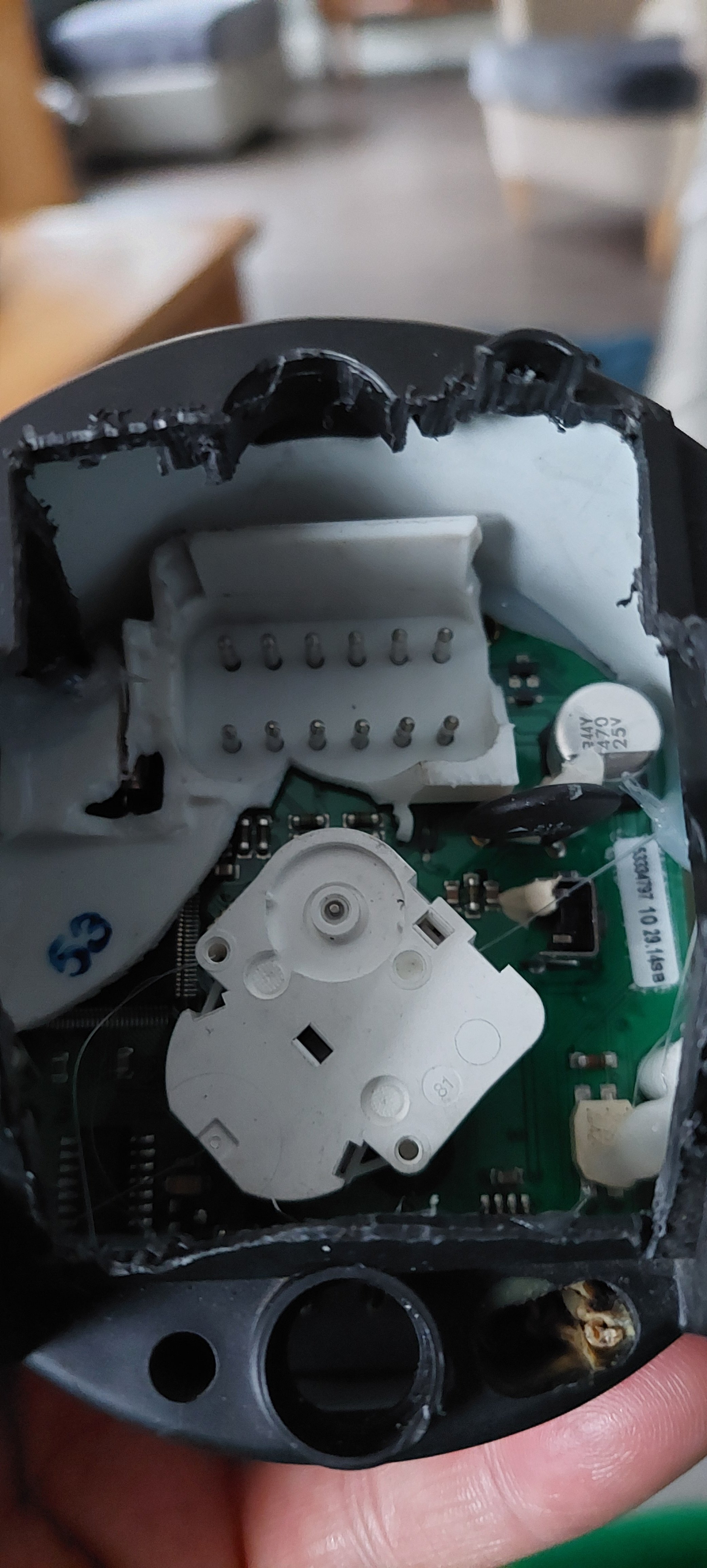

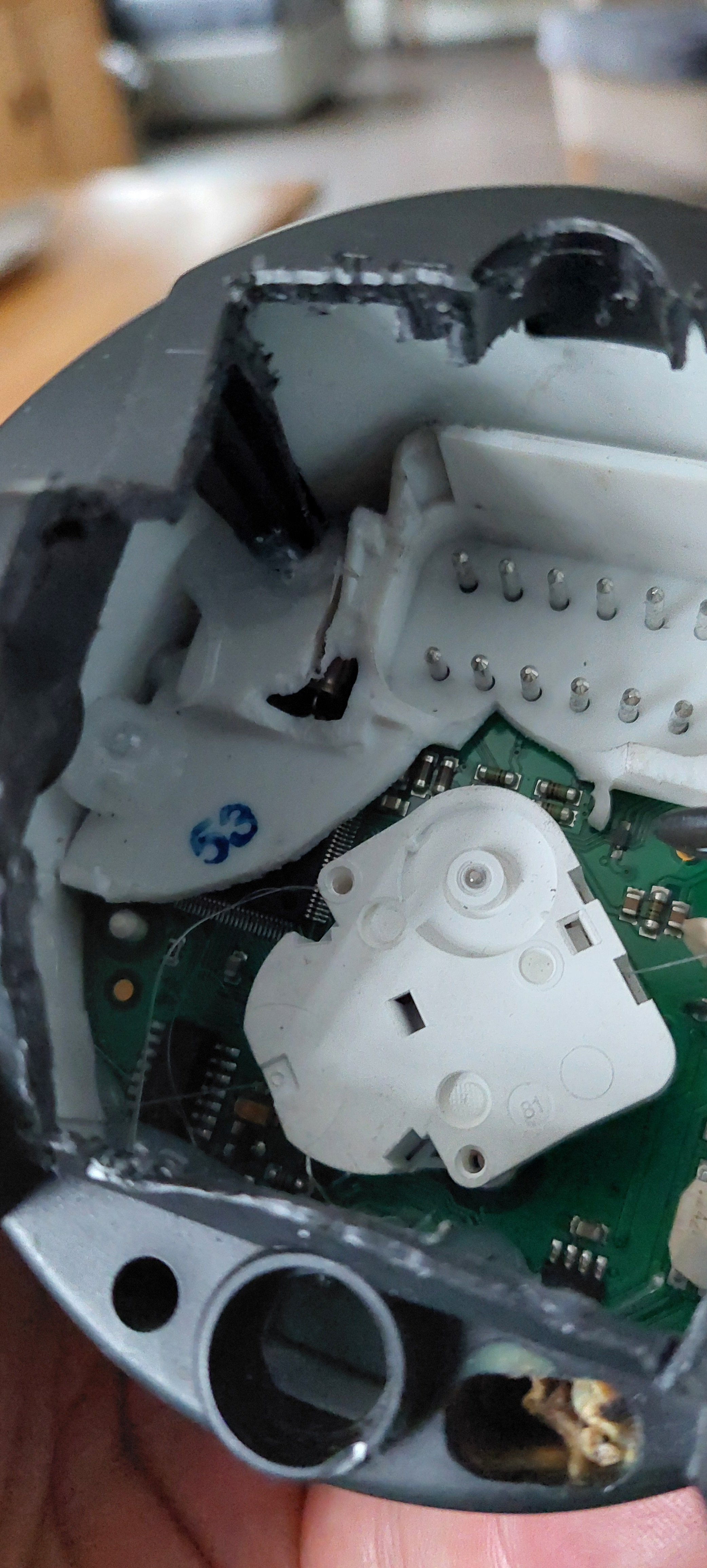

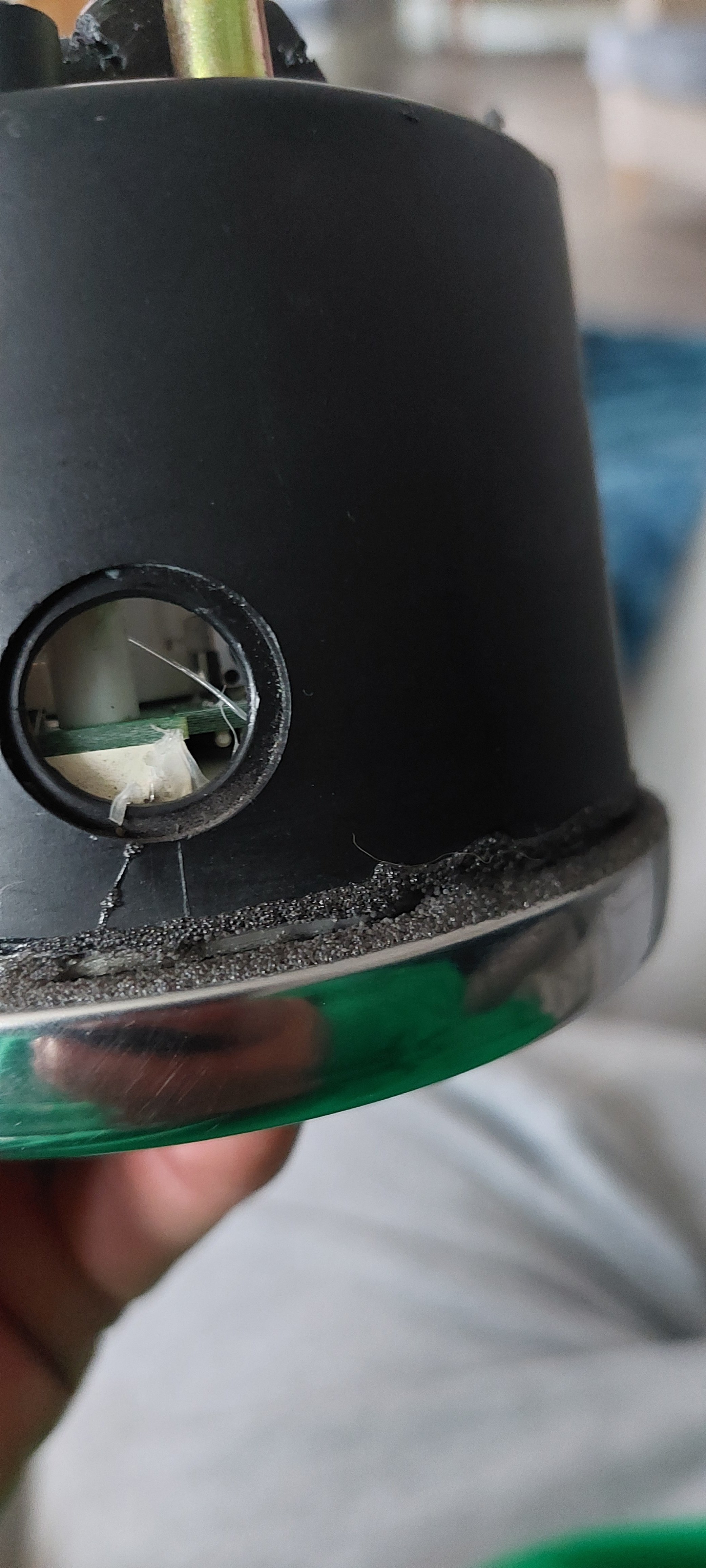

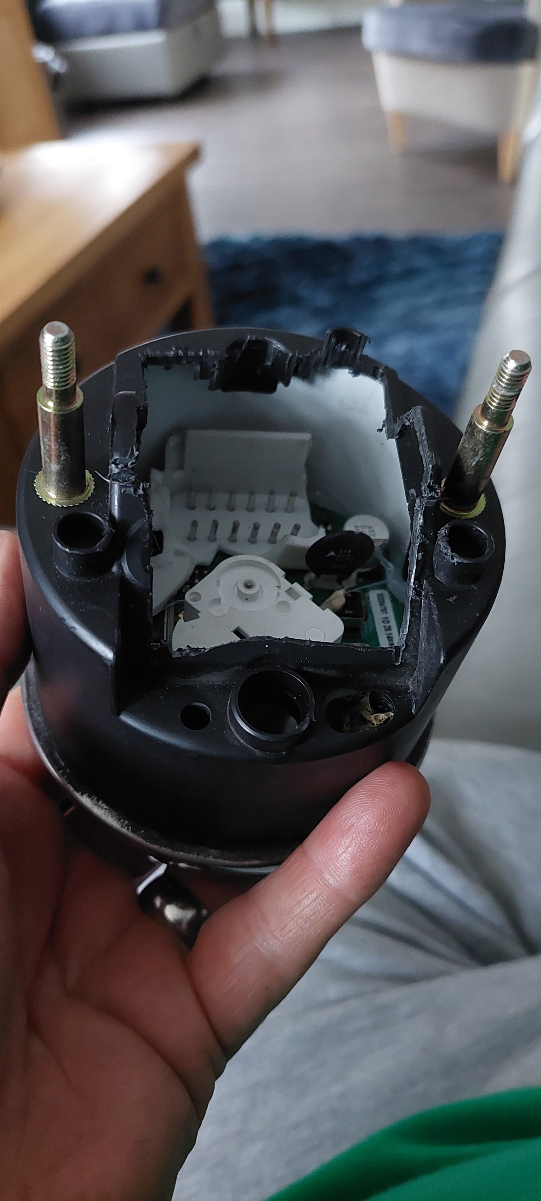

    I've recently purchased a Bonneville Newchurch, the Speedo on it was just a single dial with no accompanying rev counter, it also had what seemed to be a button missing on the side of it, so I decided to remove the speedo to investigate. This is where the Saga began, whoever owned it previously has bodged a concoction of a speedo together (see photos), never have I ever seen such shoddy work.

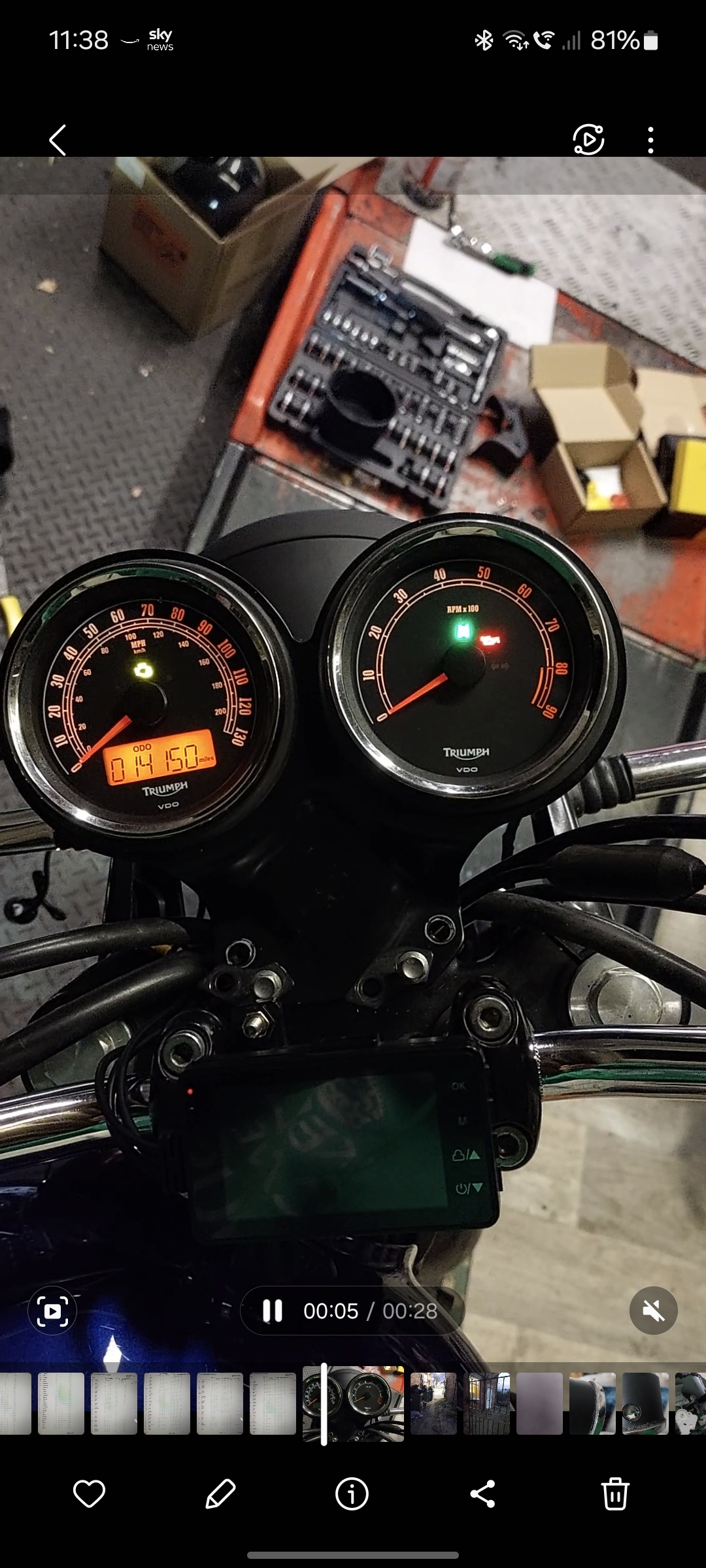

    So, trawled the Internet and found someone not too far away selling a dual clock set (which to be honest I think it should of had in the first place) and have been and purchased and fitted them.
    Now to my issue, my bike has around 8k miles on it, the clock set I've bought has 14k on it, I did think (or at least hope) that the mileage was store on an ecu on the bike not on the dials itself, however it's now showing at the 14k plus mileage.
    Is this something that can be rectified via a plug in ready etc? Maybe the dial needs registering to the ecu?

  2. Samsgrandad
    Samsgrandad Senior Member
    Dec 15, 2019
    715
    Somerset
    The base model Newchurch was fitted with a single speedo but the SE version had a speedo and tachometer. The dual dial set up was originally available as an option but now they are only available secondhand and are like hens teeth!
    As far as the mileage is concerned I doubt whether the difference you are talking about is going to make much difference especially if you photo the old speedo and record the mileage of both the new and old ones. You will then have a record of the discrepancy should anyone query it in future you have evidence to back up your story. I would be much more concerned if the mileage on the new speedo was much lower than the old one!
    In answer to your question I don't know of any way to 'wind back' your new speedo to match the old one.

    Thankyou for the answer, I'm not too bothered about the mileage as like you say if I have proof it shouldn't make a difference.
    Just wondered if these bikes had the mileage stored in and ecu kinda thing, I have seen this on cars for instance a land-rover discovery I owned.
