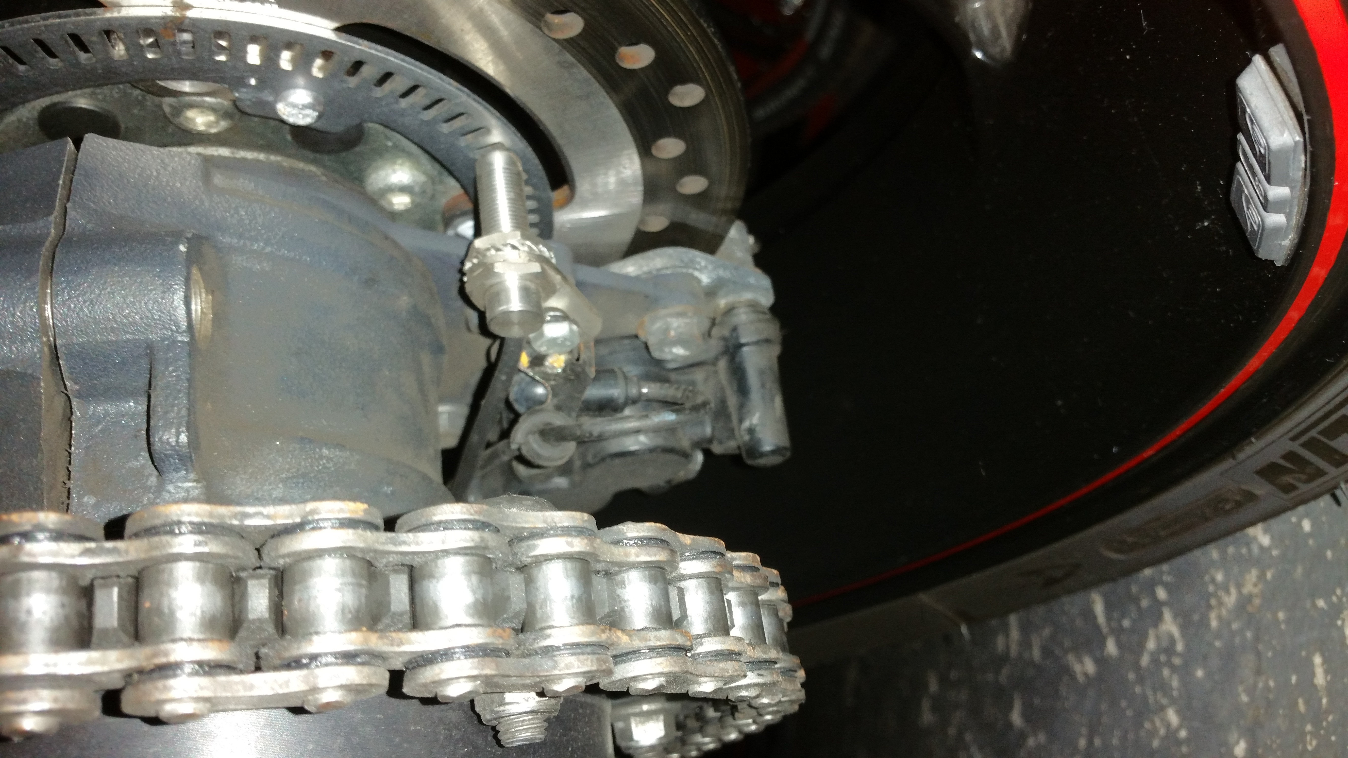

    Sack that... it runs off a transmission output shaft sensor. Getting all muddled, was on my duke 1098s... have put my own on this for my gear indicator running from the abs ring which is what threw me!
