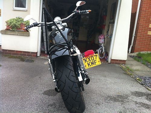

    Example of my America's chopped back end
