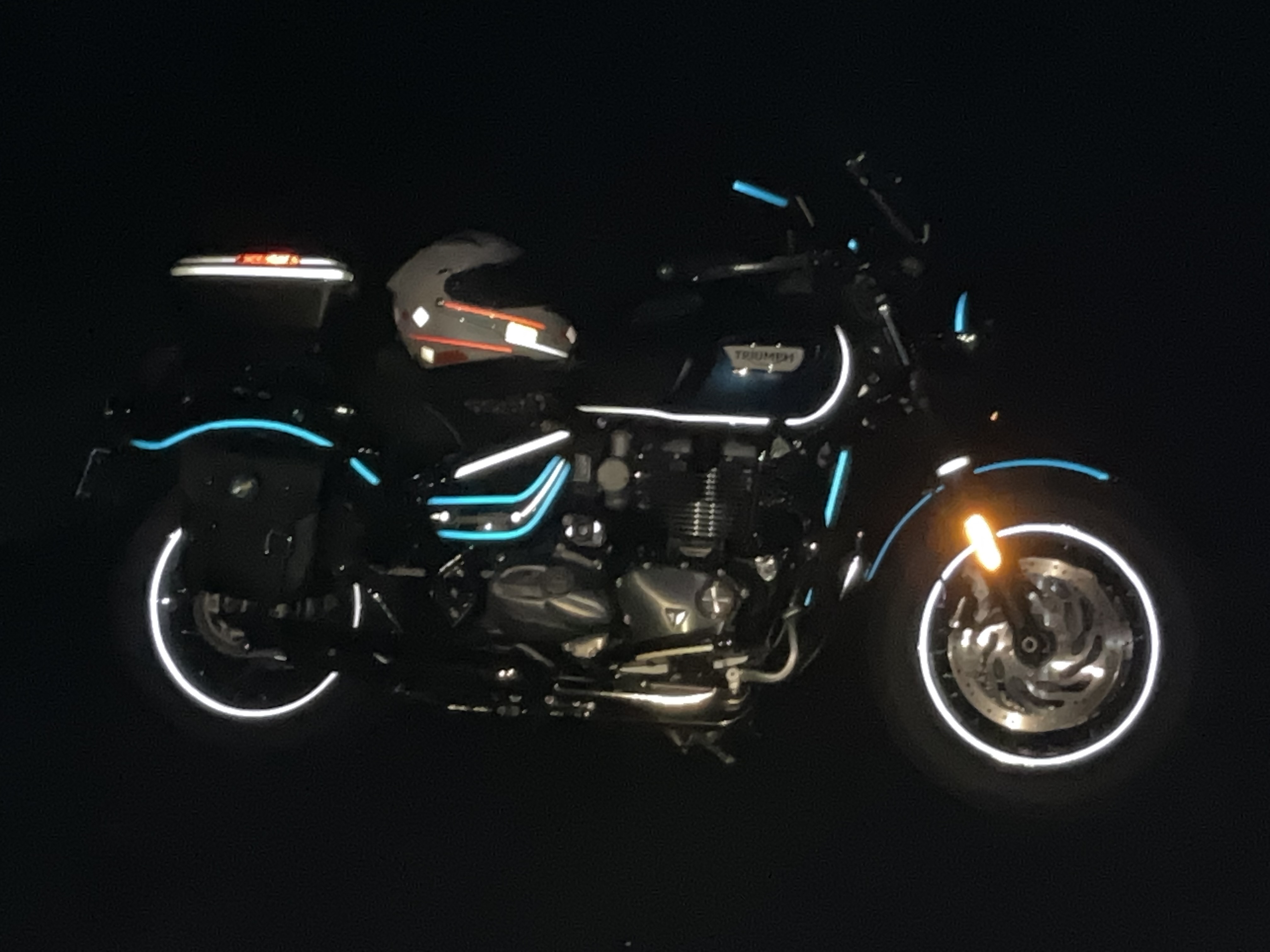

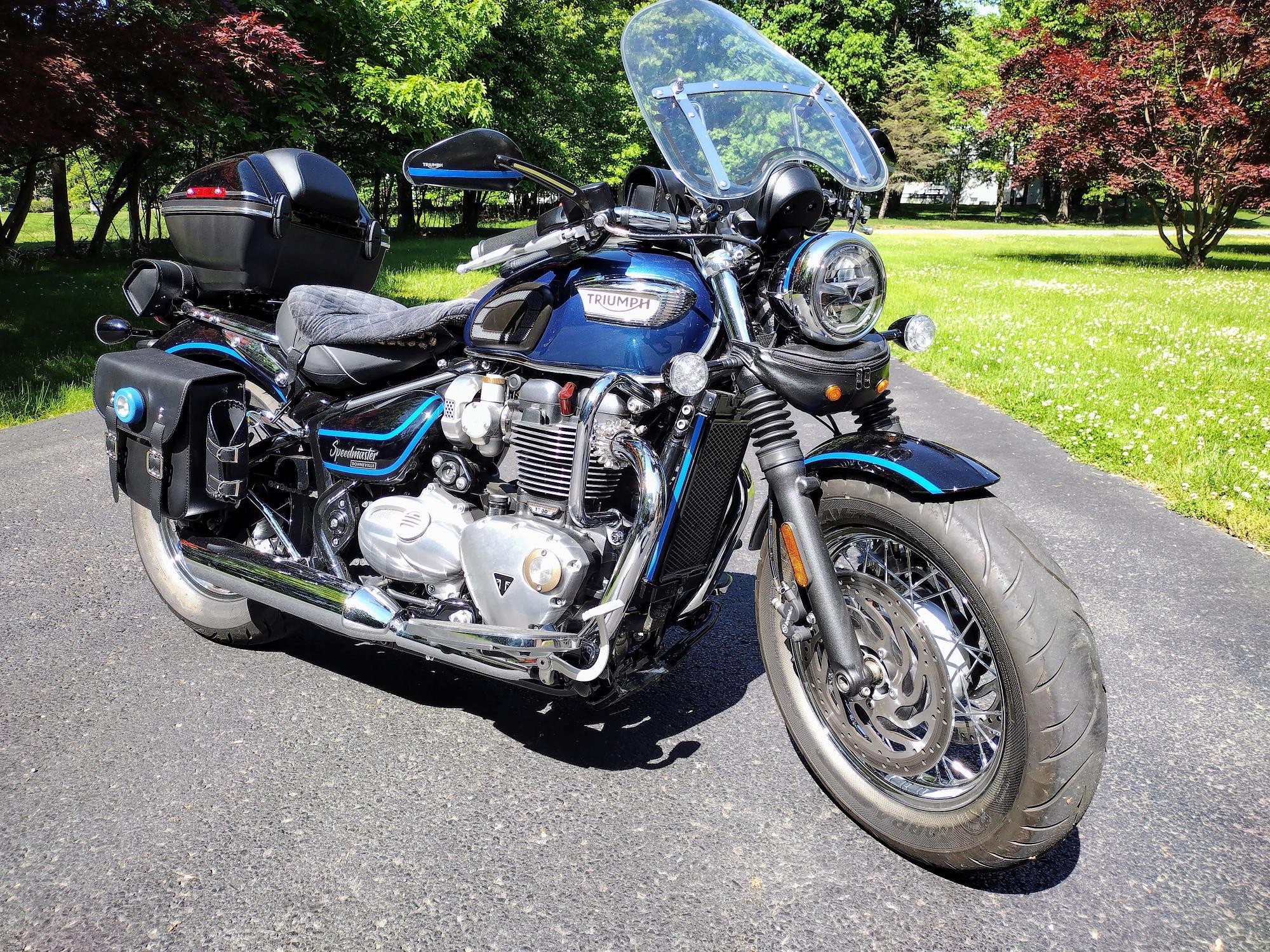

    @Dr. Mark Bohn Welcome to the family. Can't help but i am sure someone will be along soon. Do tap the upload a file button and show us all the bike

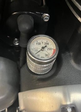

    I installed this oil temp gage that replaces the original oil cap when I first got her. I have never seen it go above 150 degrees F. Not all that hot. You might want to consider investing in one of these. You can monitor the temp and note if any particular condition results in a spike in temp (idling for long periods, flogging her hard in summer heat, taking on steep hills, etc.). As for the coolant. I've never changed it. It's a closed system and I see no need to. Maybe when I hit 10k miles I'll look into a drain, flush and refill.
