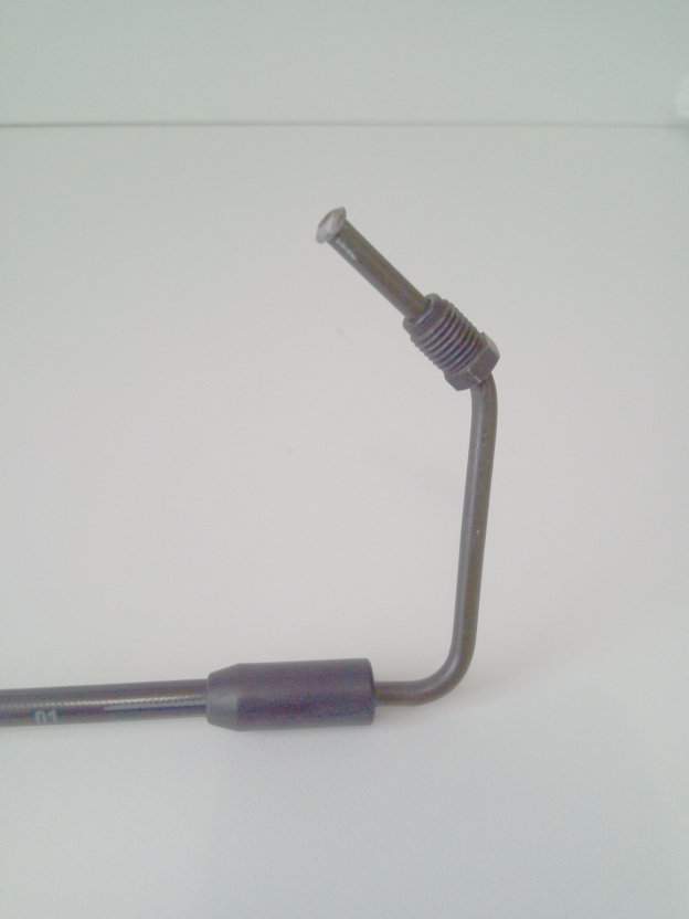

    I'm trying to work out how to get a brake line somewhere in length between original and the short one. I can't just use the original one and live with the slack, because the banjo fitting is straight and is also in the wrong plane, which prevents even just bending the line sharply. Also, just getting a custom line is a bit tricky, because the end that goes under tank looks like this...
    I'm wondering if anywhere and take an existing line and stick a banjo fitting on it?
