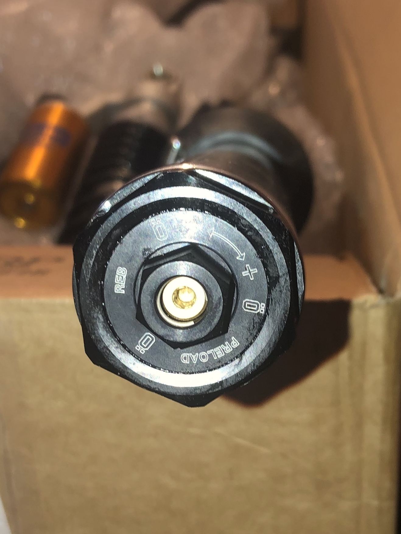

    9AE48EC1-9C51-4B7D-A0CD-22AF6AB86AEC.jpeg They’re NIX 30’s , not sure if that’s the same with a different name.
    I went for the hardest springs they do as I’m no lightweight and I like to feel the road.
    I removed the forks and k tech rebuilt on the bench
