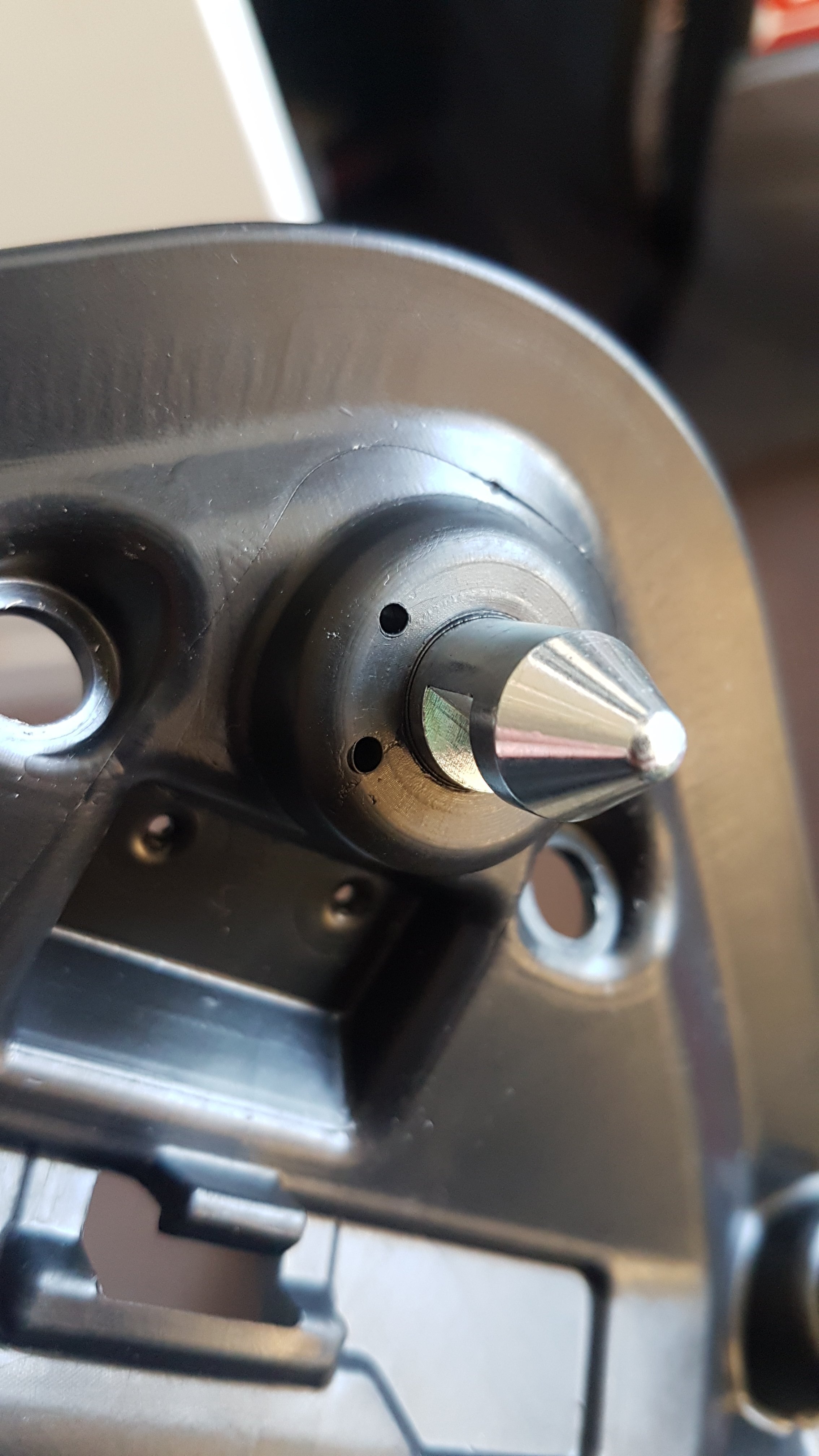

    Hi all, first time on here but I have some info relating to this thread.
    picked up a seat cowl for my Speed 1050R.(2016)
    I removed the passenger seat and fitted the cowl but could not get it to provide the reassuring click when locating the cowl, if i grabbed it with force it came off when the latch was supposedly locked.
    I looked at the catch on the frame where the lug locates and noticed the location of the moving catch was on the right side of the bike, the lug on the cowl did not match as the slot for the locating pin on the underneath of the cowl was approx 90 degrees out.
    I believe that when they mold the lug onto the seat cowl framework, if they have not positioned it correctly the locating slot on the pin wont line up with the catch mechanism on the frame.
    I used a pair of pliers to carefully rotate the lug on the base of the cowl to match the location of the catch plate on the frame.
    It now clicks in perfectly and i am not in fear of it flying off.
    Spoke to Triumph dealer about this possible cause of these fitment failures and they seemed disinterested at best. 20200121_142422[1].jpg
