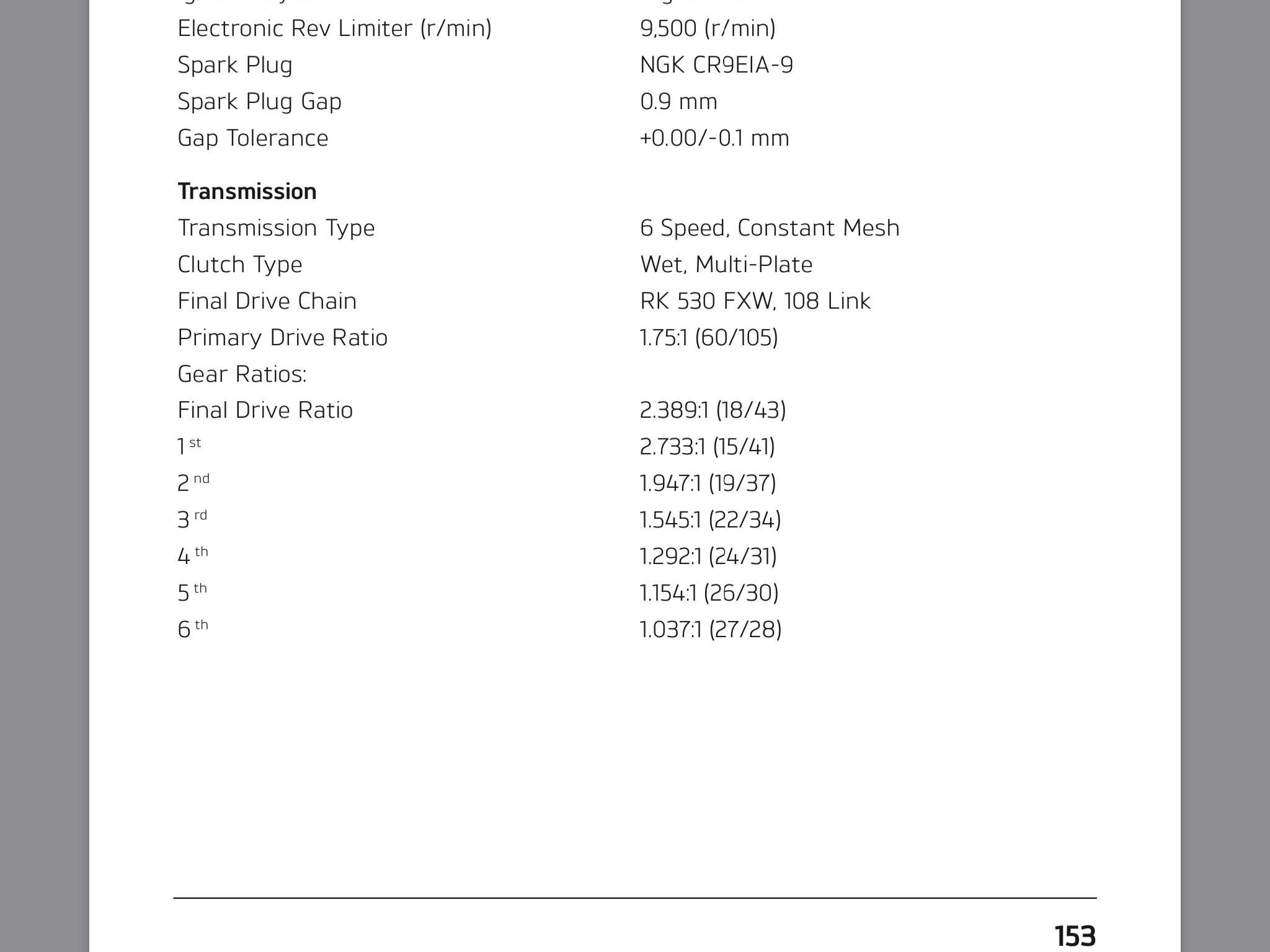

    Hello,
    I am working on a little project with HM Quickshifters to get the latest and greatest available for the Speed RS.
    The information that I am really struggling to find is the gear ratios for the bike, does anyone on here have, is able to obtain or can point me in the right direction for this?
    I need the ratios to work out wheel speed vs engine speed in each gear in order to set up the shifter for optimum operation.
    Many thanks!!
    Burny.

  3. Burny_13
    Burny_13 Active Member
    Jun 16, 2019
    67
    Reading
    Thanks gents, I have found it in the manual now too!
  4. RSReggie
    RSReggie Active Member
    Apr 9, 2019
    114
    North West UK
    I don't think the Speed triple RS has 18 tooth front sprocket I think its actually 17
    You can check on the parts diagrams for the bike ....
  5. White-Vador
    White-Vador Well-Known Member
    Apr 11, 2019
    77
    South of France
    17/44 ;)

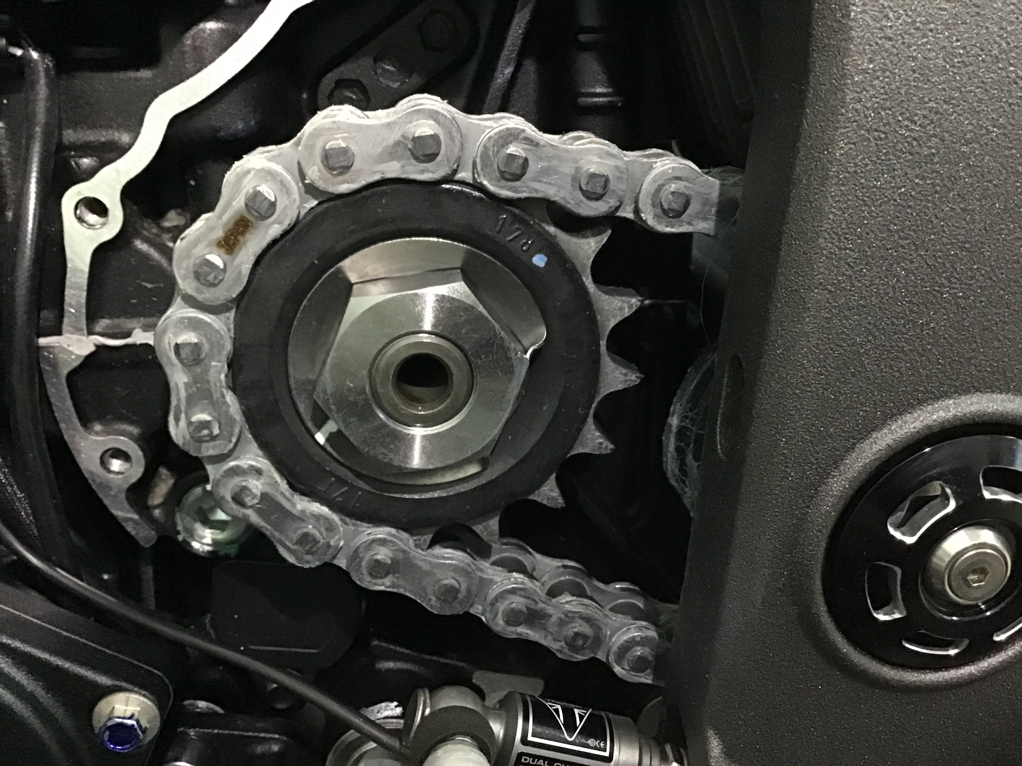

  6. SteveRS
    SteveRS First Class Member
    Jan 12, 2019
    862
    British Columbia
    Thanks for pointing that out, I didn’t even notice it. Yes it’s definitely a 17/44. I took a photo of it earlier this year when I had the cover off.
