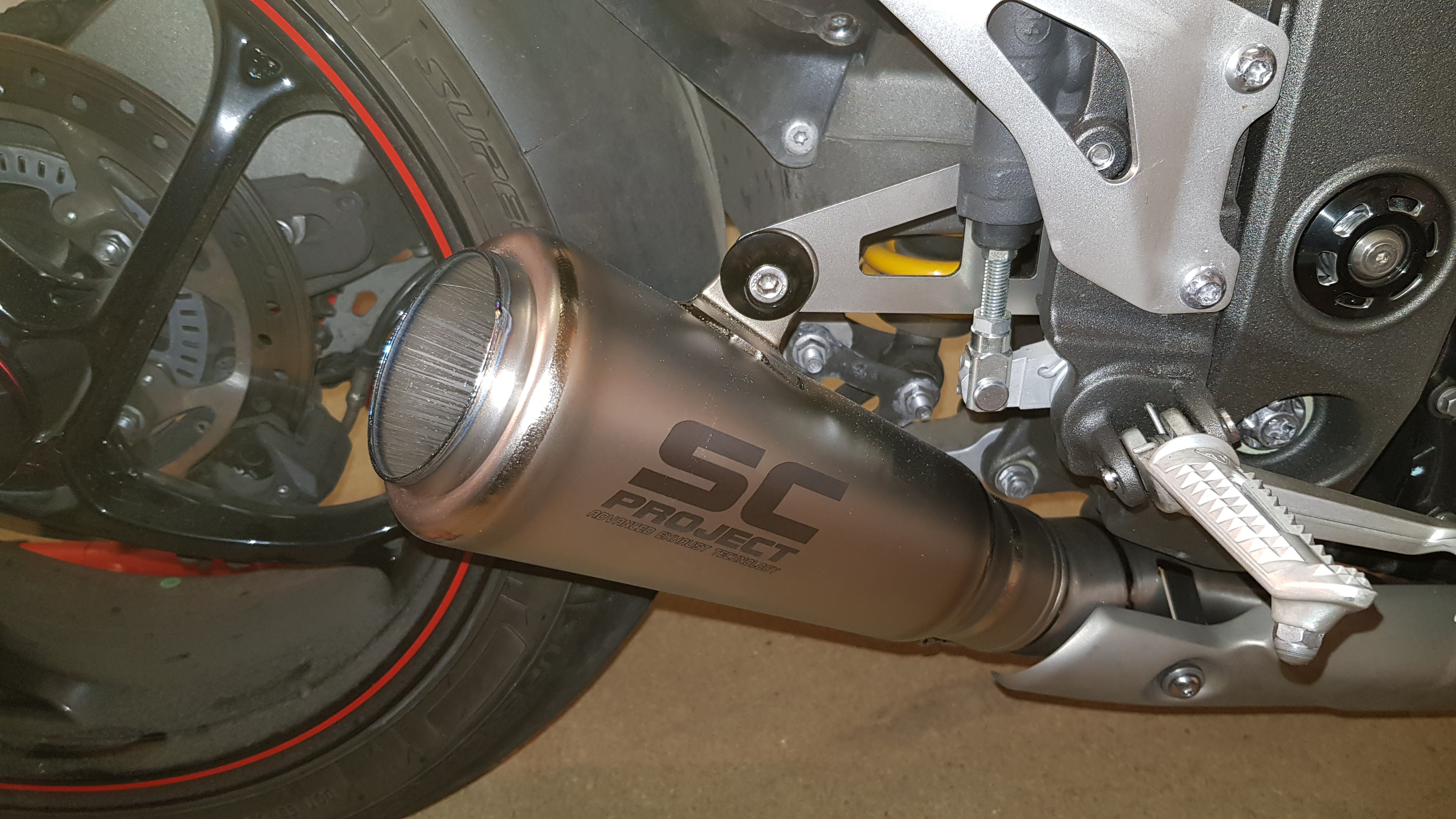

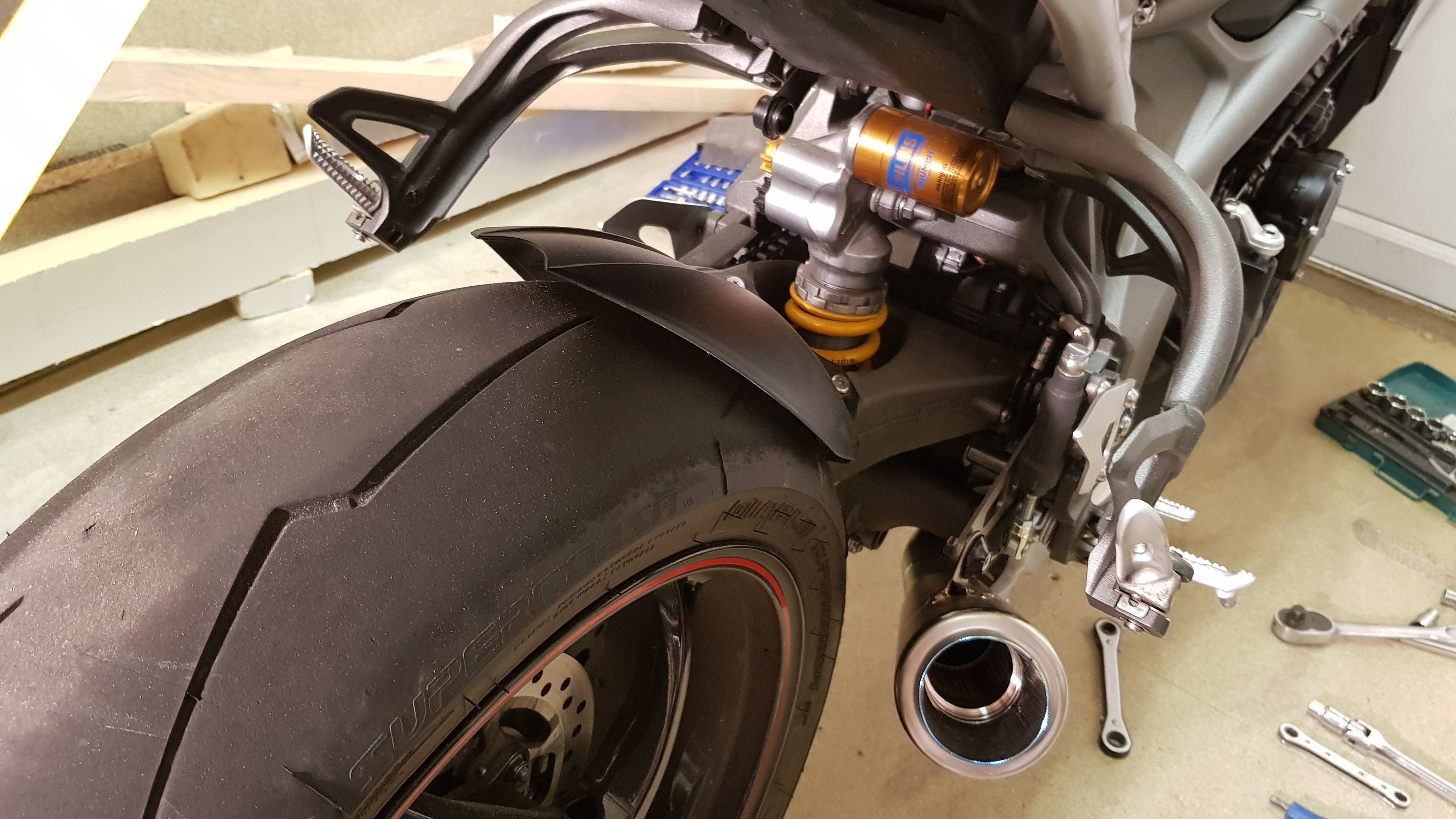

    Great bike choice, I definitely wouldn't be without the quickshifter it's transformed the way you ride it in my opinion. An Evotech tail tidy makes the bike look very clean. I added a triumph flyscreen easy fit and looks good and does make a difference when going quick. Heated grips fitted by triumph is a very nice setup and just added an SC project S1 GP titanium exhaust which makes the bike look superb and saves a load of weight.

    Didn't decat, I did on my fireblade but it's not as simple on a triumph. 103db with the baffle in and very loud out. Just had my first year service at triumph and they said the the fueling etc was good so no remap or anything needed. Filtering became a lot easier. The sc can weighs 2kg so you save I think it's 16kg

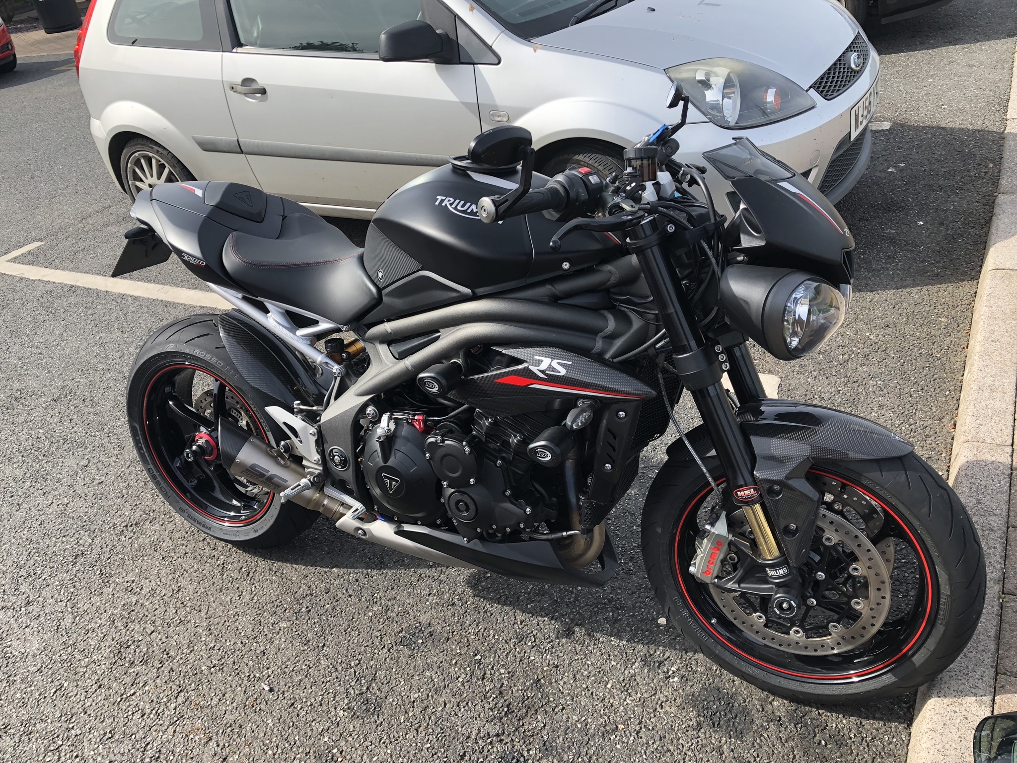

    Looks absolutely stunning mate, how much in total did that cost you, if you dont mind me asking? Also, i couldnt get a picture from the side with the whole bike in please

    500 quid delivered, I ordered on a satui found when changing to a bike with the electronics it's definitely different. You can ride it a lot harder than a 1000 without. I find I ride it like a 600,the electronics sort things out. I was riding it in the Isle of man last month and it was brilliant, so have fun.

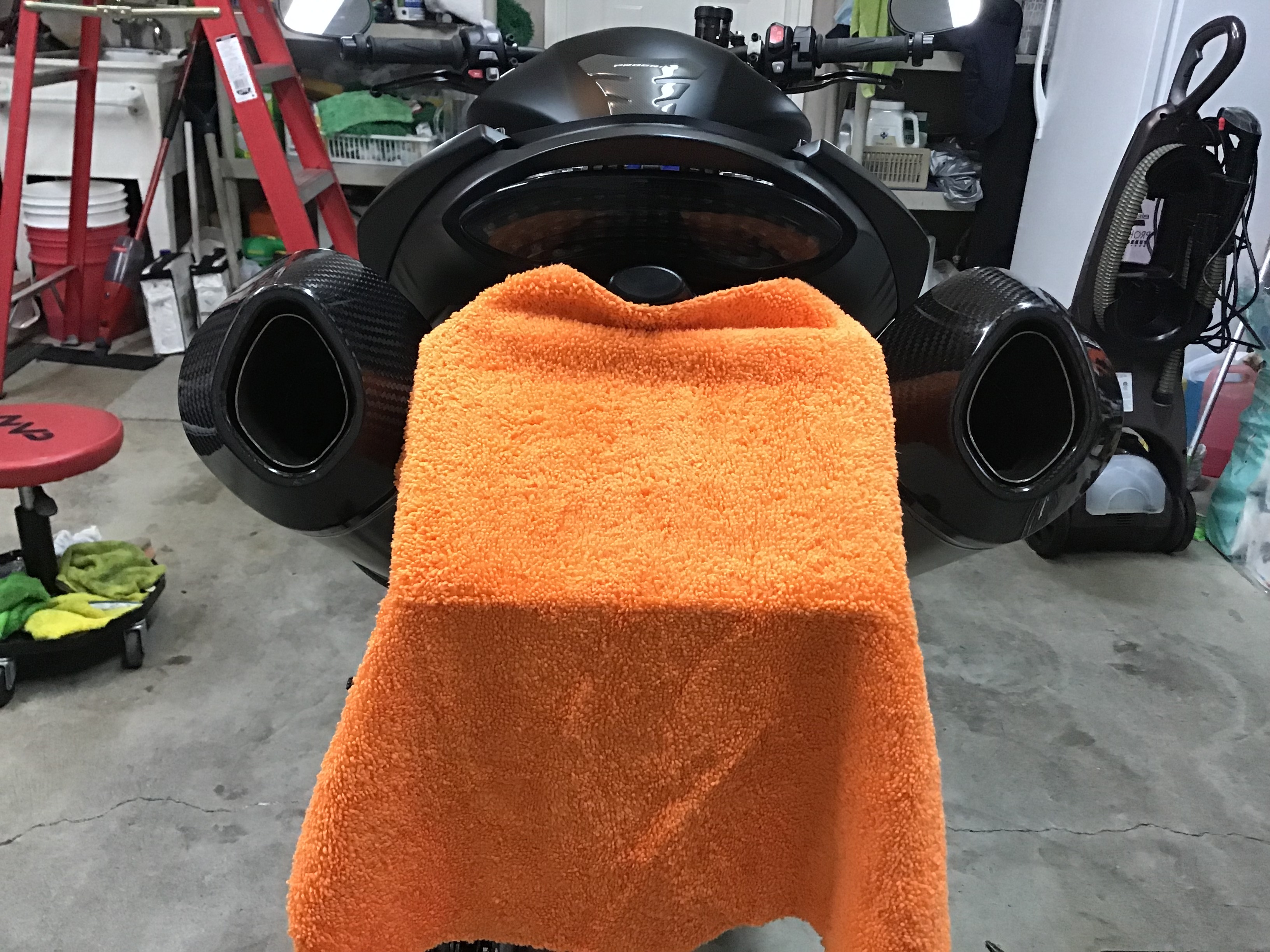

    Welcome! Cut the baffle out, it transforms the bike. Have a look at my mods thread, I don’t regret any of the mods. They’re all must haves imo. The only regret I have is that I didn’t cut the baffle out sooner. Leave the discs in though, as it’s loud enough that way. You can always cut them out if you want your ears to bleed.

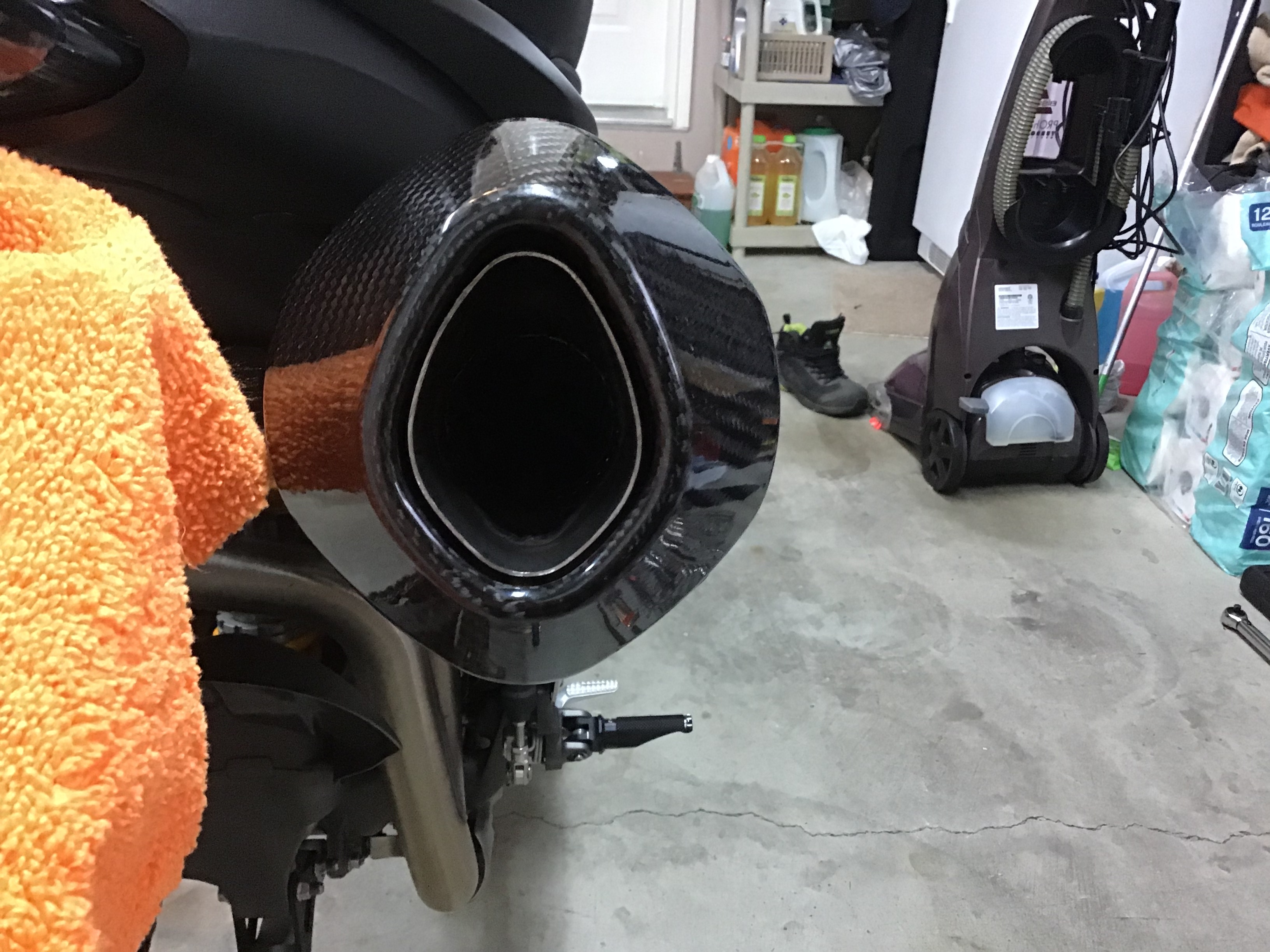

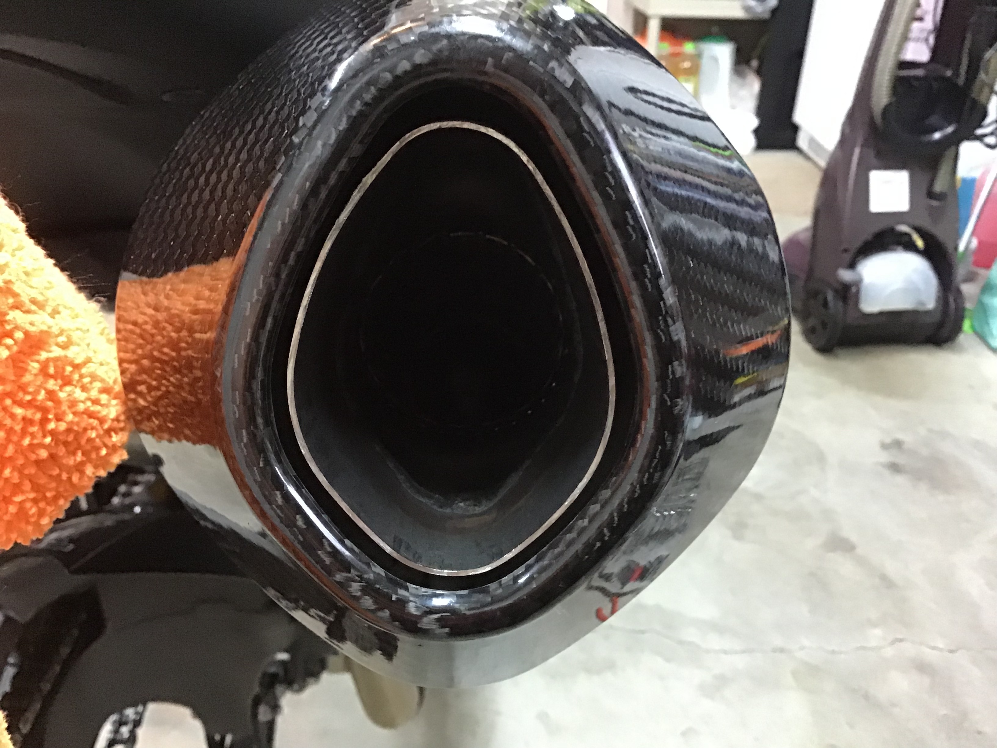

    You can’t just unscrew them, they have been welded in. There is a huge thread on this site showing how to remove them, but I did it a little differently without removing the carbon end caps. I used a dremel with one inch cutting discs (about 12 discs) and cut off about 1/8 of an inch of the end of the pipe. To ensure there was no damage to the carbon end cap, I slid a pice of tin between the pipe and the carbon where I was cutting and moved it along as I continued around the pipe. I hope that makes sense. This makes the job very easy and takes about an hour to complete.

    Here are a few photos, best I can do sorry:confused:.

    Looks good bud put my deposit down yesterday, so waiting for the bike to be delivered this month now :D managed to get the dealer to put the shift assist, fly screen, heated grips, colour coordinated seat cowl and carbon tank infill on her for free.. so thats a bonus :p Can you send a picture before it was taken out please Steve? I dont know what im working with untill i get the bike see. Cheers
