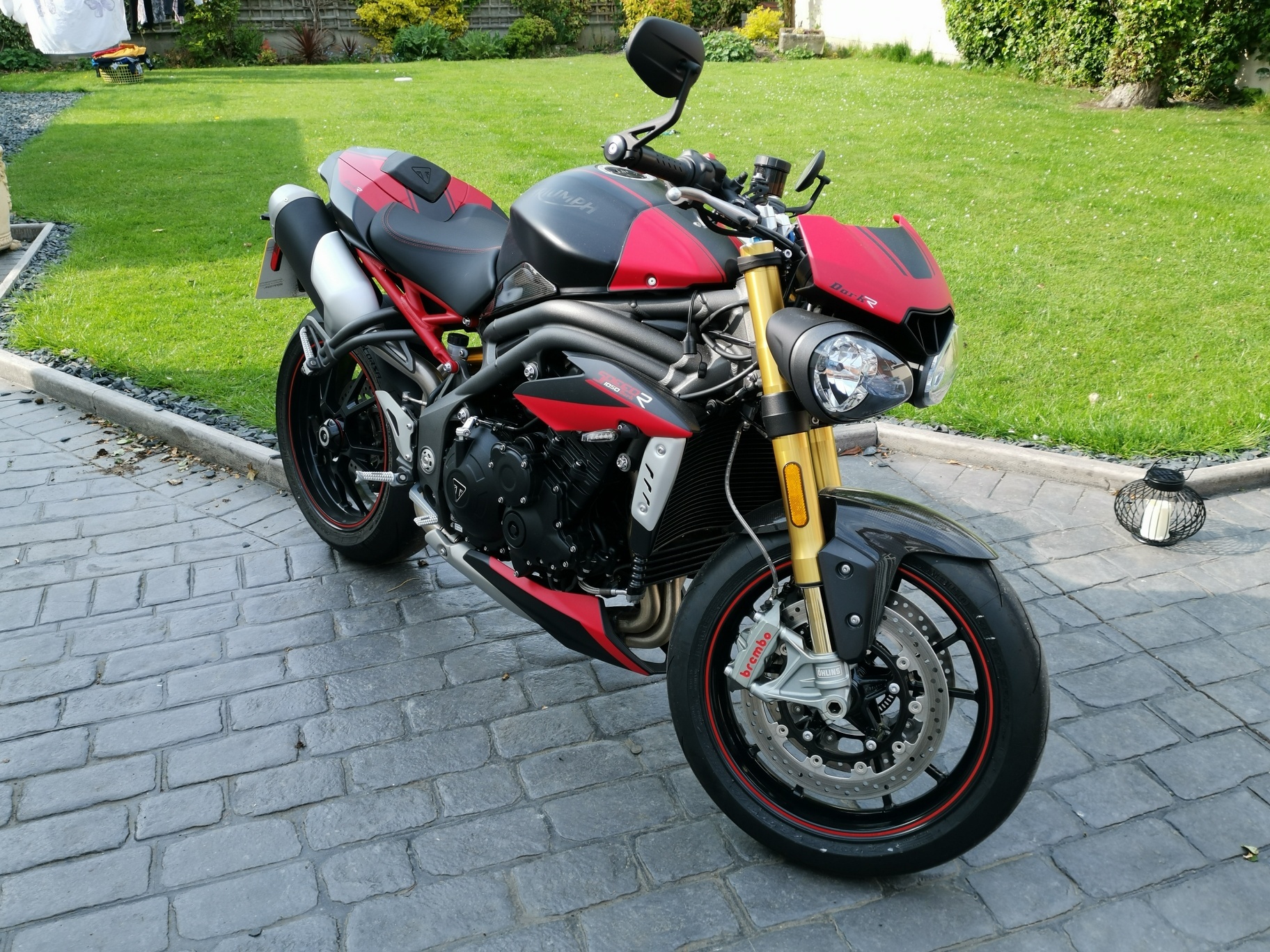

    Getting a few miles on my Triple R, so wanting to get the ohlins set up correctly.
    Does anyone have an easy step by step guide or is it just a matter of just moving the 2 knobs about untill it feels about right. The ohlins were one of the reasons i went for the R, so want to get them set up correctly IMG_20190430_163947_resized_20190507_073429253.jpg

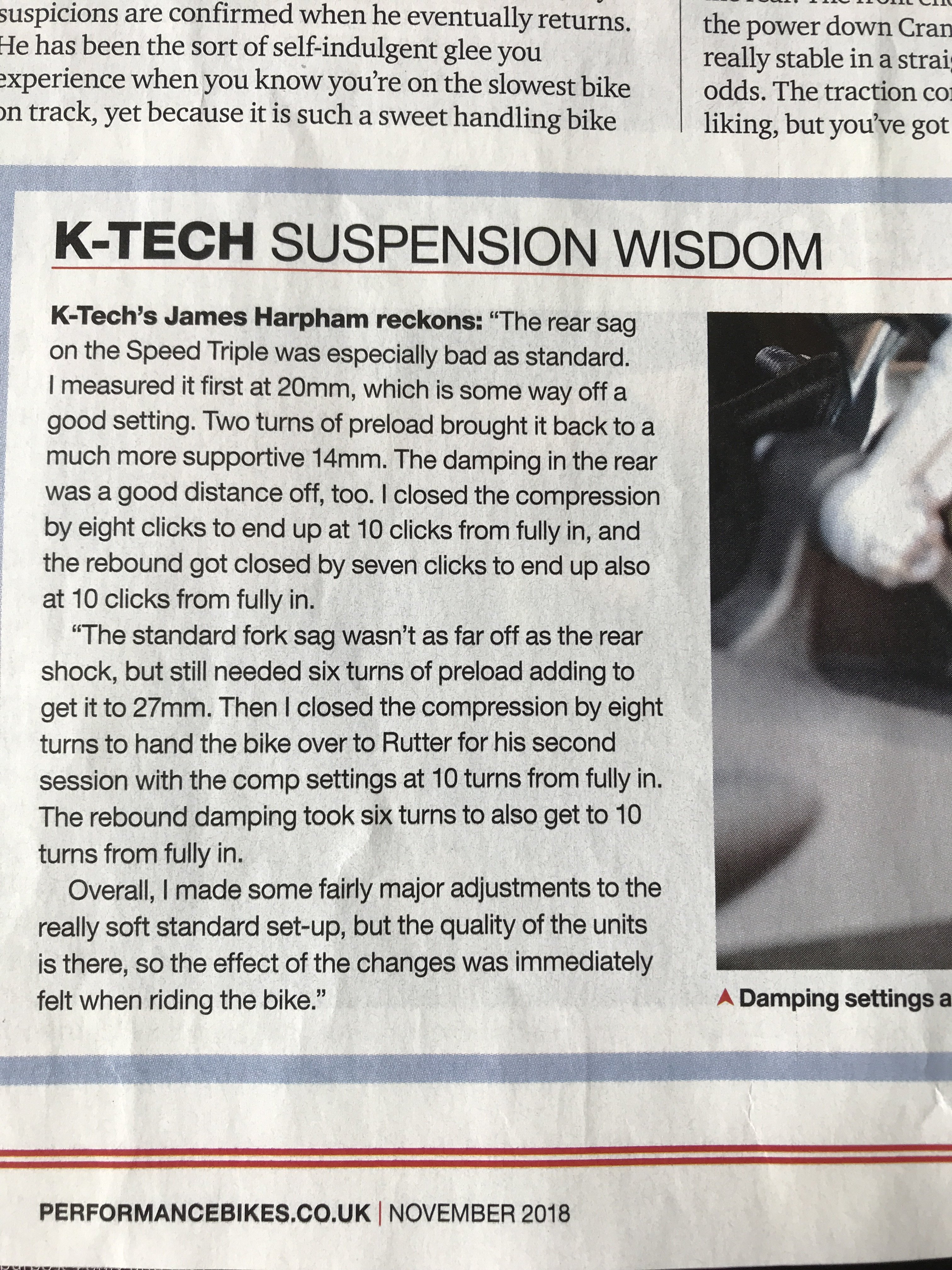

  18. Ducatitotriumph
    Apr 25, 2019
    2,181
    Rothwell
    Hi there,
    I found this in pb nov 18.
    Rutter around donington.
    Speed and street track setup.
  19. RSReggie
    RSReggie Active Member
    Apr 9, 2019
    114
    North West UK
    Good info! Those settings were for track use and of course sag settings static. Probably ease off for the road. I did set my static sag to 15mm
    as I prefer a faster steering bike, but went in between standard settings and theirs on the damping based on how the bike felt on the road. If its a bit choppy, ease off, if its a bit wallowy accelerating on a bumpy corner tweak it up... down to personal taste, but best start a the standard settings for a safe handling set up.
