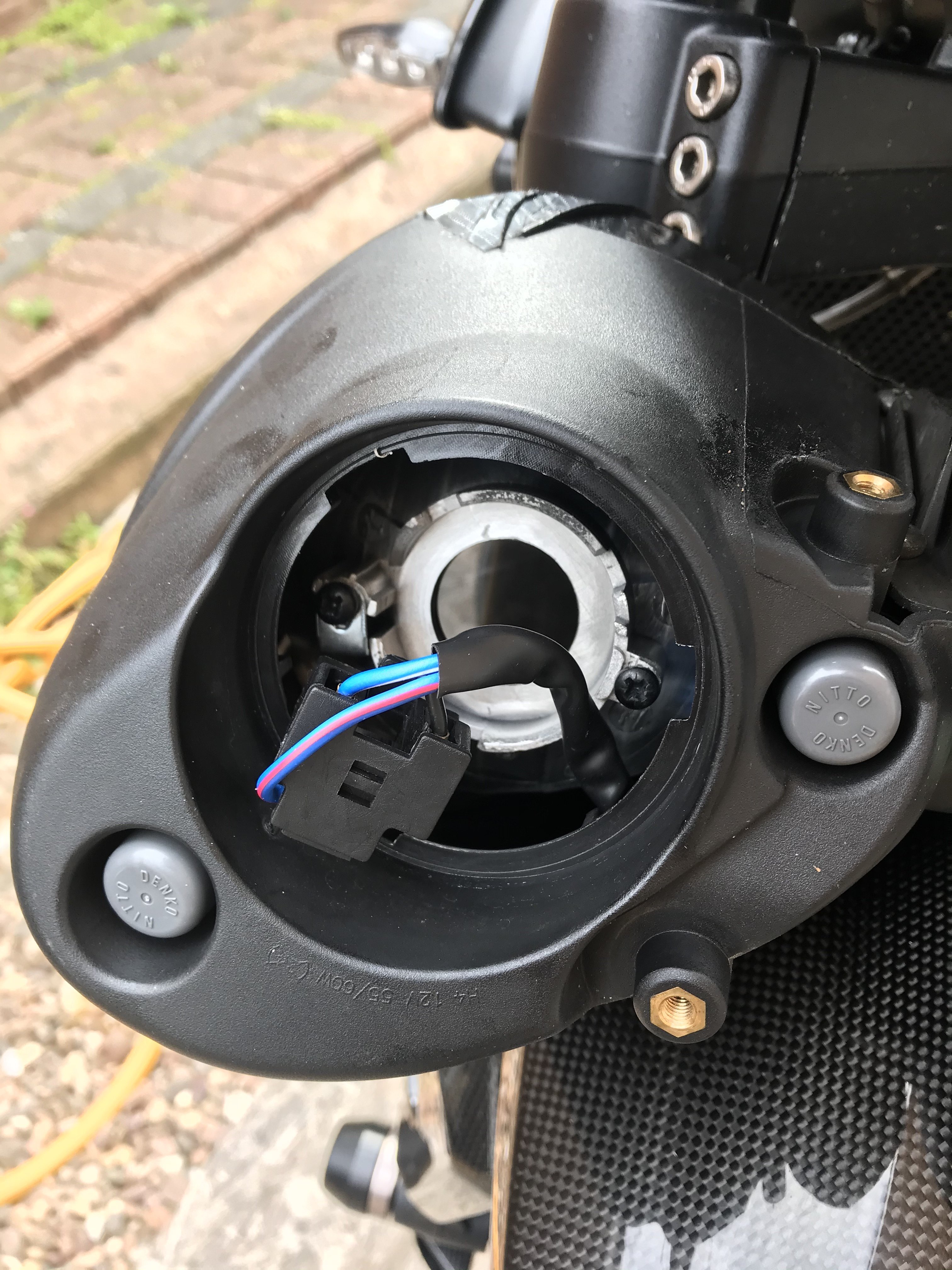

    I just bought some from Ledperf.co.uk for my 2017 Speed Triple R, was just about to put a post up asking if anyone had fit them before?
  3. Ducatitotriumph
    Apr 25, 2019
    2,181
    Rothwell
    Yep, I did.
    Tight squeeze but work well.

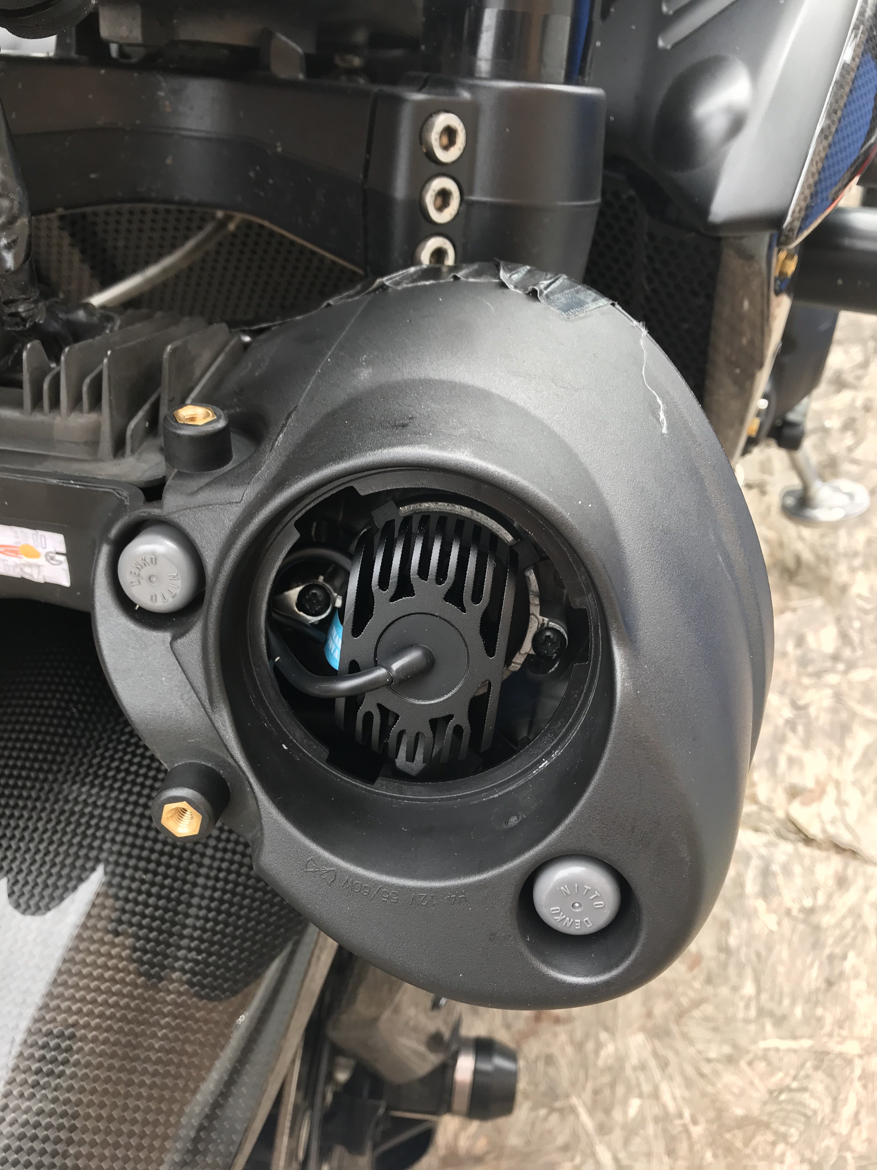

  4. Ducatitotriumph
    Apr 25, 2019
    2,181
    Rothwell
    here..

    I decided not to do it myself. Too worried of excessive heat melting the plastic lenses/housing. Also, two headlights are a very good light source as is. I am interested to hear how this works out for you though.

  7. Ducatitotriumph
    Apr 25, 2019
    2,181
    Rothwell

    excellent thank you.. the back of your lights looks slightly different to mine but, similar space limitations!

    Do you leave the rear housing seals off for heat dissipation?
  10. Ducatitotriumph
    Apr 25, 2019
    2,181
    Rothwell
    No, they are on.
    If you leave them off, you’ll run the risk of condensation getting in so it's not worth it IMHO.
    The leds have a very good/large heat sink on them so i've never had an issue.

    The heat has to go somewhere, and if inclosed has me worried. How long have you had them in place?
  12. Ducatitotriumph
    Apr 25, 2019
    2,181
    Rothwell
    3 months. No issues for me.
    I suppose it depends what you’re comfortable with.
    I had the same thoughts and was constantly checking but as there was nothing happening, i stopped bothering.
    Why not run them with the cover off and then see if you’re happy with the temp, and then try on?

    Triumph just warrantied my lenses, they developed hairline cracks. I'd kick myself if I put those in and melted them lol. I just don't have have issues with the factory setup, but have used LED before on my previous bike. LED are great.

  15. Ducatitotriumph
    Apr 25, 2019
    2,181
    Rothwell
    You don’t HAVE to but I tried without doing that but I found it easier to just undo the 4 bolts. Only takes 20 mins all in.
    Don’t have to remove anything else (putting the rubber grommets back in takes a smidge of wd btw).
