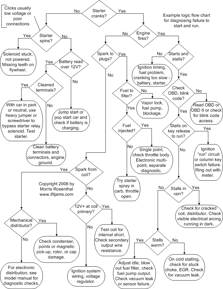

    A Spark ignition engine needs: Fuel / Spark / Air supply to run properly

    That was a ridiculous suggestion by your 'shop' to install a replacement ECU because it 'might' be that with absolutely nothing to go on
    First thing I would do is put the original back - you don't even know if the replacement has the correct map or even it's condition, so go back to at least what you had originally and only replace the ECU if/when you can prove it to have a problem
    Is the Neutral Light on?
    The ECU MUST see EITHER the Neutral Signal OR the side-stand UP - if you have no Neutral Light (even if transmission itself is in Neutral), or it's flakey, raise the side-stand and try again
    When you turn on the Key, do you hear the Fuel Pump run (for about 3 secs)? (it should repeat this behaviour if you flip the Kill/Run to Kill and back to Run again)
    Have you (or anyone) checked for spark or fuel?
    Are the Plugs wet? Do they spark when removed and observed with engine cranking?
    Have Coils And Injectors been checked for 12V supply at their connectors?
    If you remove the TOP fuel hose (ONLY!!) from the pump do you get fuel pumping from it when you first turn on ignition and again when cranking the engine?
    These are fundamentals that any competent shop should be able to determine.
    If it's a non-Triumph shop or shade-tree, get it out of there and find someone who knows their way around Triumphs.
    One of the elements I would check if you have confirmed Neutral Light and Pump running at key on and 12V supply at the coils and injectors would be the Crank Position Sensor
