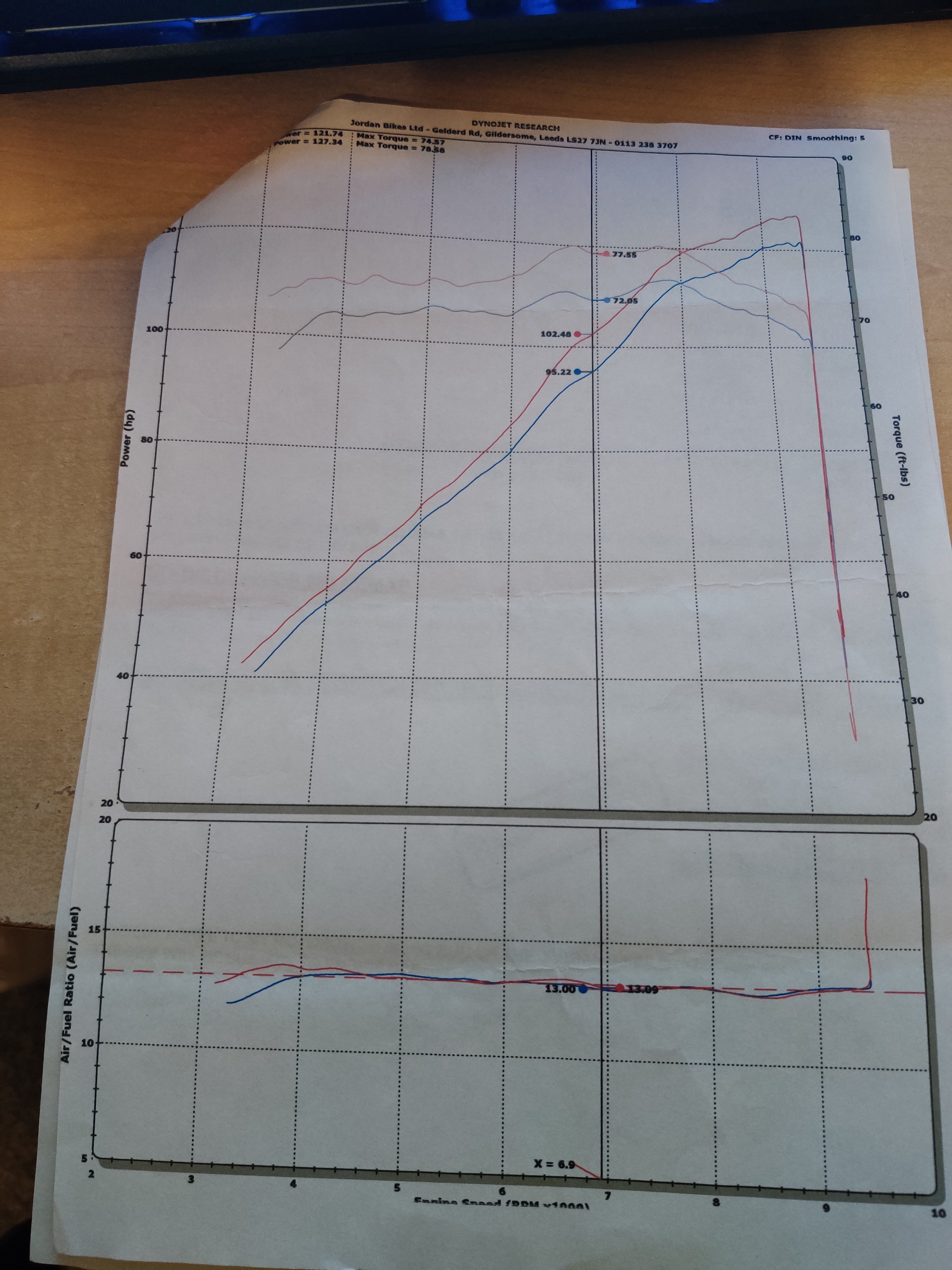

    Hi fellow members, i bought a speed triple 2011 last august which is really well conserved for her age , now during the summer season the bike was fine but in the middle of September the idling started to play funny( the rpm goes higher and lower ) , the bike revs nicely no surges plenty of poke , went to triumph dealer and they told me it might be the valves soo they done the valves which were spotless and when they tried to do the throlle sincronization somehow they couldnt sincronize it properly soo i am guessing that be something to do with vacum leak? or injectors?

    Welcome to the forum Rui. When you say it was dynoed, did that include any messing around with the air fuel mixture. If so, that could be part of it.

    I dont know if that is the cause the dyno was done 21/09/2018

    The dyno looks good, unlikely it’s a A/F issue if nothing has been messed with since the dyno. Is there an after market exhaust?
