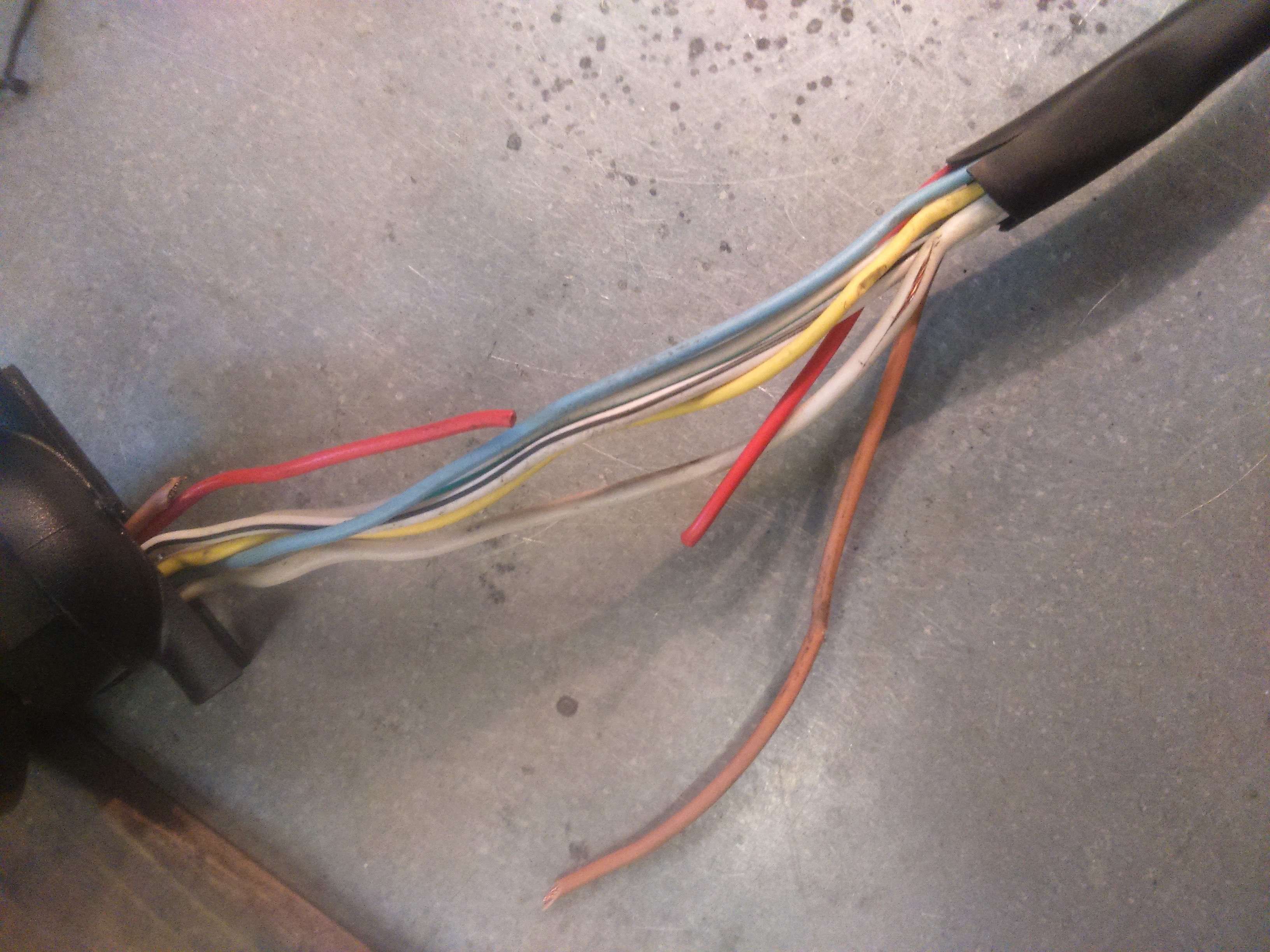

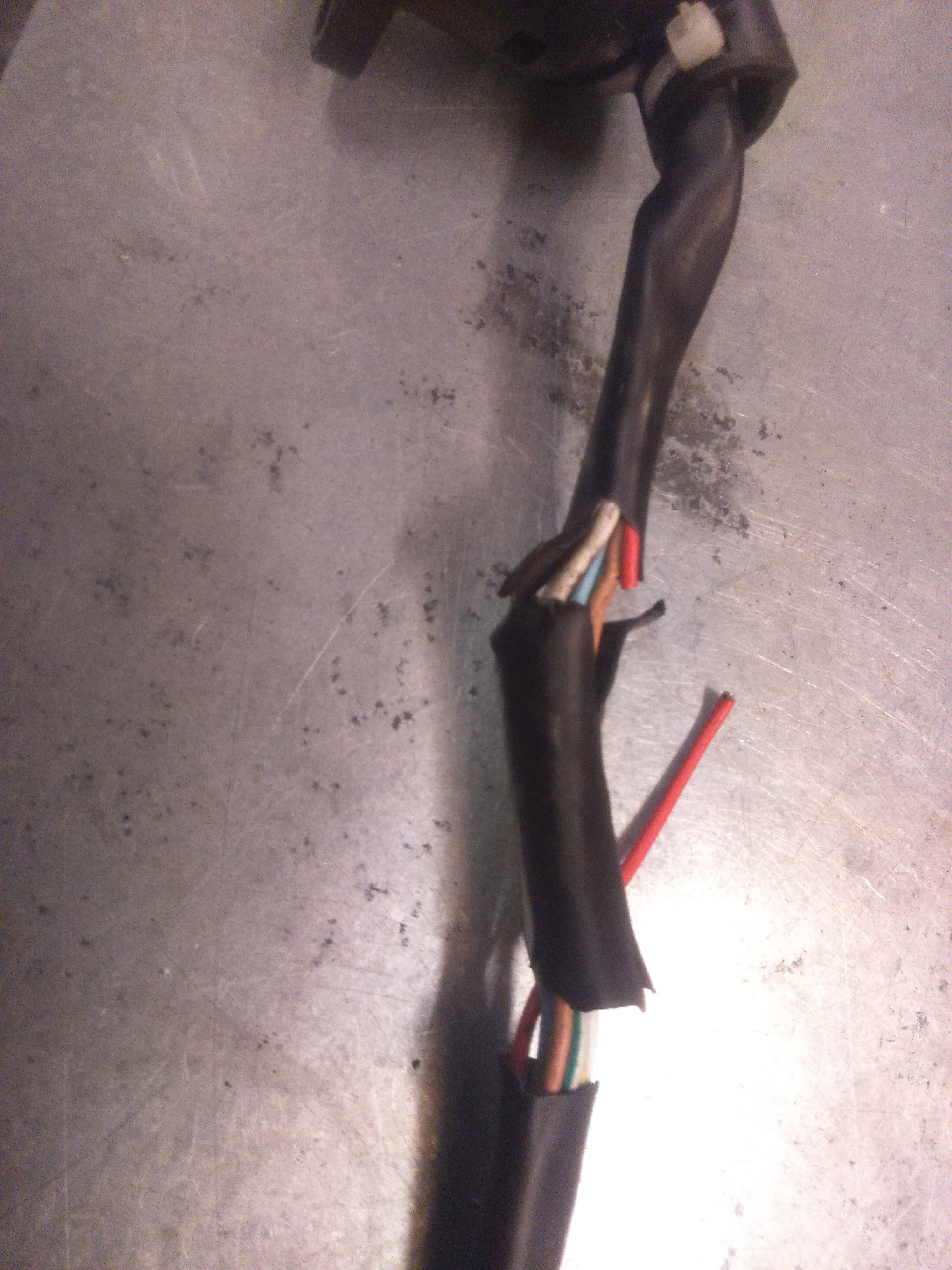

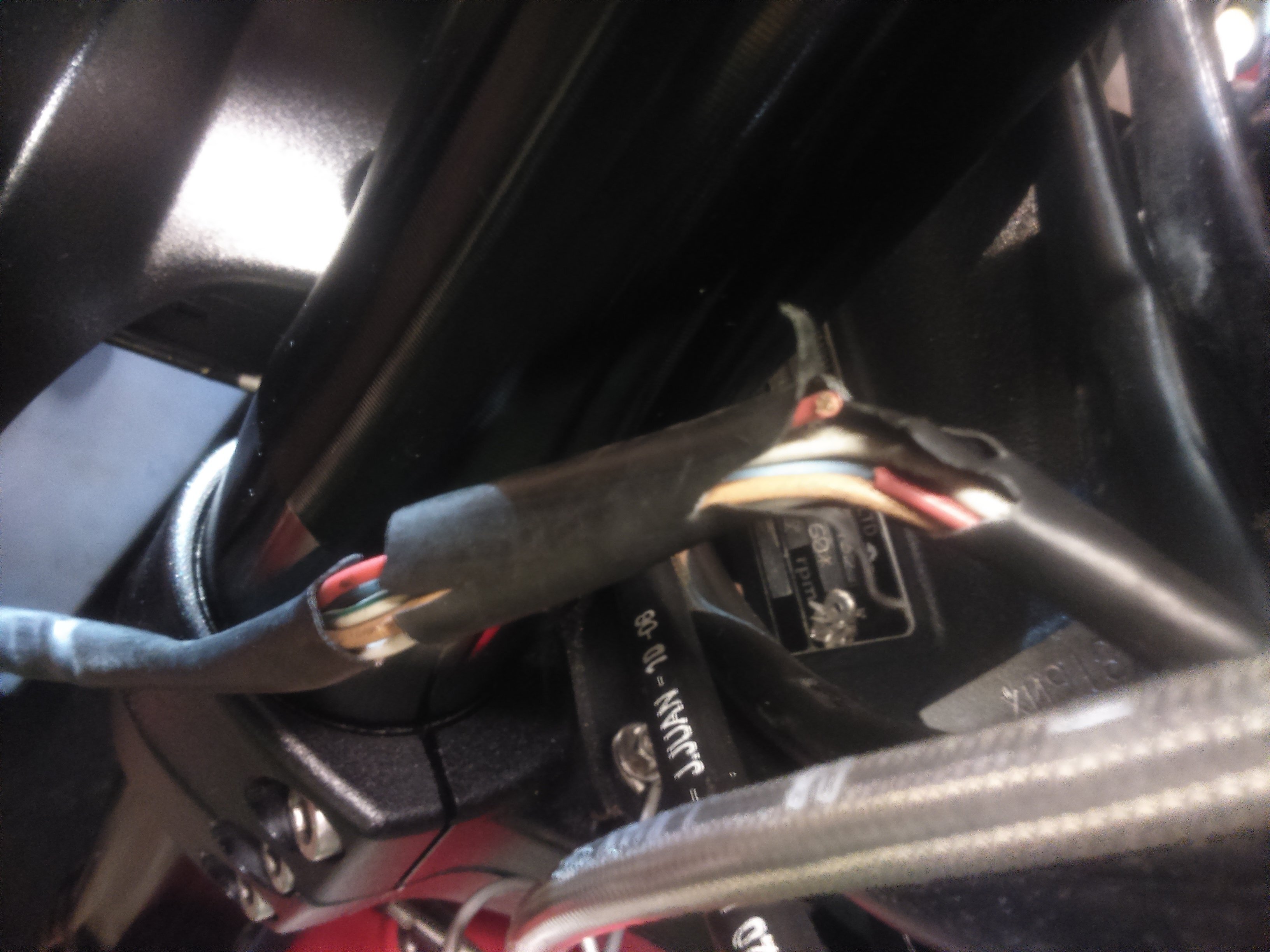

  4. Speedy Pete
    Speedy Pete Well-Known Member
    Feb 1, 2019
    85
    78
    Hi, I think it must still be the wiring also, as with mine there were several areas not broken but chaffed giving shorts.
    At first I was going to repair, then decided to purchase a new ignition switch complete for around £118.
    I separated the switch part from the barrel as I wanted to keep the original keys.
    The wiring exits the ignition switch in a different place on the new one to prevent the problem reoccurring (Triumph must have been aware).
    All problems solved.
