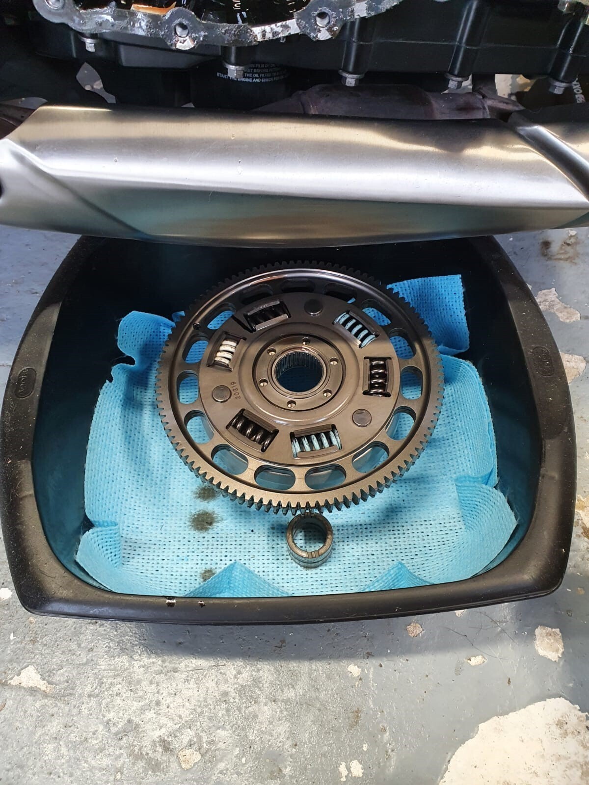

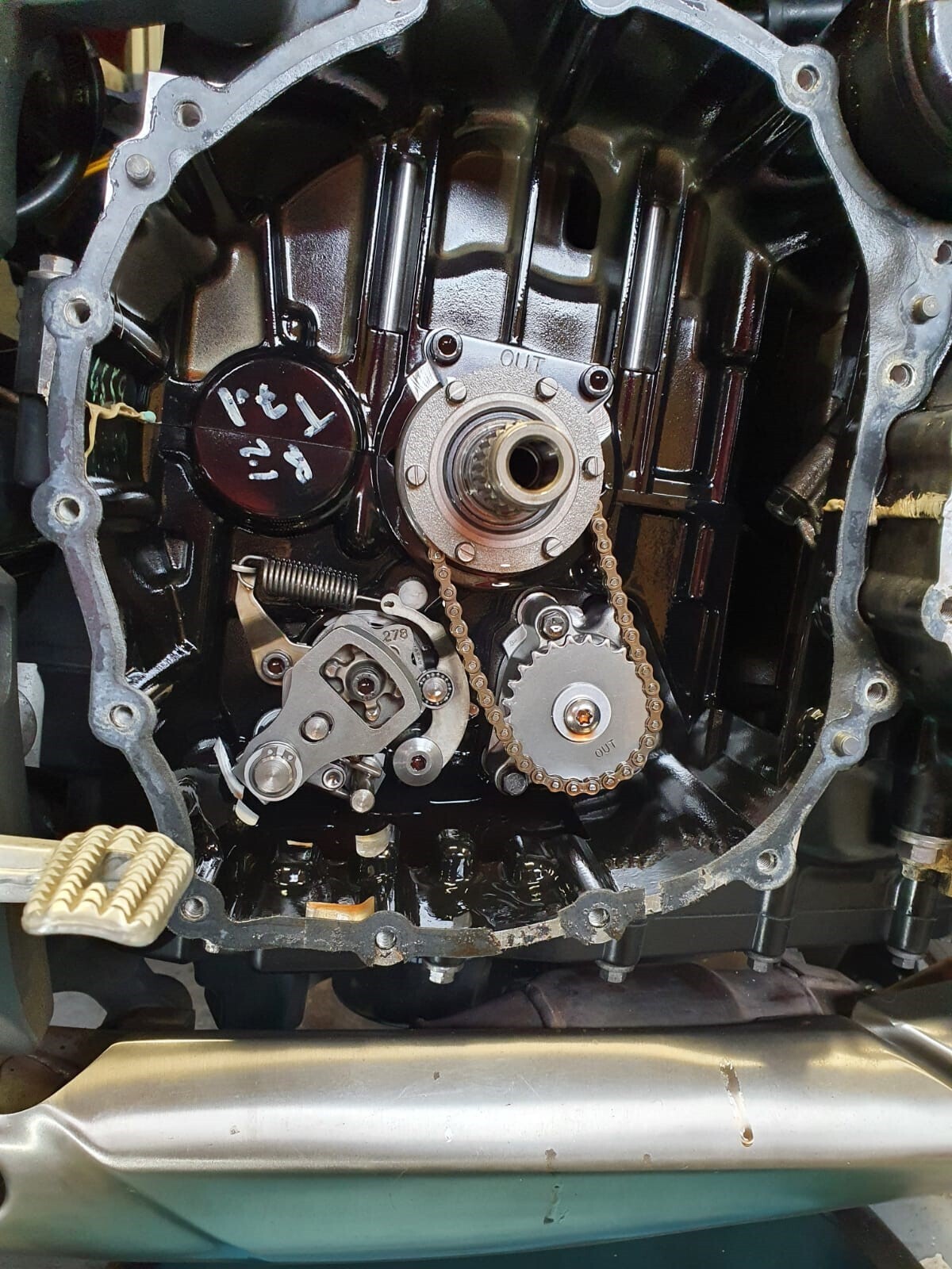

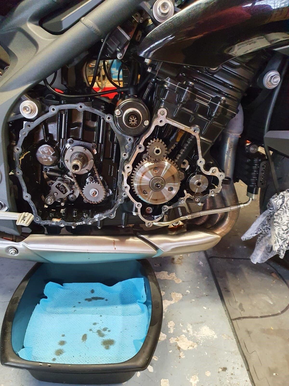

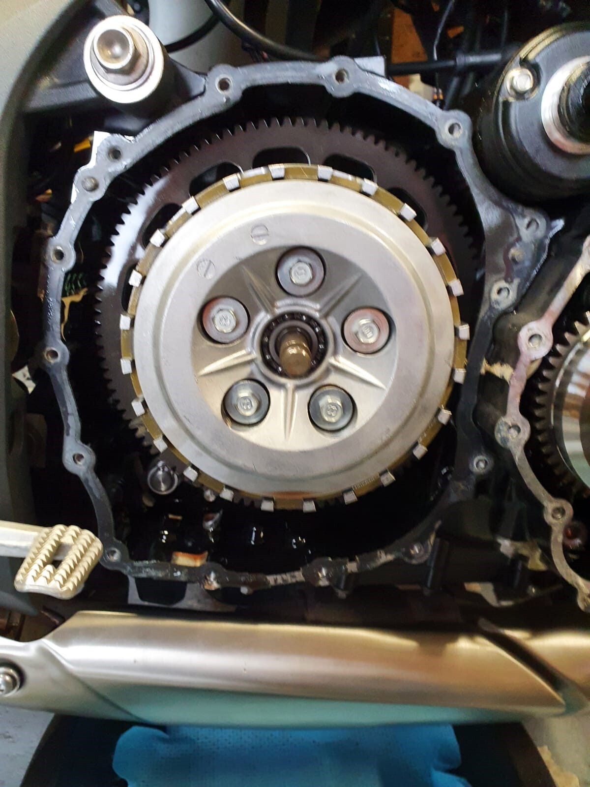

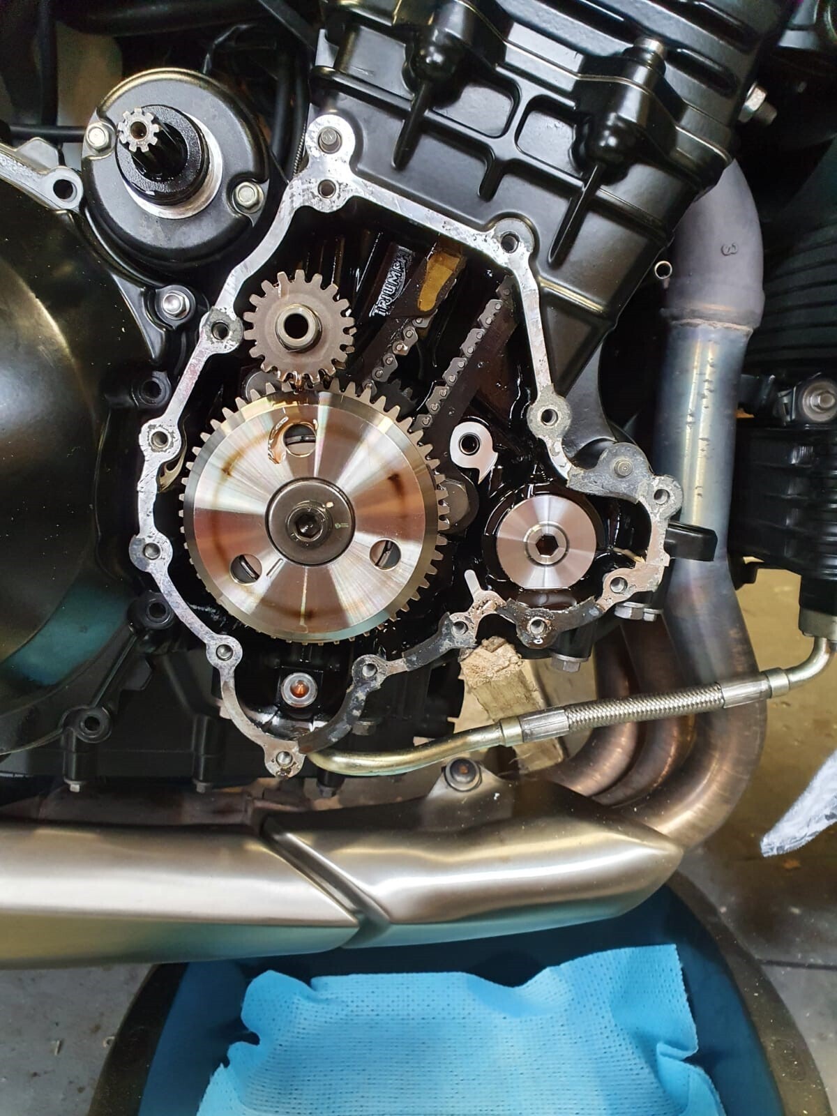

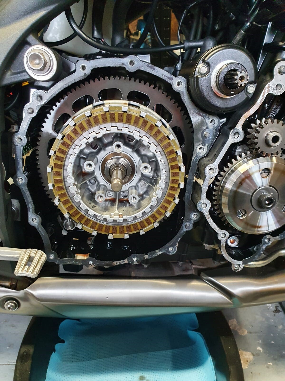

    Hi Neil and welcome to the forum, unfortunately the symptoms you describe are clutch related, however it does not affect all the 1050s, it appears years 10 and 11 are affected the most, the only way is to strip the clutch, if you are confident to tackle it then all is ok, however the first port of call should be to return the bike back to the dealer and request they rectify the problem, and don't let them fob you off with any excuses. Back to the clutch, I put a detailed post on the forum a while back on the clutch, there is a sequence to the clutch plates when re installing, some plates are thicker than others, they are coloured differently, also there are steel spacers and a concave spacer, this has to have the concave facing outwards, there are also 2 different torque settings for the clutch basket securing nut, you need to make sure by referencing the engine number. If you look at my previous post as mentioned the full sequence is there to read. There was a fault with a spring at the back of the clutch, it was weak, there is an uprated part available, if you intend doing the job yourself then PM me and I can let you have all the required gaskets and a new uprated spring of German manufacture, also I would suggest using semi synthetic oil rather that fully synthetic. Can you tell from looking at the clutch and starter covers if they have been removed before, if they have then the plates may have been mixed up and incorrectly installed, including the concave spacer. All this said take it back to the dealer ASAP and make sure they sort it for you. I have attached a few pictures from one I did to show what things look like.
