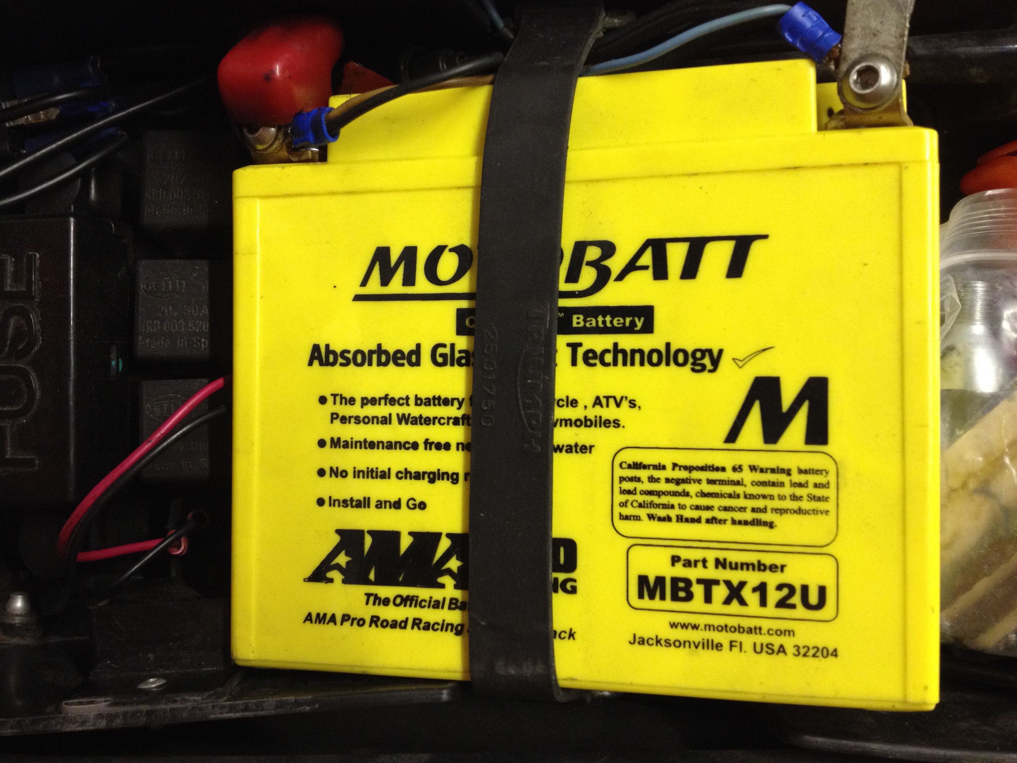

    Hi Roger, you may have already sorted this, but I found my 2009 Speed Triple with a standard battery a bugger to start if I did a short journey, stalled in traffic etc. It would always start from home, but if the battery wasn't in tip top condition and charge it wouldn't want to know. Sometimes leaving it a few minutes worked and sometimes it didn't. In the end I replaced the original battery with a Motobatt MBTX12U (one of those yellow jobs they put in jetskis and things) - it has a bit more cranking power and hasn't let me down since. It only just fits under the seat so see if you can find someone you can take the bike to and make sure it fits before you commit (they're a bit more expensive than the standard battery but I reckon it's definitely worth it)

    With that size battery you could fit a Motobatt size 14 battery that I understand is physically the same size
    You would have an increase in CCA which is the immediate power available when starting

    Yeap went ahead and ordered the motobat mbtx12u so will see if that works better. Pulled away at the lights again and couldnt shift out of 1st. Pure twat moment. Will update on how the new battery works, also might take the fly screen off to get more an old style to highlight those twin round lamps.

    Fitted motobat 14ah cca200 battery, same as posted, it does have some extra grunt when trying to start after a short run and turning off. I may need to try a combination of taking keys out leaving on stand for min then start, plus turn ignition off and restart etc as after putting on stand you can hear the electrical sound of something powering off. Do I need to fully charge the battery on a charger as it difficult to get a good 1hr run in this London traffic. Also have to litteraly boot the gear level from 1 to 2nd. Driving me crazy.
