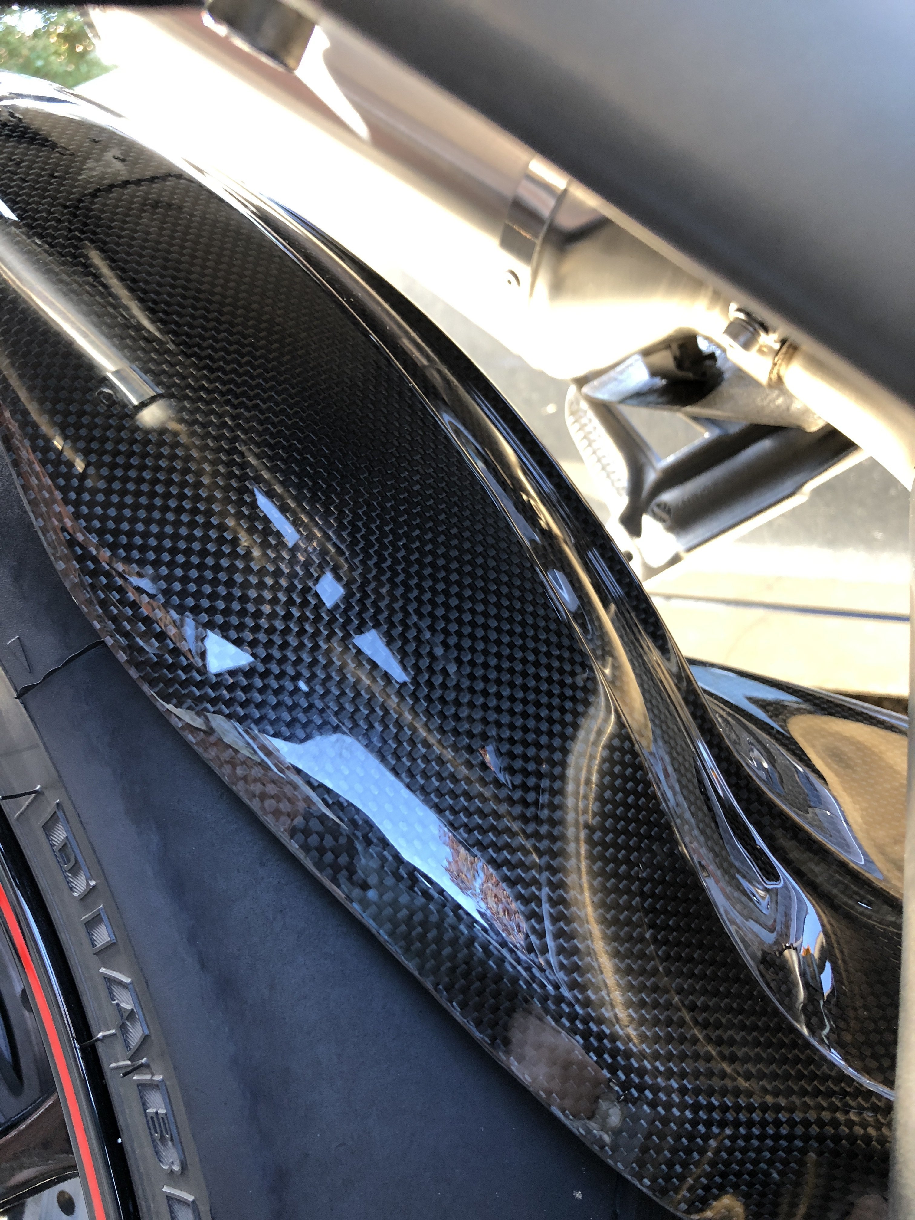

    Thanks for all the tips. Rear wheel removed within 10 minutes this morning and rear hugger swapped for a carbon one!!

    Yeah the circlip went back in no problems!! One of those bolts on the hugger was still awkward to get to even with the wheel out the way!!
