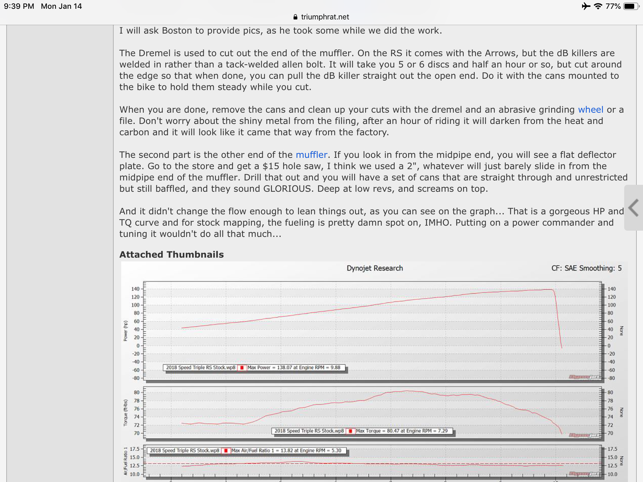

    Sorry I can’t help you with that, but have a look at this dyno run from another forum. Bone stock with exhaust discs and baffles removed. Looks like no need for a tune. I have been running mine like that since last year and it’s been brilliant.

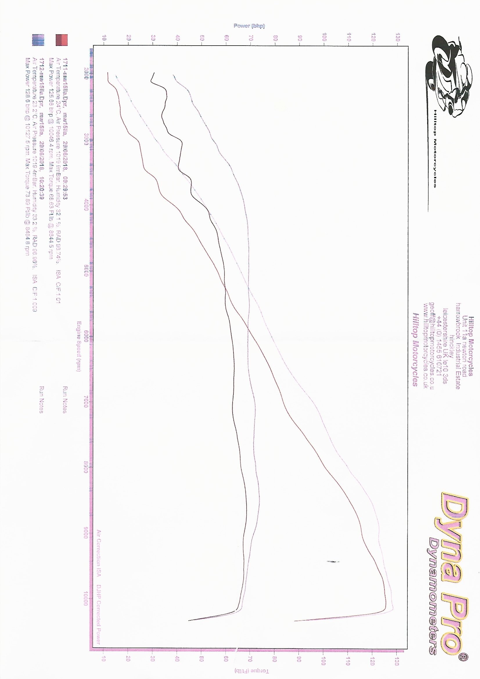

    Try Hilltop Motorcycles in Hinkley.
    Heres the trace they did on my 2015 Speed Triple 1050 R

    Do you have the AFR print out from this too? Not just power and torque.
  5. Dickie
    Dickie Active Member
    Jun 8, 2016
    128
    Tadcaster, North Yorks
    AFR? Air Fuel Ratio - No.

    it’s strange. I have heard lots of mixed press about hilltop, but with one common feature. No AFR graph.
    This to me, as a Motorsport transmissions R&D Engineer, points to the power graphs being ‘false’.
    It also ties up quite well with the way the power and torque differ on the before and after.
    Rest assured I won’t go near Hilltop.
