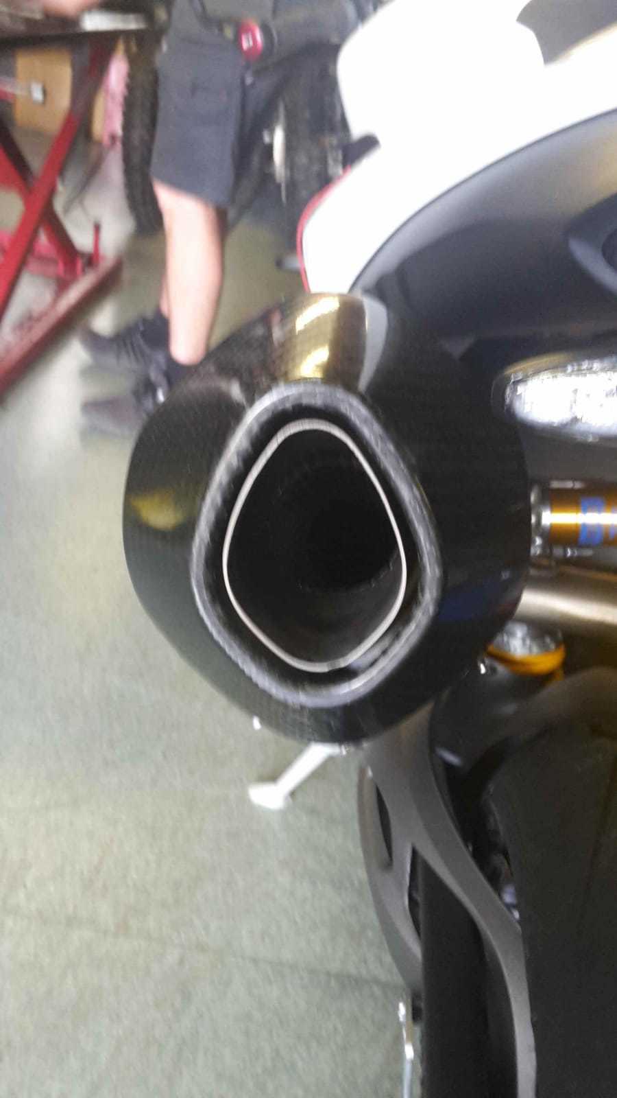

    Hi,
    I’ve removed the baffles from my arrow euro 4 exhaust on my 2018 speed Triple rs, what’s your opinion on the re-learning ecu? Should I get the ecu remapped or is the current dealer arrow map right for the bike?
    The noise from the exhaust is unbelievable it’s so much louder and deeper. I’m not getting any popping or backfiring. I’m just not sure it’s as punchy?? Or is it I’m getting used to the tourque?
    Obliged ; )
  2. thebiglad
    5,064
    Hi Andy, there's every likelyhood that you did have better mid-range torque with the baffles in. Taking the baffles out encourages the engine to run a bit more lean.
    A re-map or Power Commander will counteract that effect and bring back the torque.
