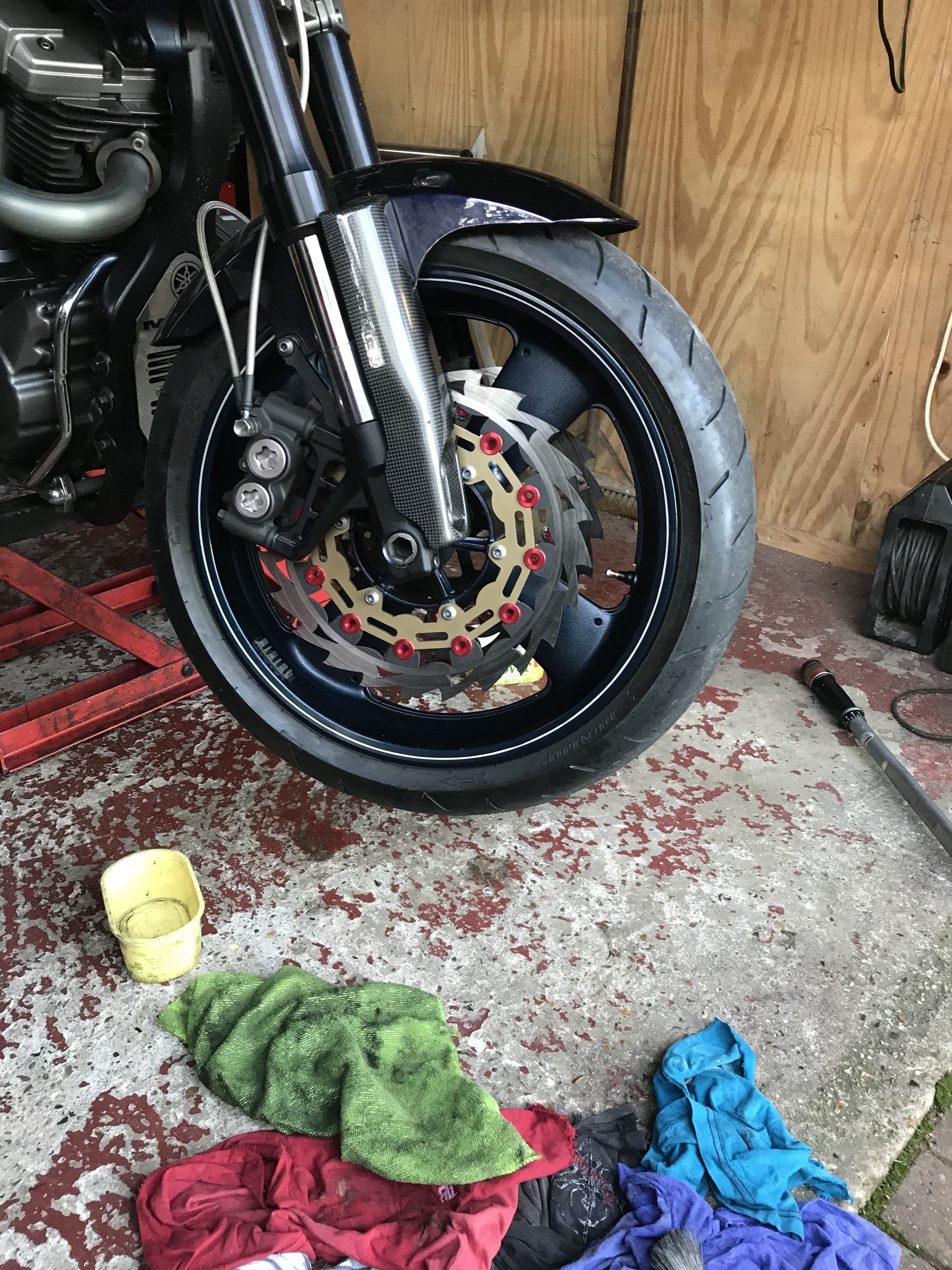

  4. Rocker
    Rocker Elite Member
    May 1, 2016
    1,662
    Suffolk
    He didn't mind these :) E49AB2AC-7DB5-43EE-9E1D-EE5E8F5CB6C8.jpeg

    That's some lethal Mad Max stuff right there :skull::joy:
