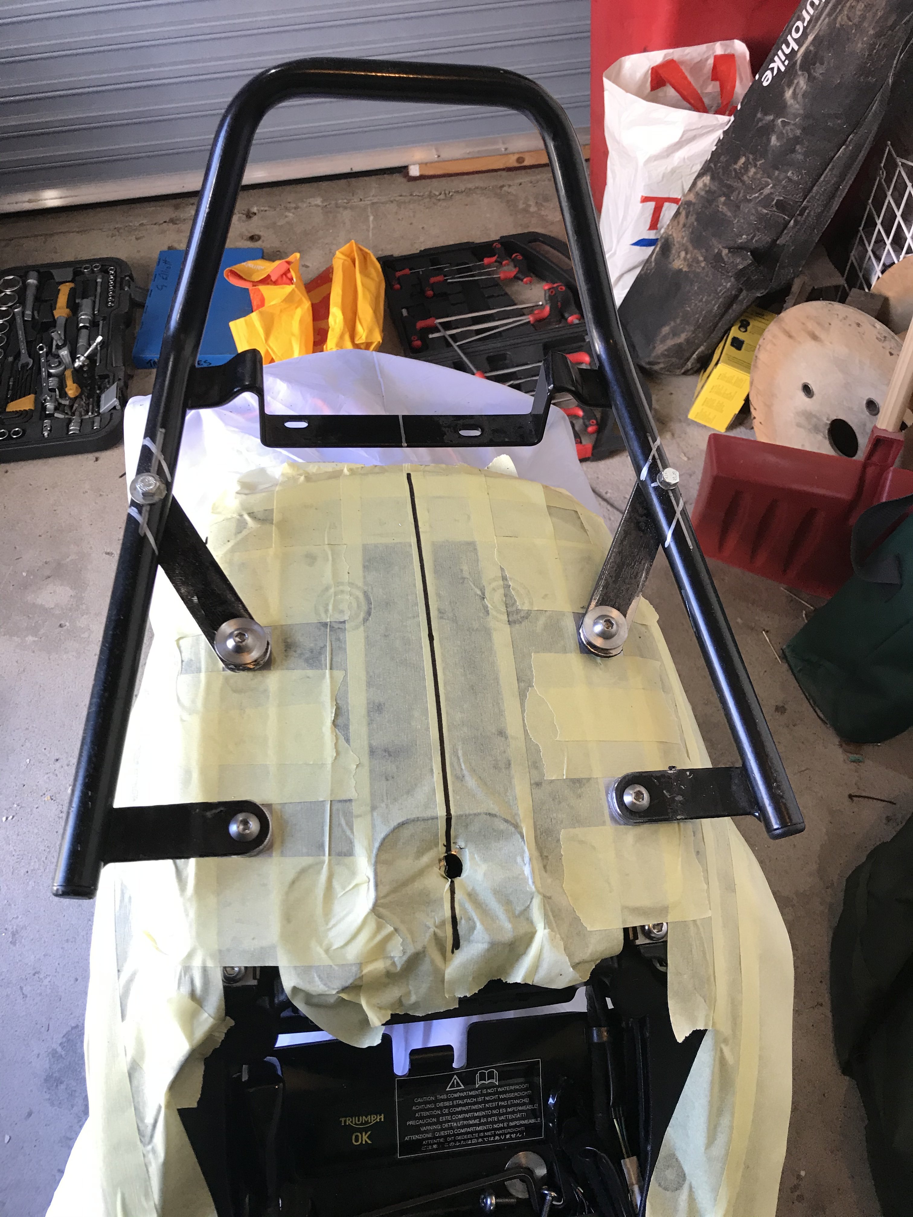

    Was raking about in my garage for some steel bar or angle iron :confused:
    When I found this :eek:
    It’s off my old 92 Fireblade :cool:
    Ooooh I’m pretty sure it’ll give me a bit of a start on part two :p FDEF3217-CE0B-4C10-B3E1-E71C1E31B6E7.jpeg

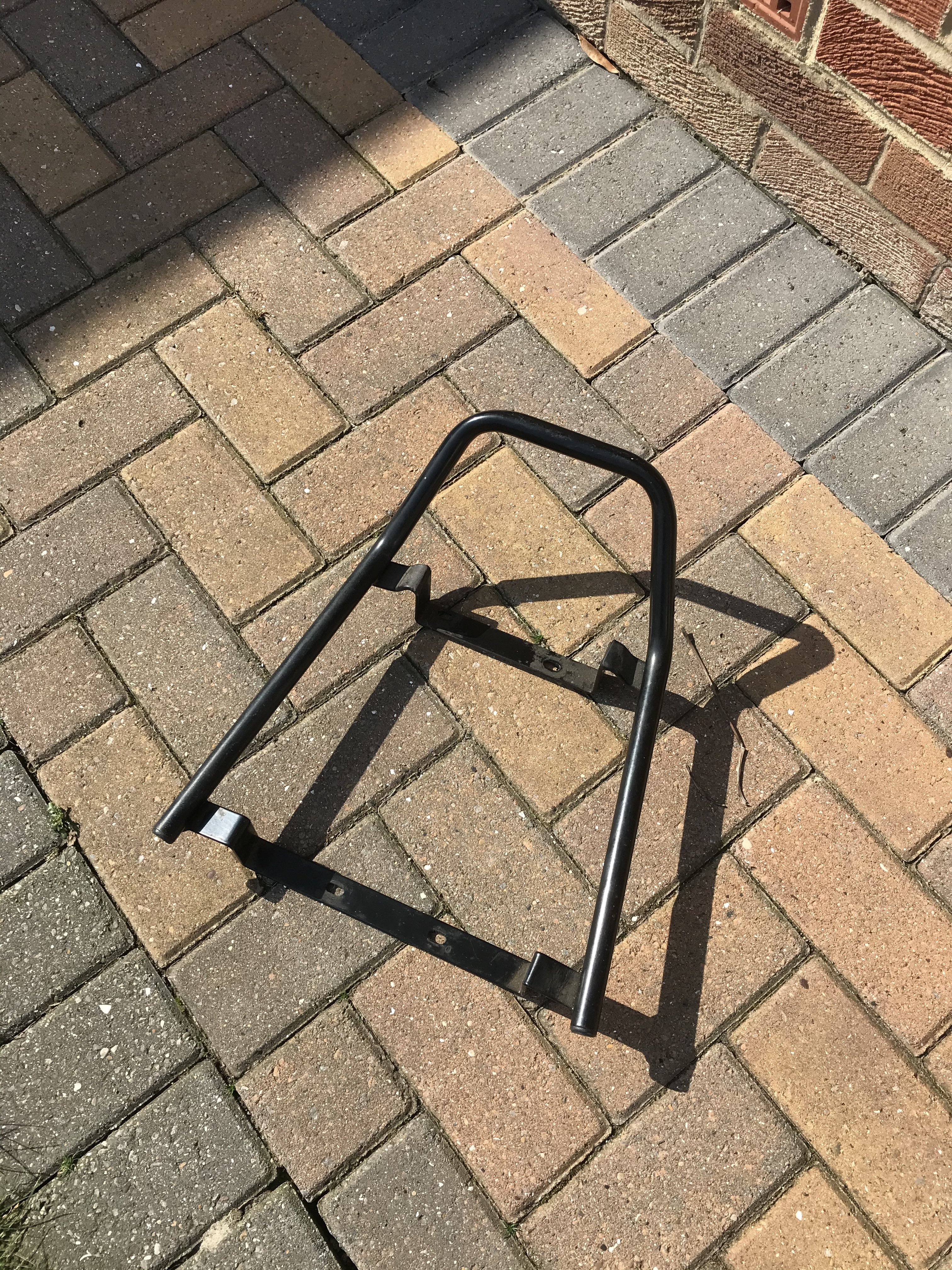

  2. dilligaf
    Bit of sawing drilling and filing :)
    Here’s hoping :confused: AE87B0FD-C9B5-48EC-8D90-55979A6963D5.jpeg

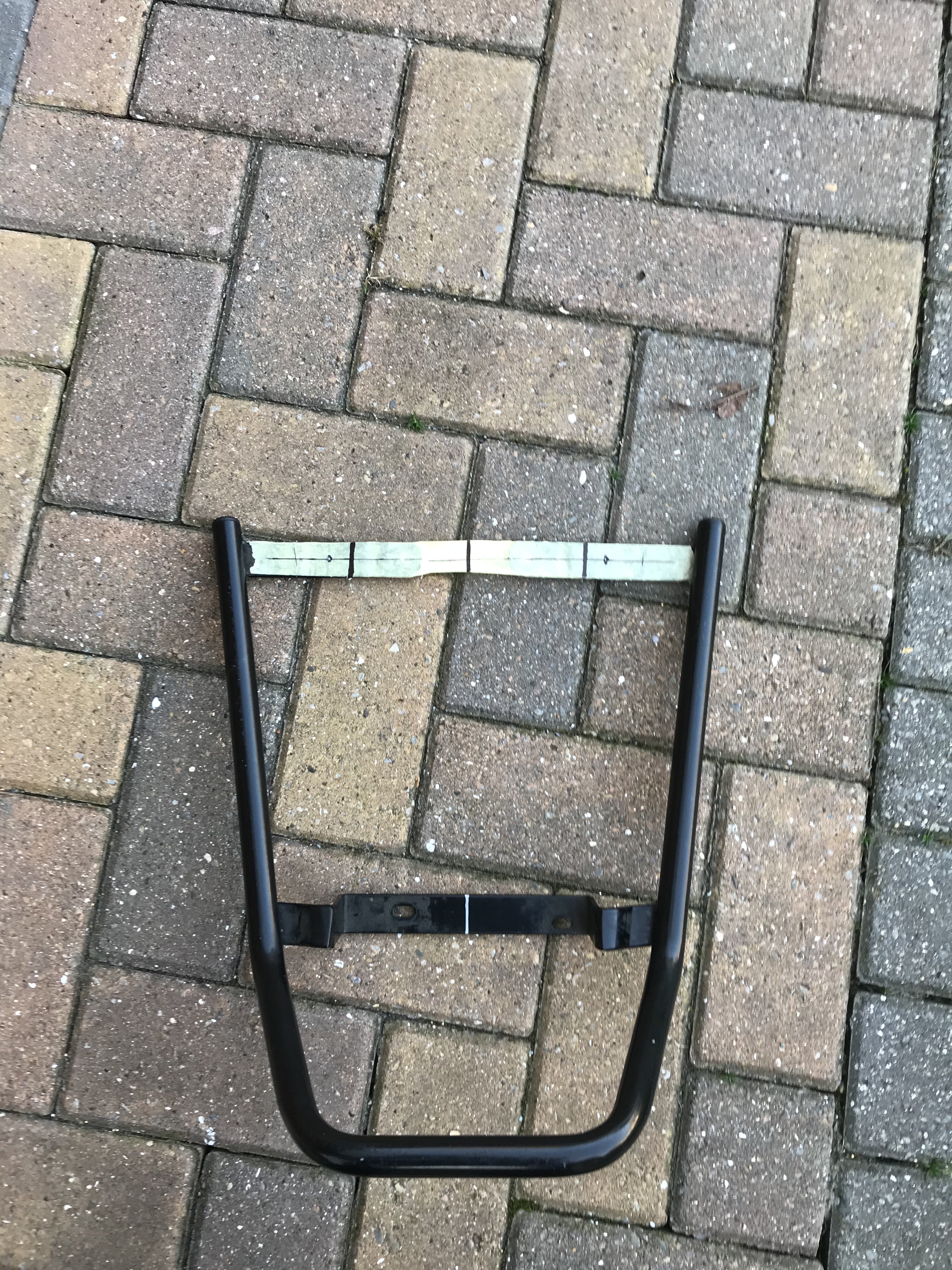

  3. dilligaf
    After cutting and drilling did a trial fit :) A180142B-FFC4-43CE-AD4B-E14C75AC5E59.jpeg

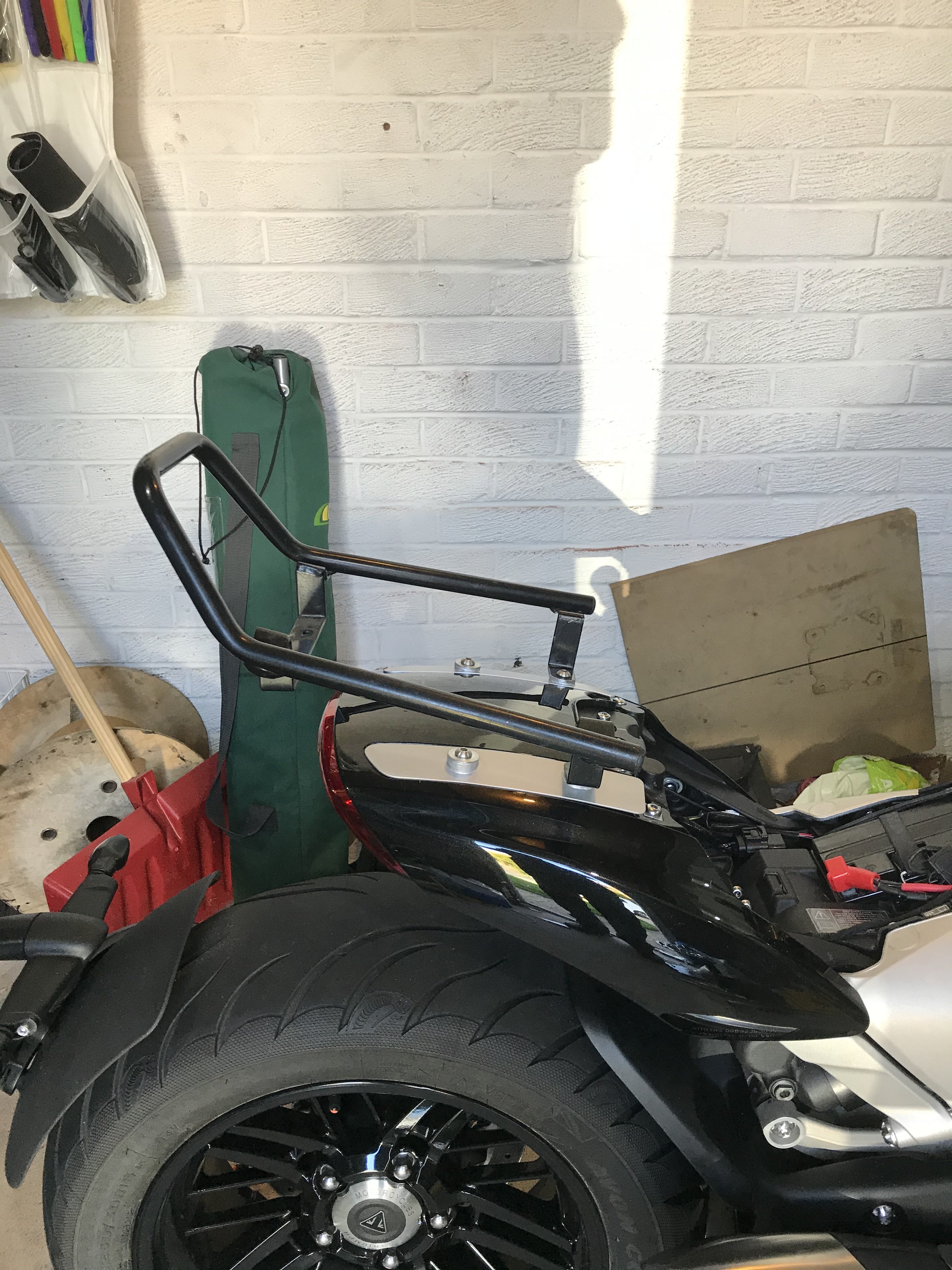

  4. dilligaf
    Put the seat back on :)
    Got wor lass out of the house to sit on the back and see what adjustments have to be made :confused:
    Bugger as I thought the bars of this are sticking into her legs :(
    She said it feels fine :)
    But bowling down the road and hitting pot holes will be a lot different than just sitting in the garage :tired_face: 1657561D-AA88-4D8D-A9B5-F3BBBEA6C632.jpeg

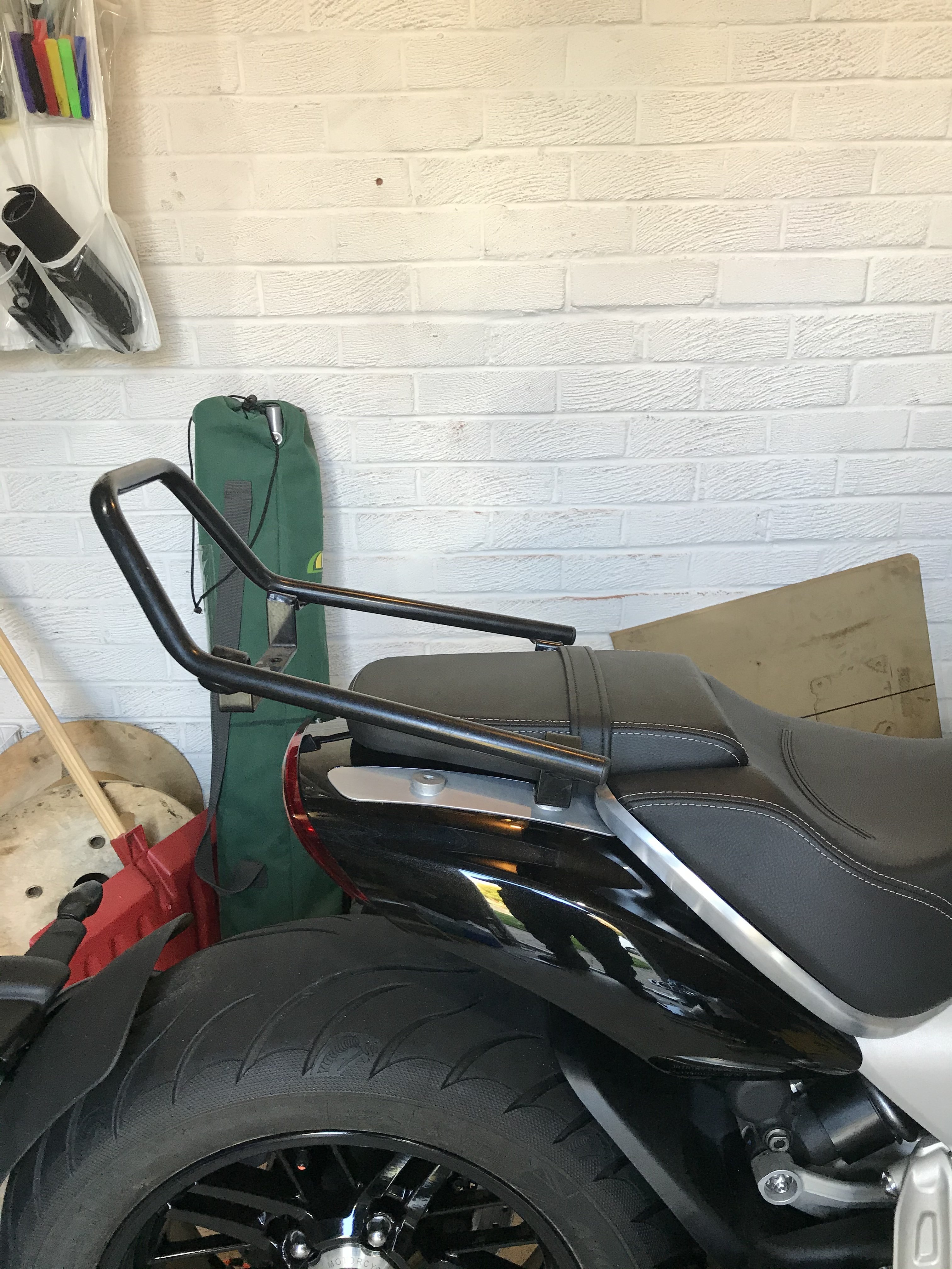

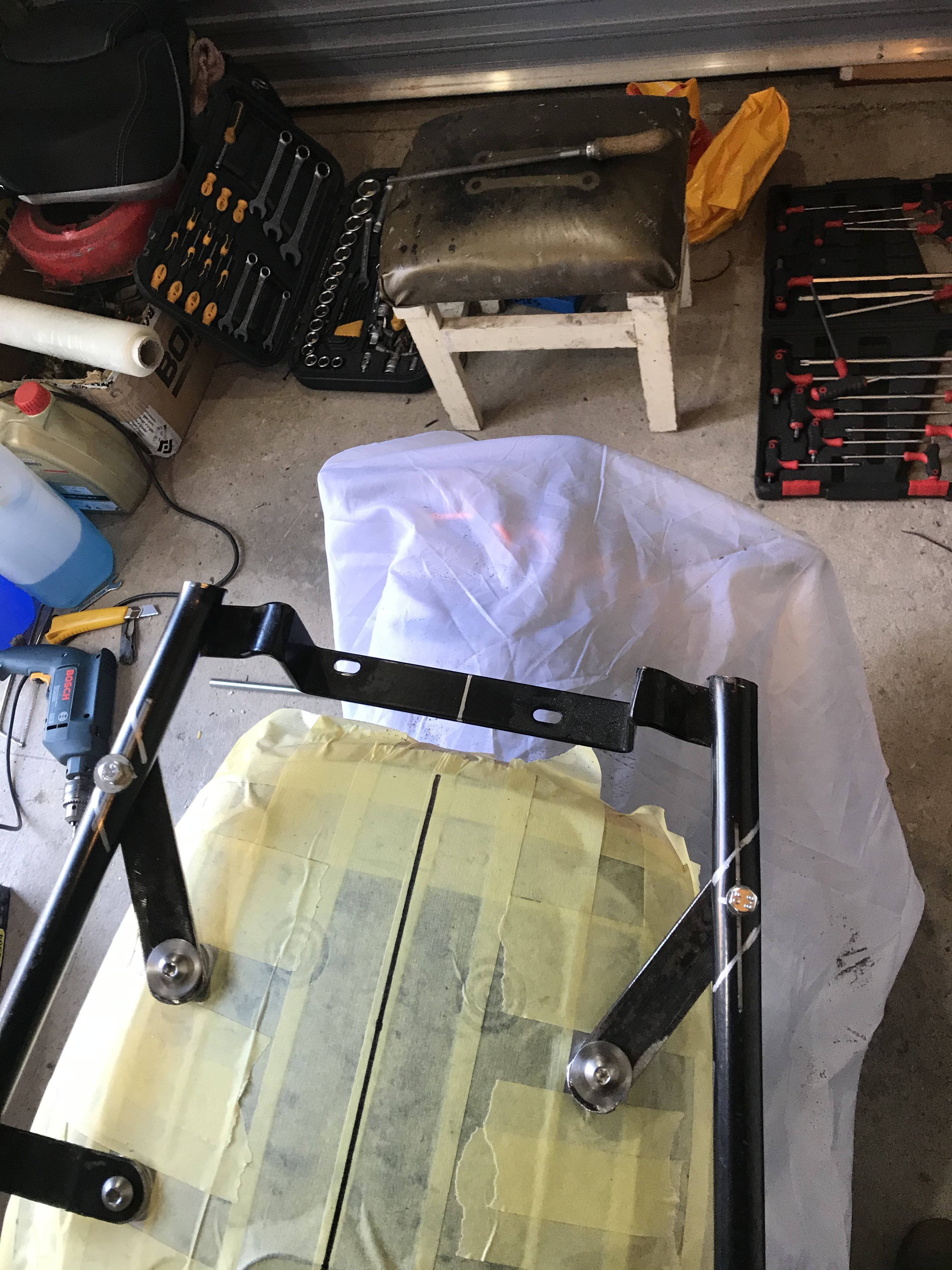

  5. dilligaf
    Using a big lump hammer and my bench vice I flattened the front mounting points to lower the bars :)
    Because I had already cut out the centre of the mount I used some masking tape to find the centre again so I could find where to drill the new holes :) 358CF393-6495-401A-8A1F-46D871B157FE.jpeg

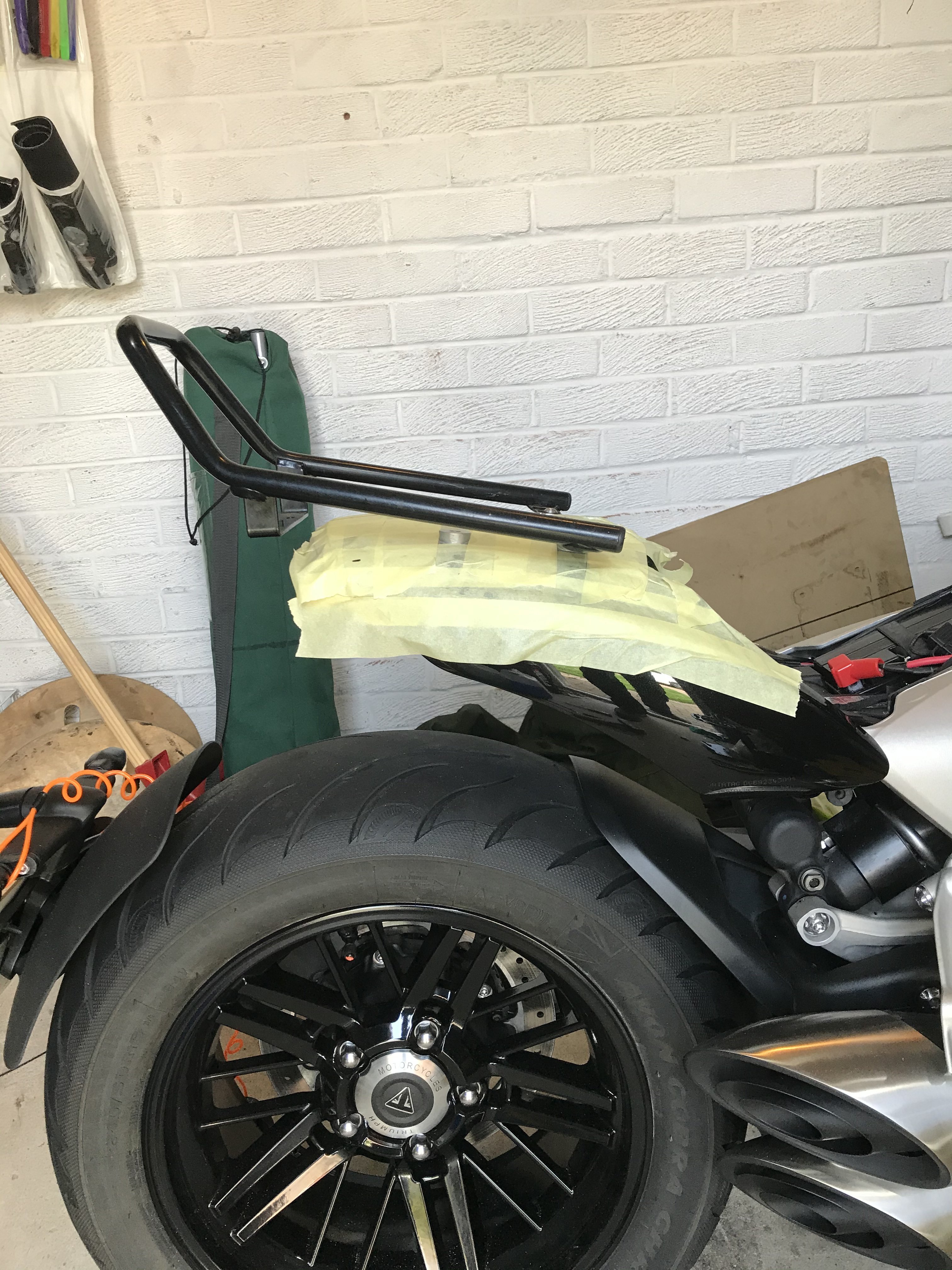

  6. dilligaf
    That’s better :)
    Got wor lass out again and put the seat back on :)
    Now I’m getting somewhere :) FD26469C-B5E3-4977-BB07-B965AF9F77B0.jpeg

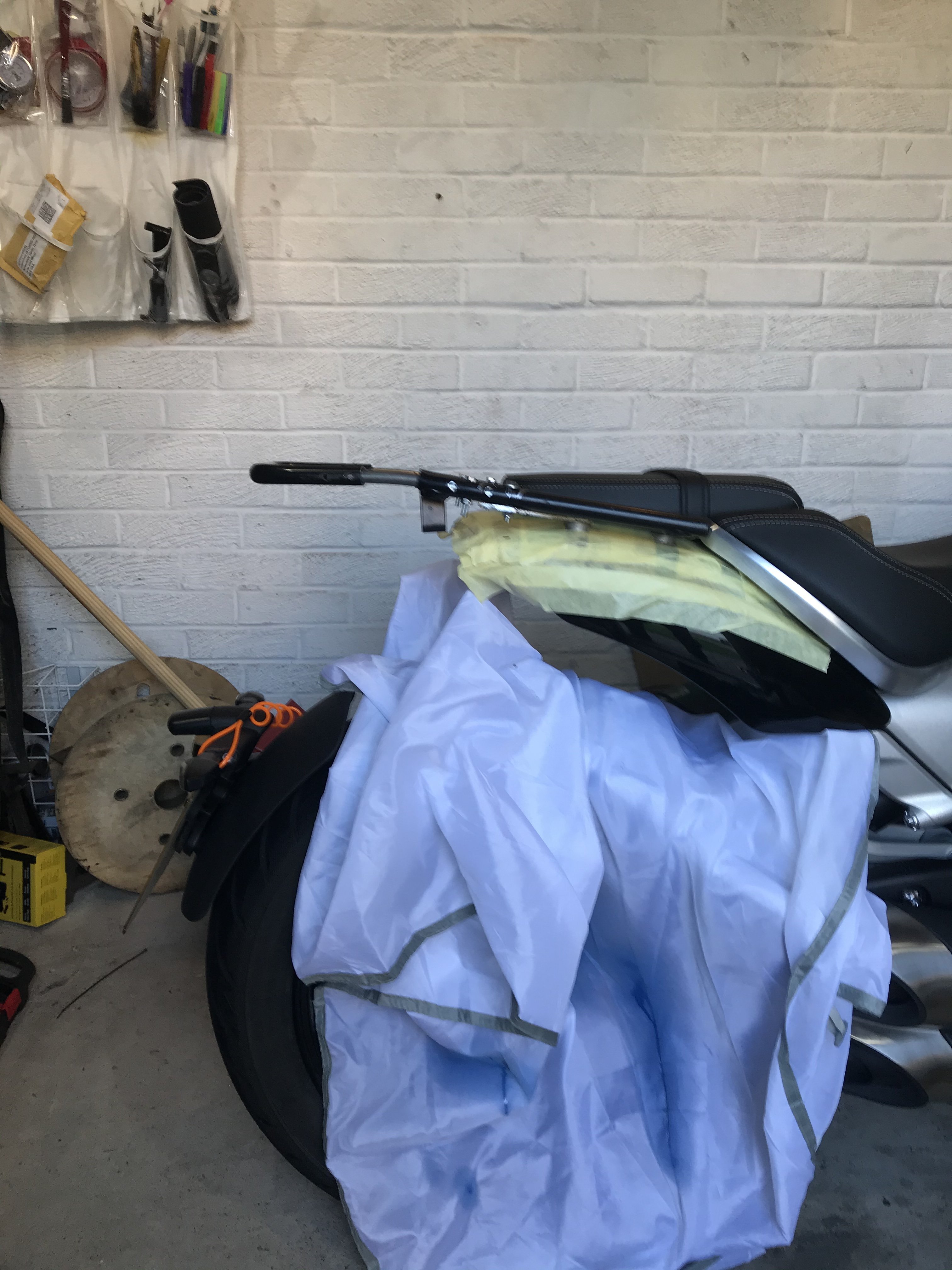

  7. dilligaf
    Cut some flat bar and made the two rear mounts :)
    Bolted together for the time being it’s absolutely solid as a rock :cool:
    Anyone got a MIG welder that they can drop off for me :( FAE223A8-4DBD-4058-848A-ECF79C7D08DC.jpeg
