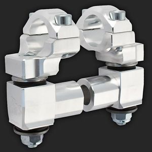

    Secondly I purchased some Rox Anti Vibration Risers type 1R-AV2PP. I bought these from the US on eBay for $170 delivered including import tax. So that's about £125. They took 2 weeks to arrive.
    Very easy to fit, remove 4 bolts, replace 4 bolts, then 4 new bolts - Job done in 10-15 minutes. No problem with cables. - Vibration almost totally gone.

    Hi Yolande, I chose the Rox ones as they have an anti-vibration version. Basically a couple of rubber bushes dampen the vibrations (see picture below). I haven't come across similar ones made by Triumph. Certainly not for the Explorer. No problem with cable length as there is plenty of give in the existing cables. Only took about 15 min to fit.
