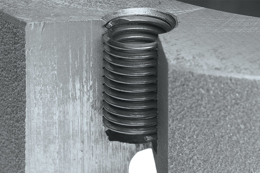

    The mounting bracket which was holding the rear brake calliper to the bike was taking pressure and damage from a faulty bolt and a misalignment. So the mounting from the bike the calliper got damaged and stripped hence rending a change of bold useless as it would not tighten anything. Instead of replacing the whole mounting bracket and calliper (not sure I understand this part) in order to come back to factory setting they managed to re drill the hole and use a "helicoil" whatever to secure the whole mounting. (agin my lack of knowledge deserves me I know)

    Helicoil......drillling out the old bolt makes a big hole. A helicoil allows you to cut a new exterior thread in the hole and insert the helicoil with an internal thread the same size as the original bolt.....
