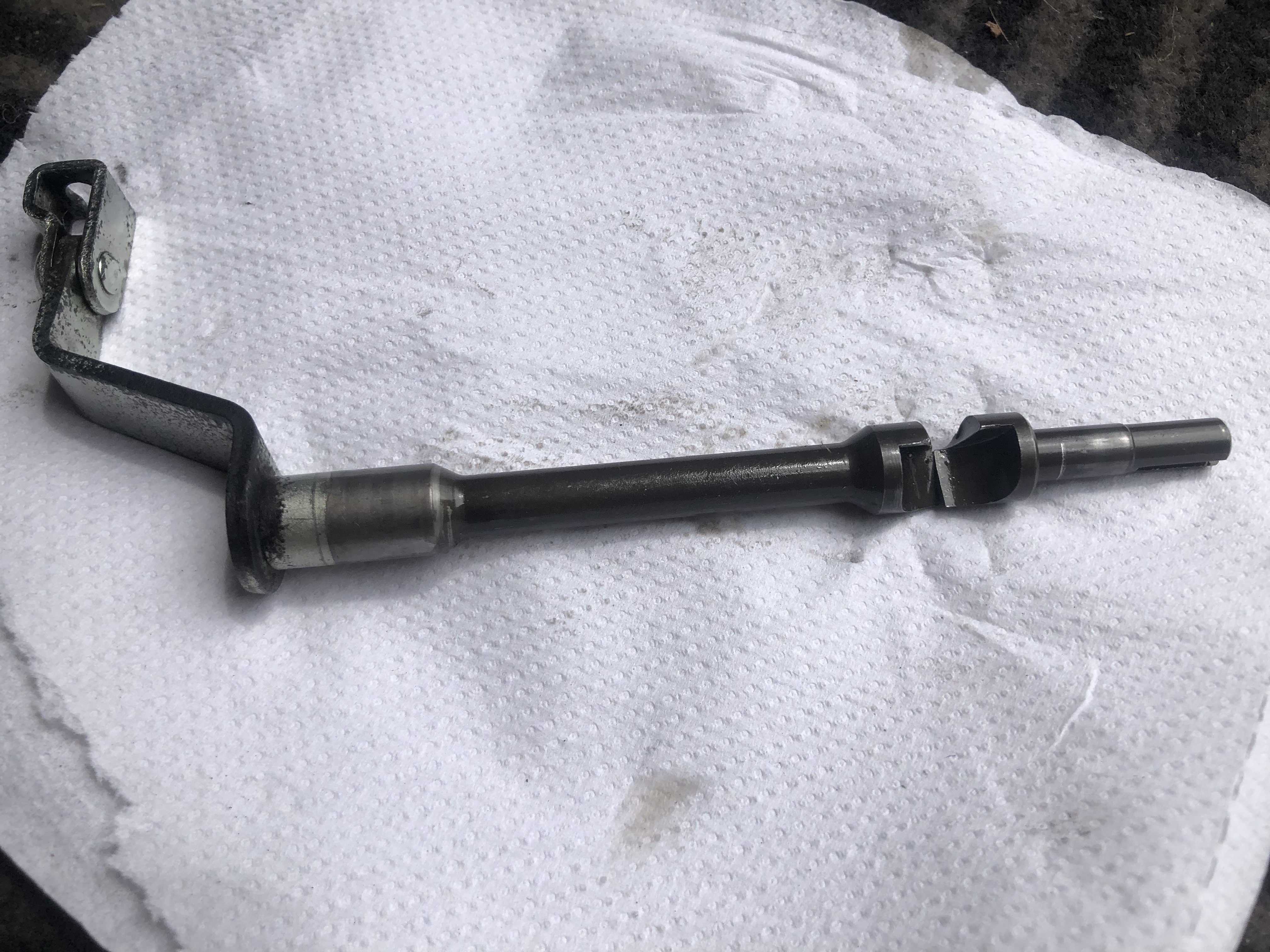

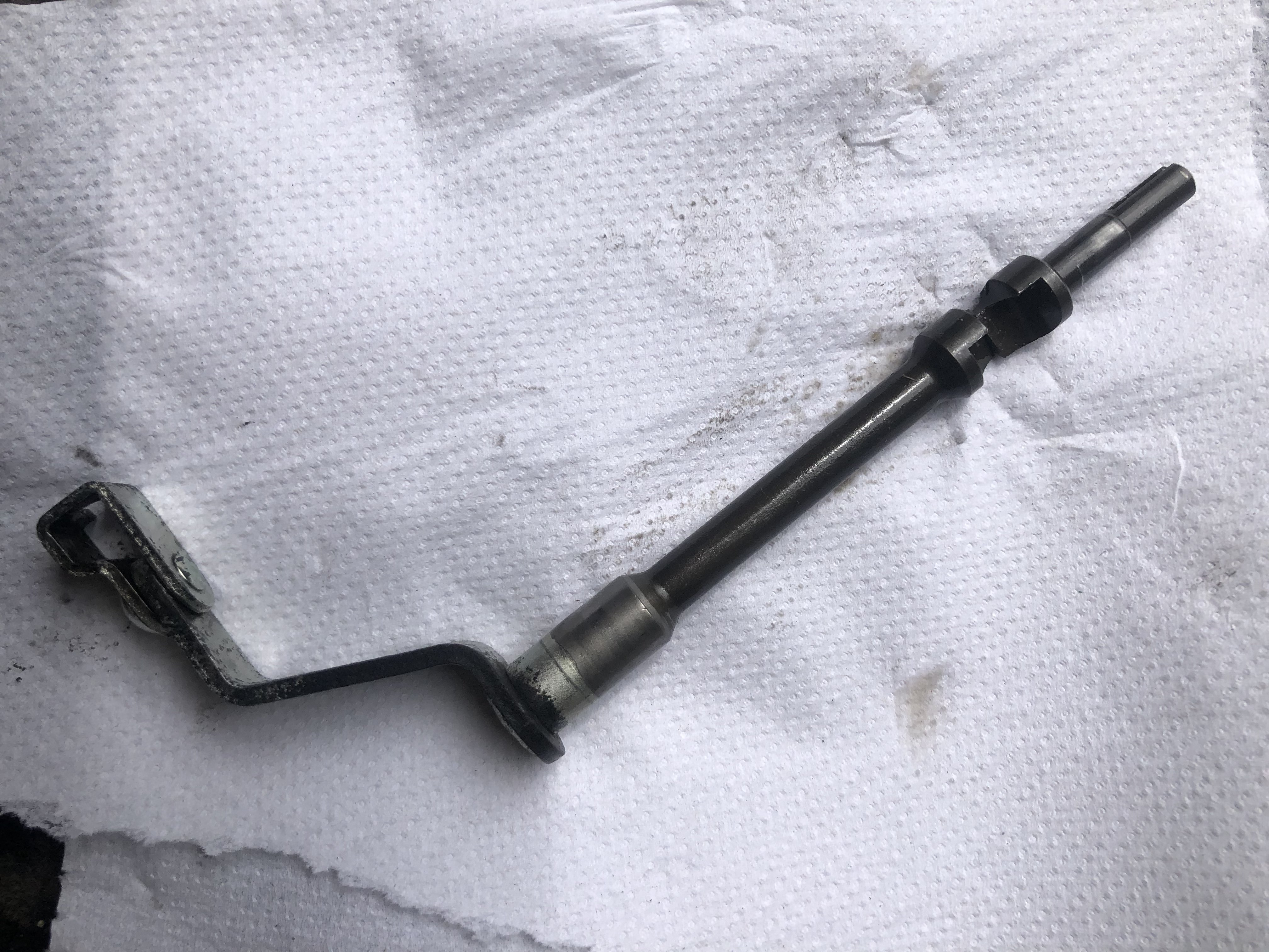

    Just looking for confirmation on a part before I order it, I have accidentally snapped the arm lifter clutch I think it’s called,
    The 1st few pictures are the snapped part.

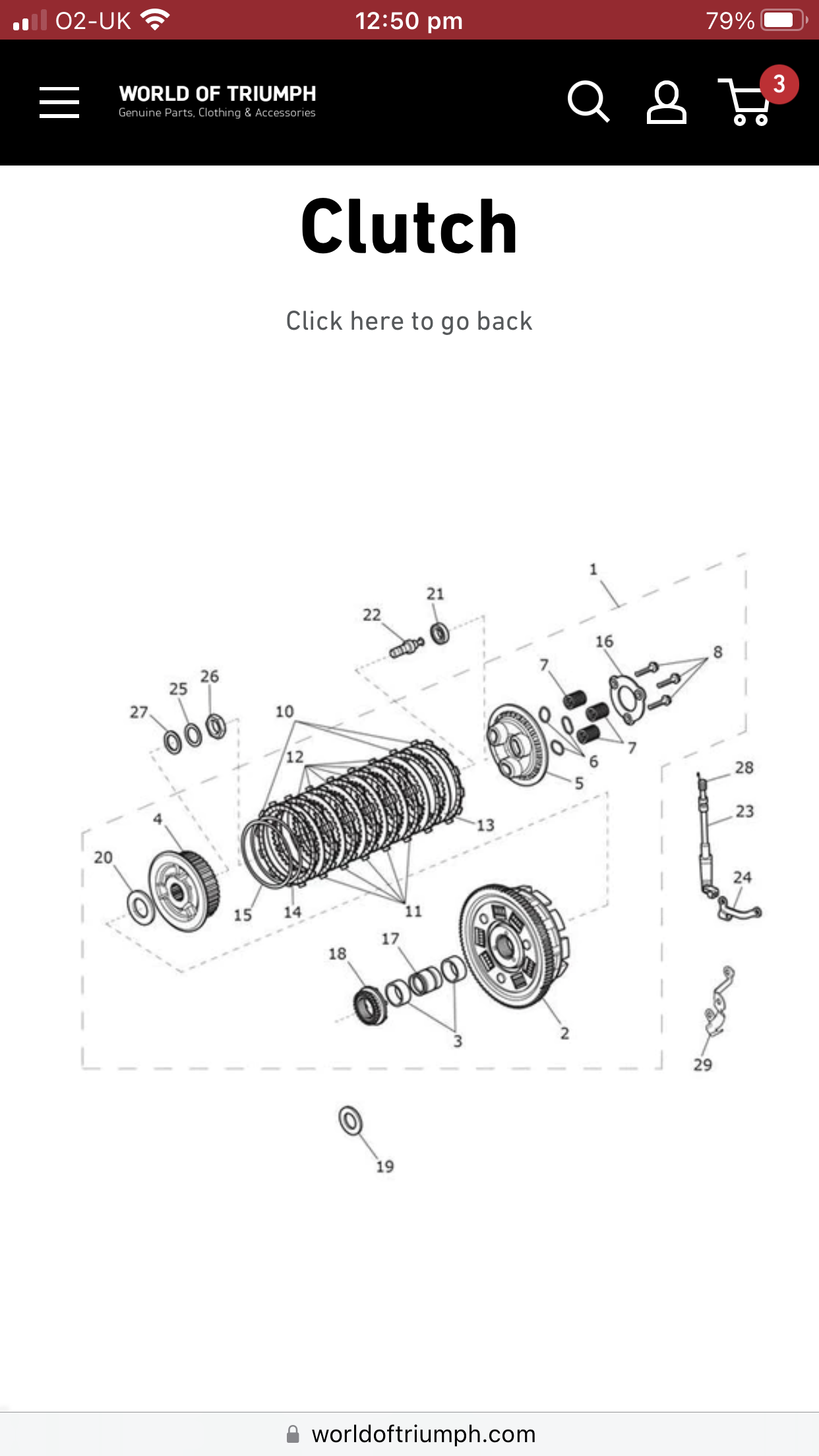

    The diagram I think I need number 23 and the spring 28.

  2. Linx
    Linx Well-Known Member
    Mar 14, 2020
    197
    Stratford Upon Avon, UK
    My God how did you manage to snap that? :joy: Yes 23 in the pic.

  4. Rkt120
    Rkt120 Well-Known Member
    Oct 18, 2020
    169
    83
    Wiltshire
    Just a little update the part arrived perfect I will just fit it as I have snapped one so I now know how not to brake it….. ummm how wrong was I so that’s 2 broke even better I have the mot Thursday and a bike that doesn’t work so I have to try and order a new one, been here before then do I attempt a 3rd try or do I just push the bike 5miles up hills to get it there and fixed on the day, note to self only change parts that involve a straight swap with possible screws to undo.

  6. Eldon
    Eldon Elite Member
    4,181
    How you managing to break them?
    Didn't the 1st breakage provide better insight :rolleyes: into the design and layout?
  7. Rkt120
    Oct 18, 2020
    169
    83
    Wiltshire
    Putting the clutch cover on, the first time it did indeed give me a good insight into it so I did things differently on the second one so not the same mistake, so from elimination I don't think there is any other scenarios for it to brake again, but we will see I’m sure I will be saying in a week I’m on attempt 4
  8. Eldon
    Eldon Elite Member
    4,181
    Are you "hooking" the pushrod connection whilst pushing the cover home?
    The lever needs to point the wrong way first so then rotates into the correct position as the gasket faces come together.
    Are you bolting it up unhooked?
    If so its a wonder all the holes don't need helicoiling :confounded:
  9. Rkt120
    Oct 18, 2020
    169
    83
    Wiltshire
    As far as I’m aware I am hooking it on and rotating it as I put the cover on I have watched a few videos on how to do it I’m just thinking I’m not to good at doing it, or I have had faulty parts
