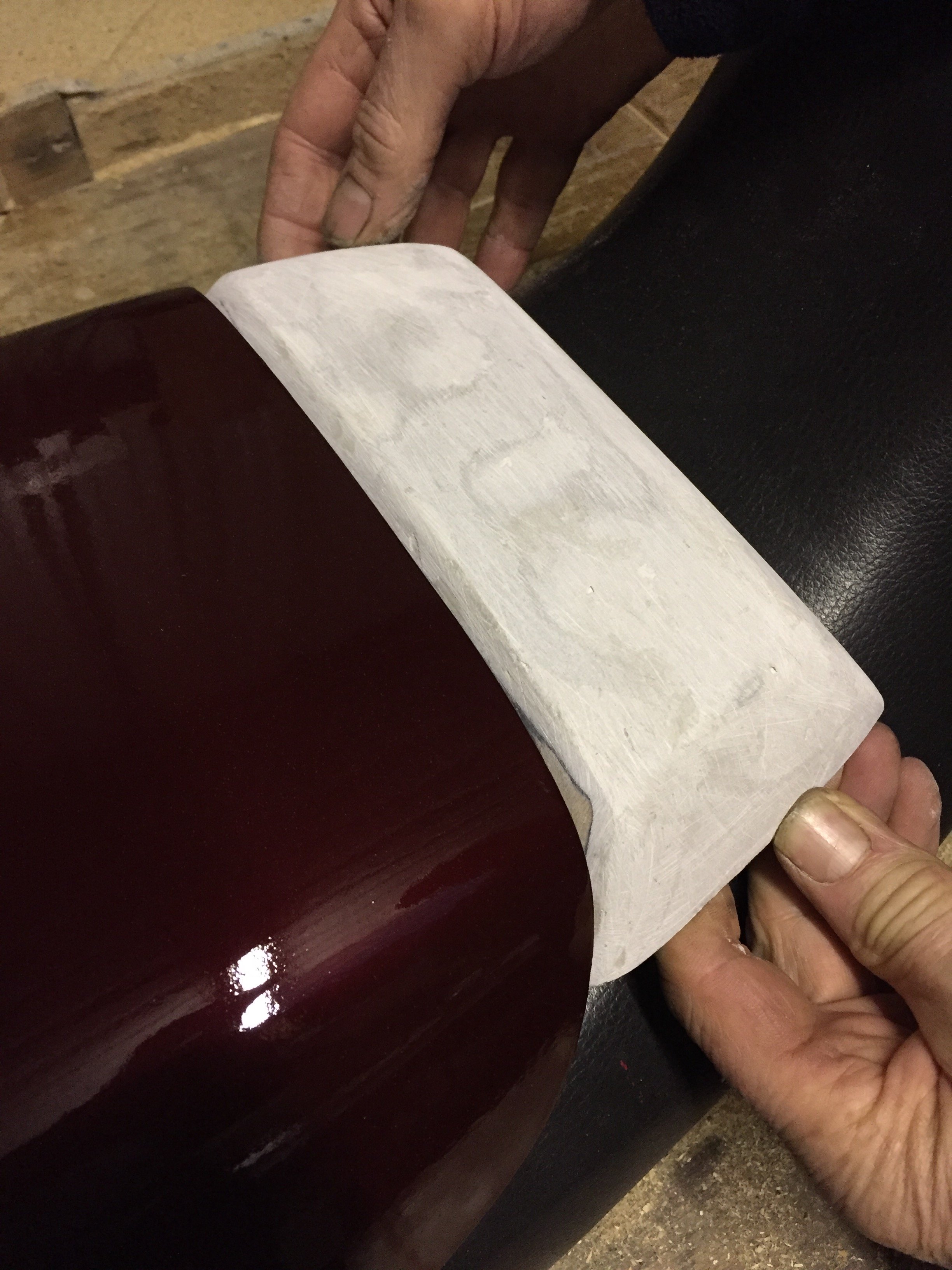

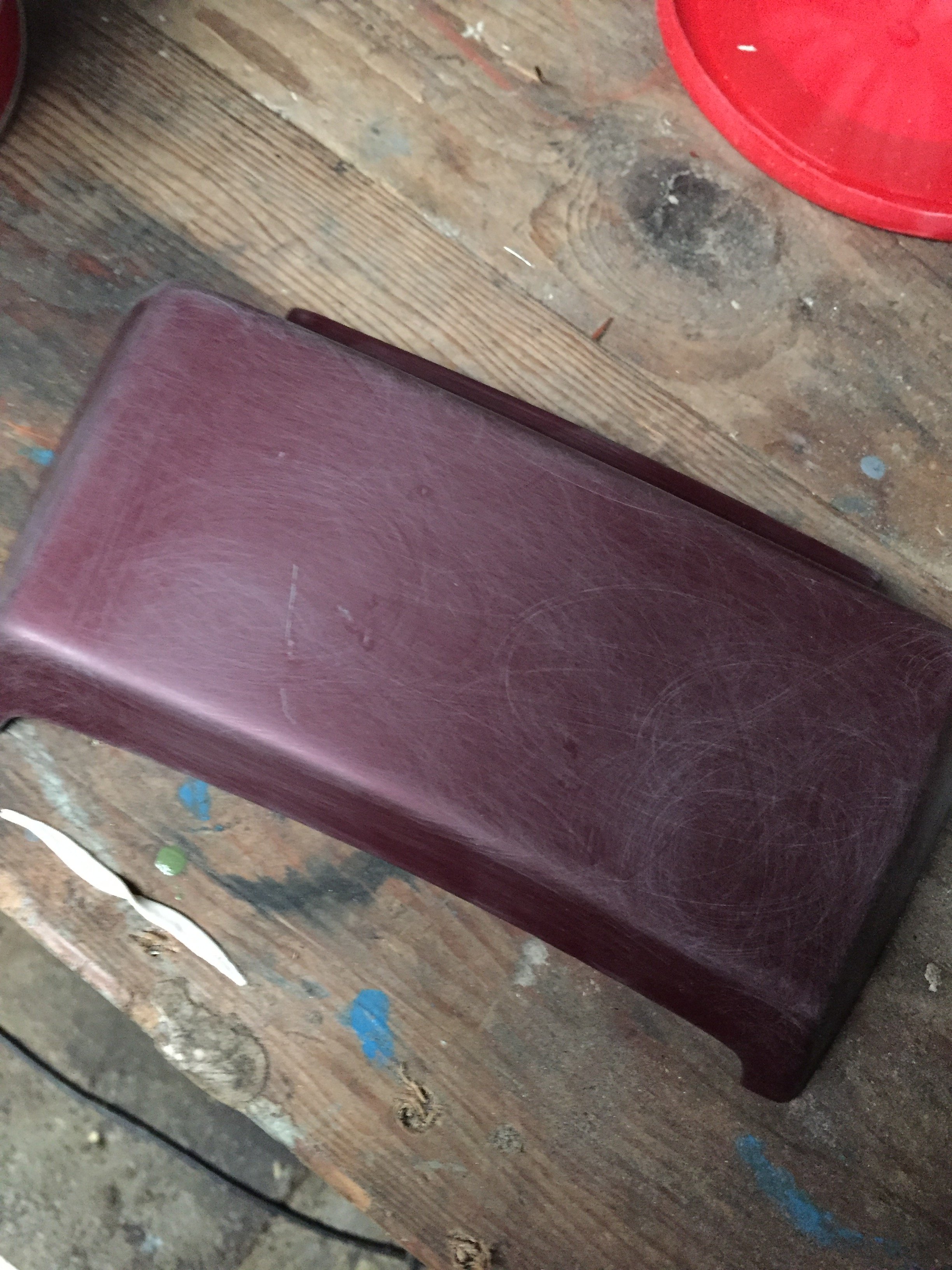

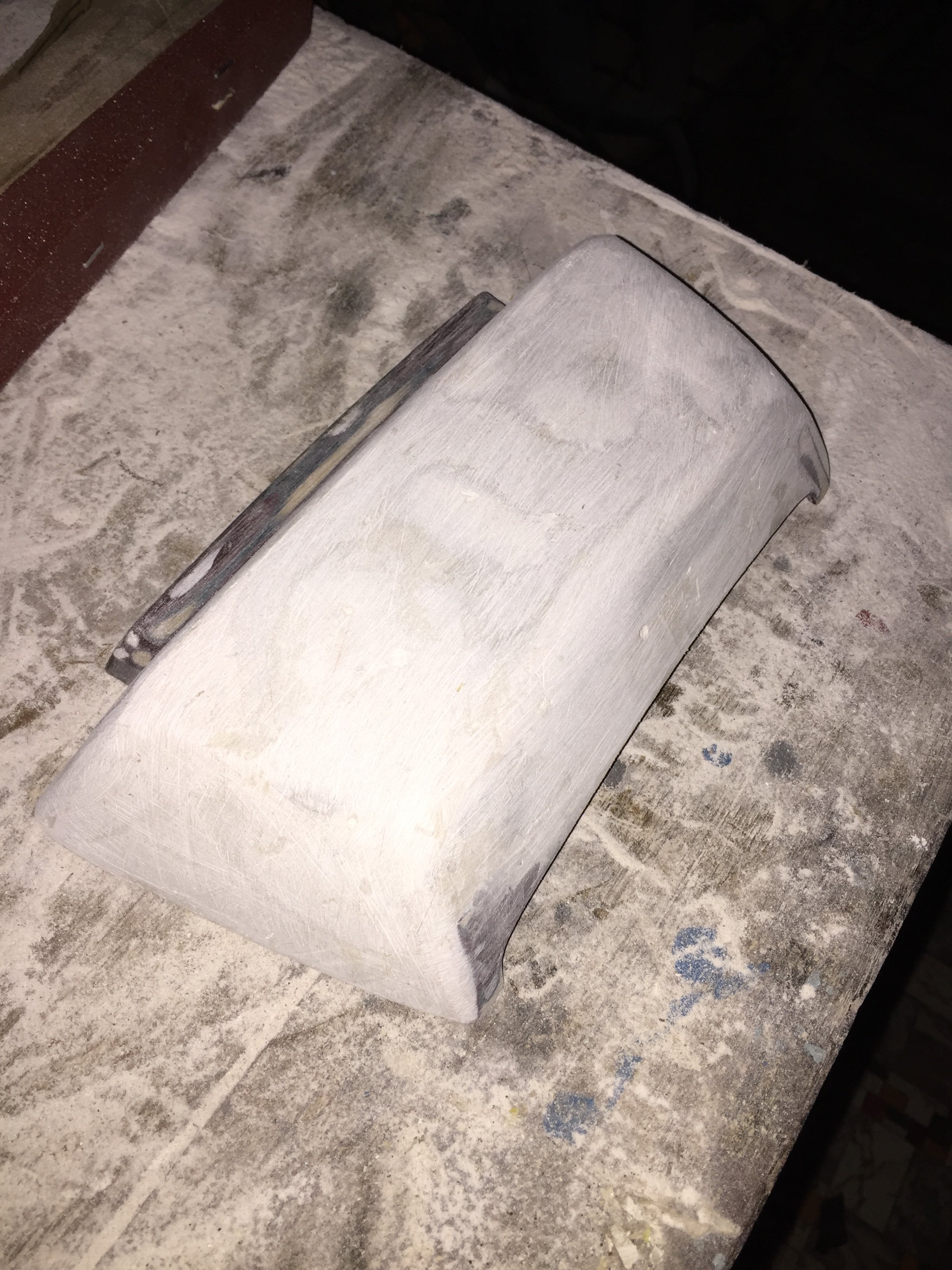

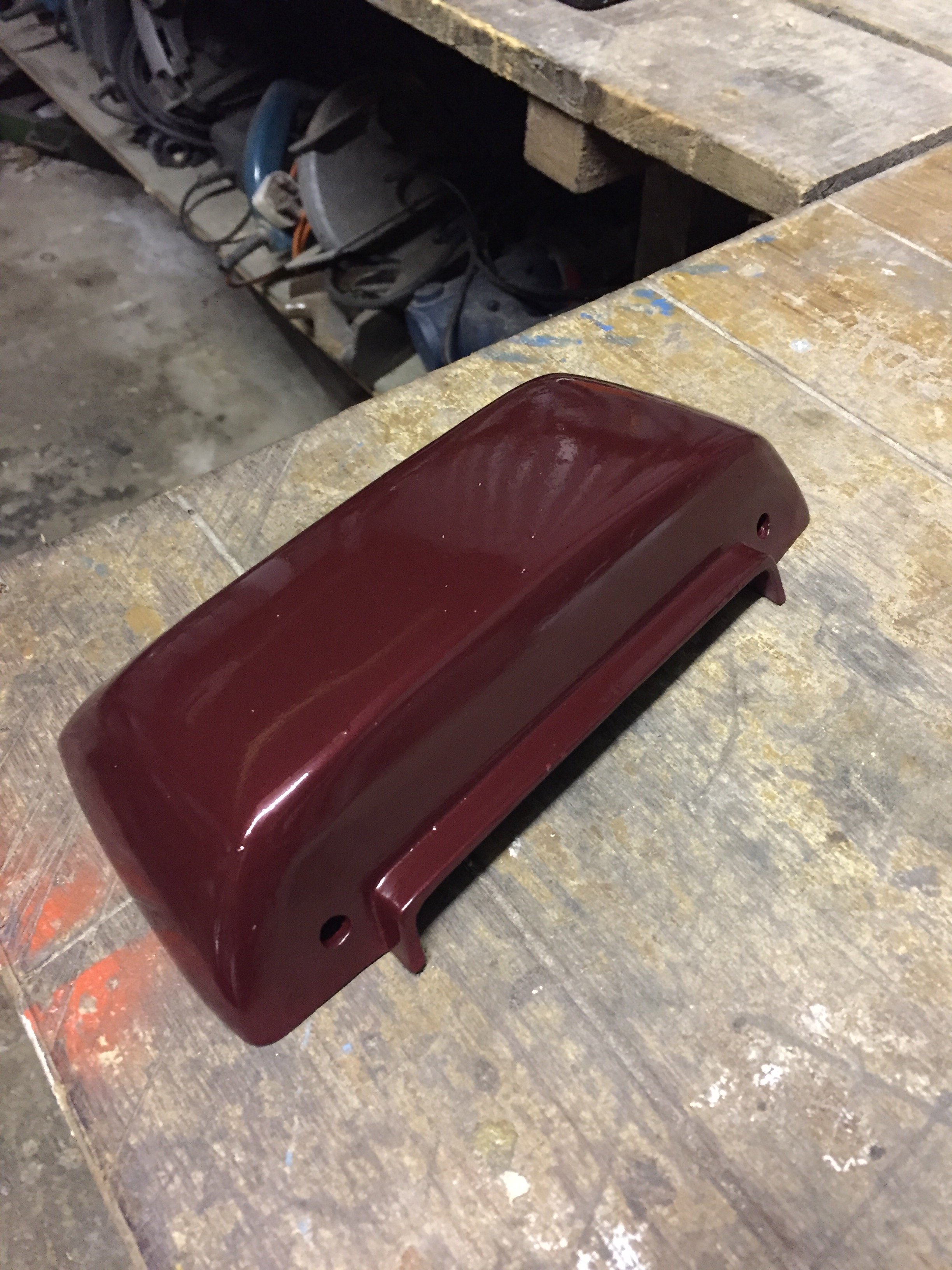

    Hello all,
    Unfortunately, I had initially purchased a profiler, and then my purchase was cancelled and refunded - emailed them asking why, no response, so I purchased another from another seller. This never arrived and he suggested it got lost in the post so asked me if I wanted a refund, so I did.
    I've gotten a bit impatient so my dad made a similar profile out of wood and offered it against the old trim. I sanded it down and started applying filler..
    Here it is so far. (Wouldn't get a job at Blue Peter that's for sure)
    Still needs to add filler over it and sand it down.

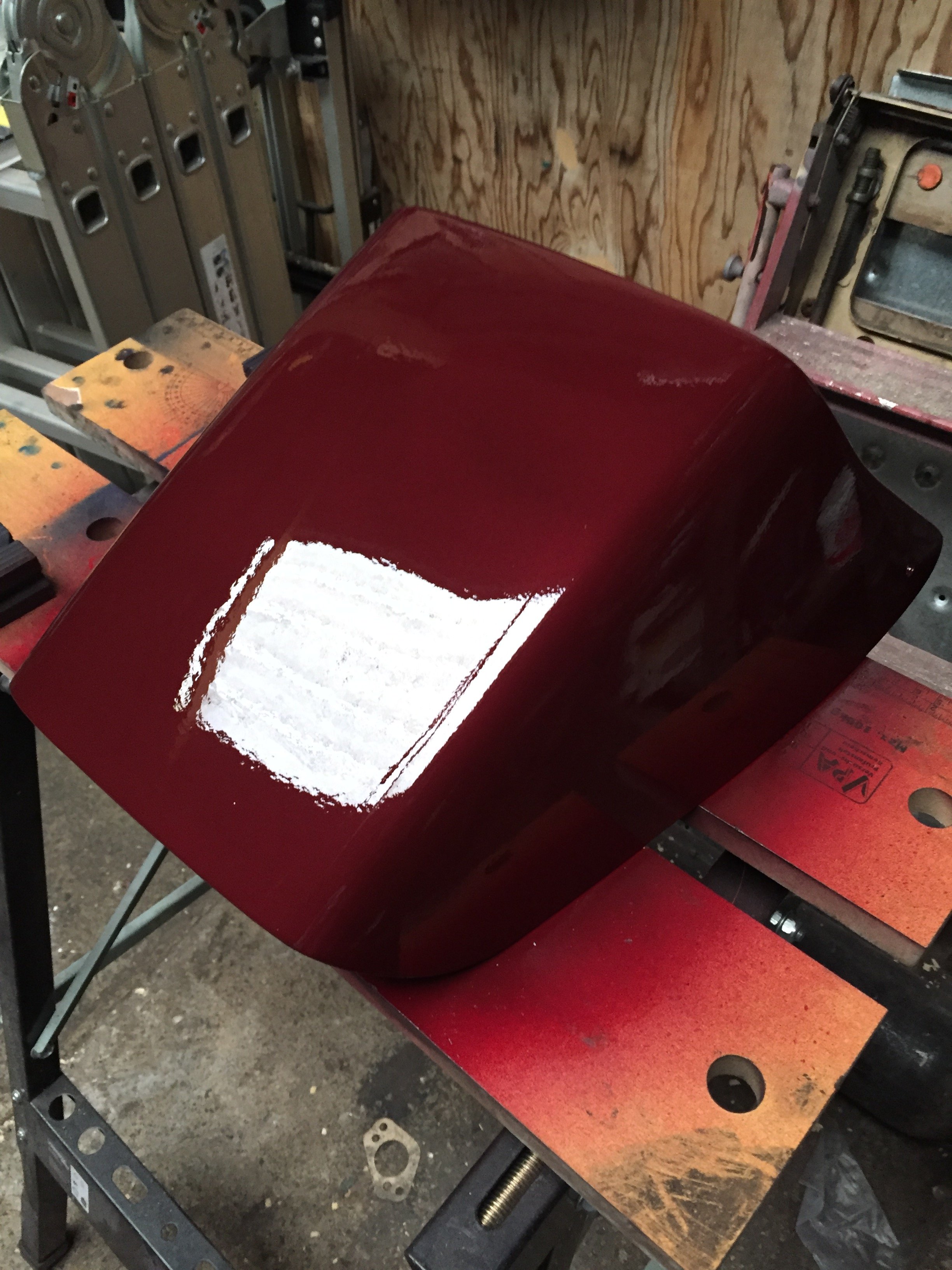

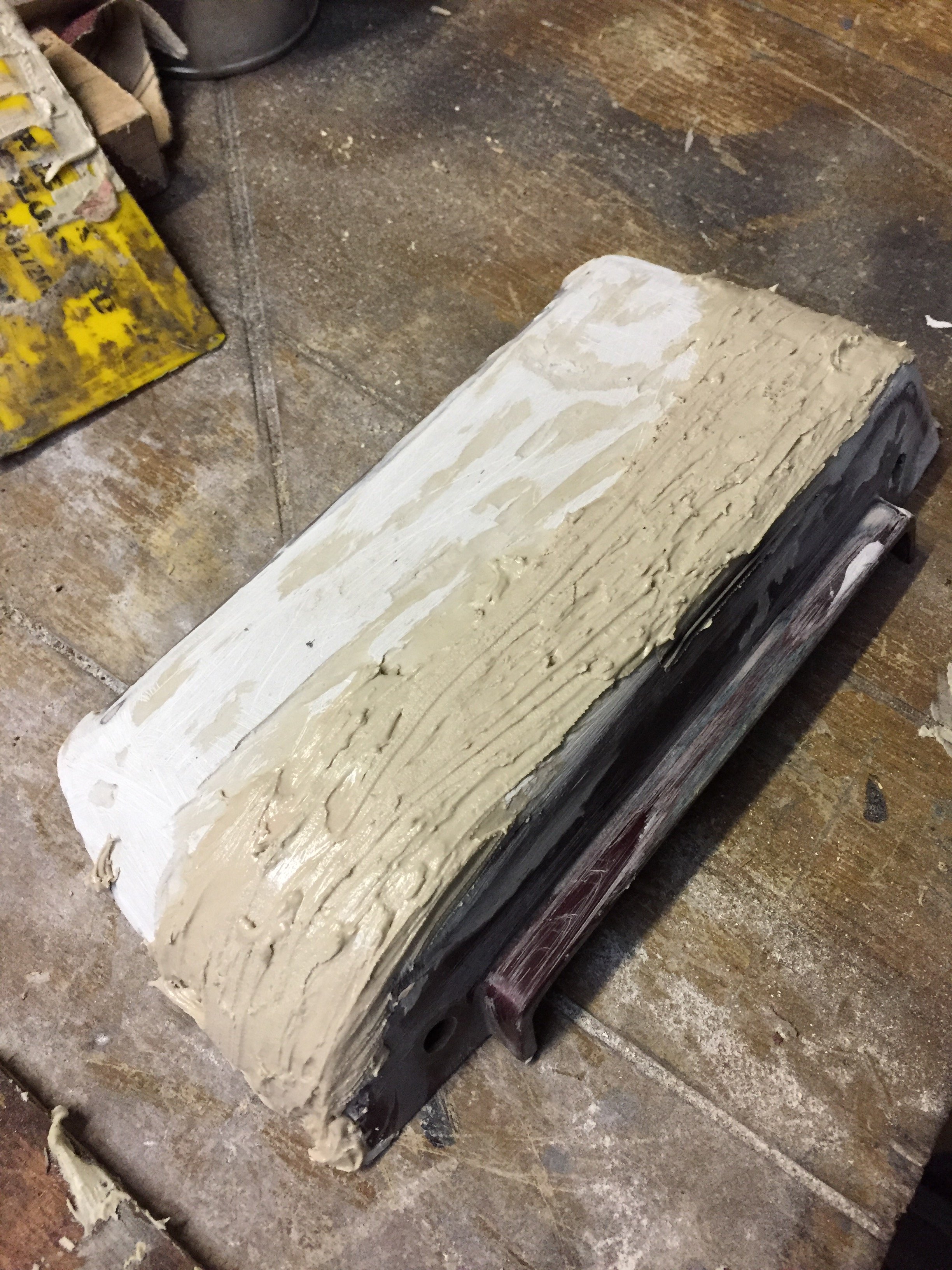

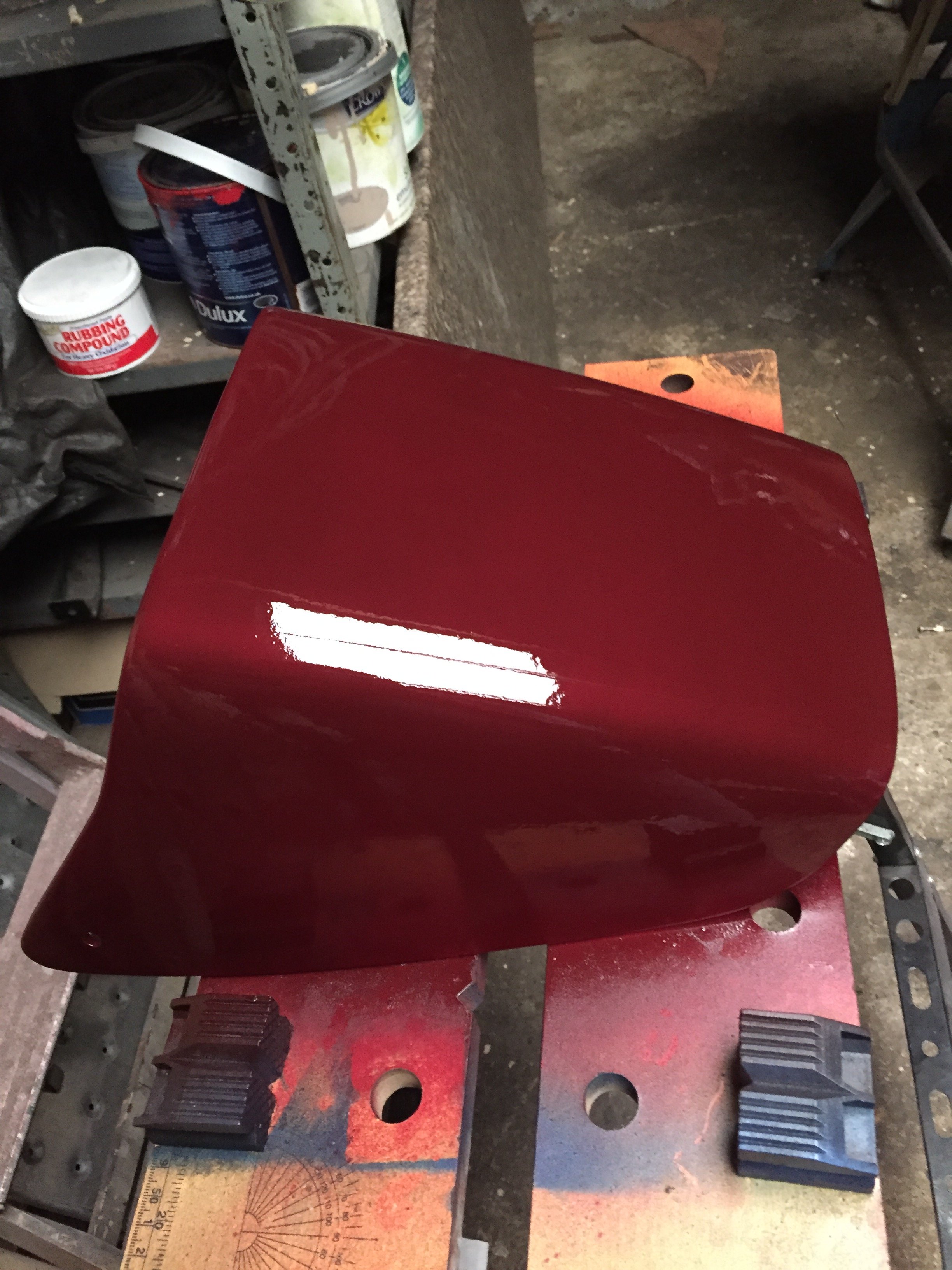

    Added more fill this morning and sanded it down, what a soul destroying job.
    Whilst I let it set I thought I'd paint the cowl. Looks great with only 2 coats....
  13. Kelvin_2202
    Kelvin_2202 Member
    Oct 2, 2016
    26
    North Wales

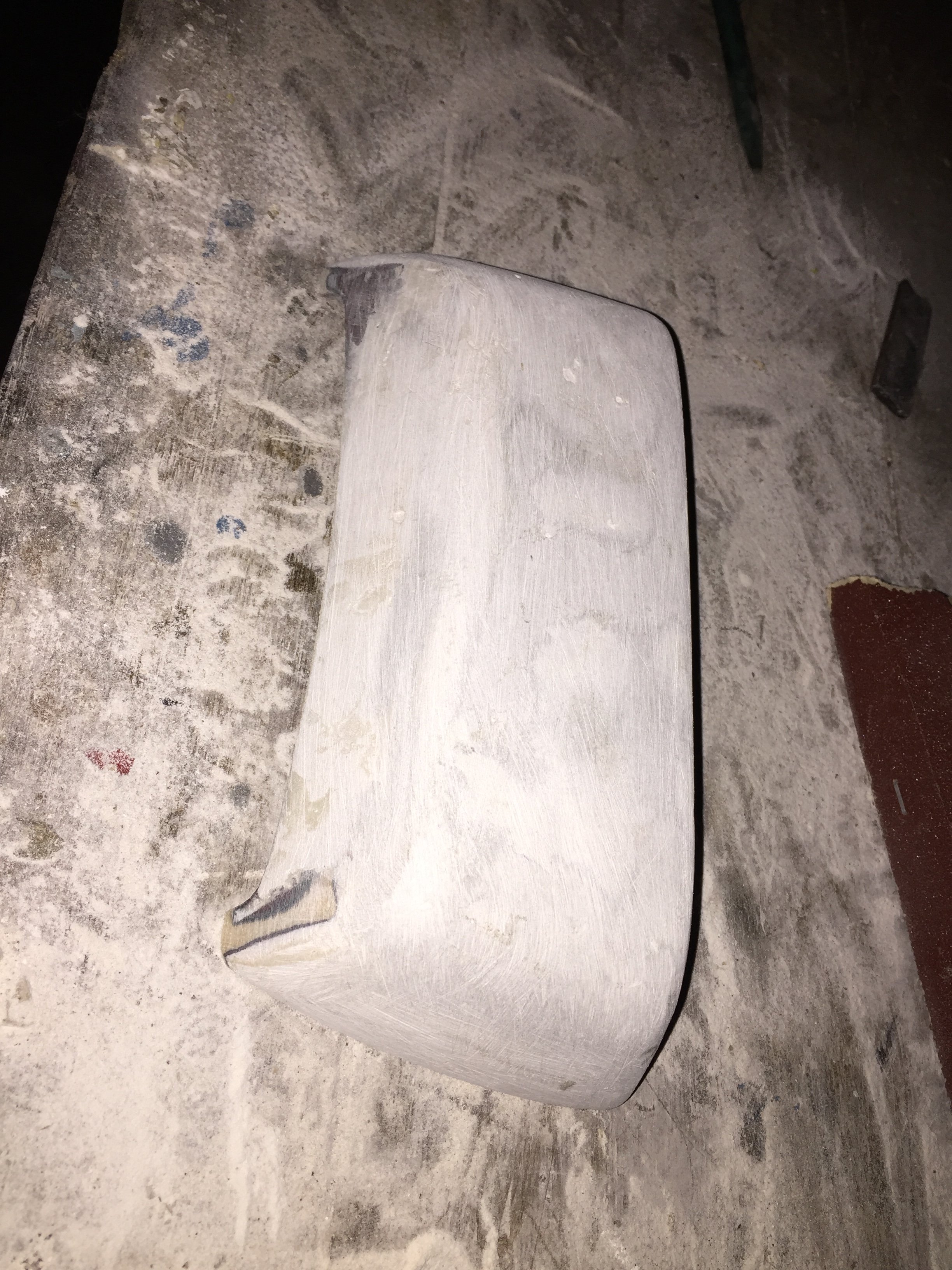

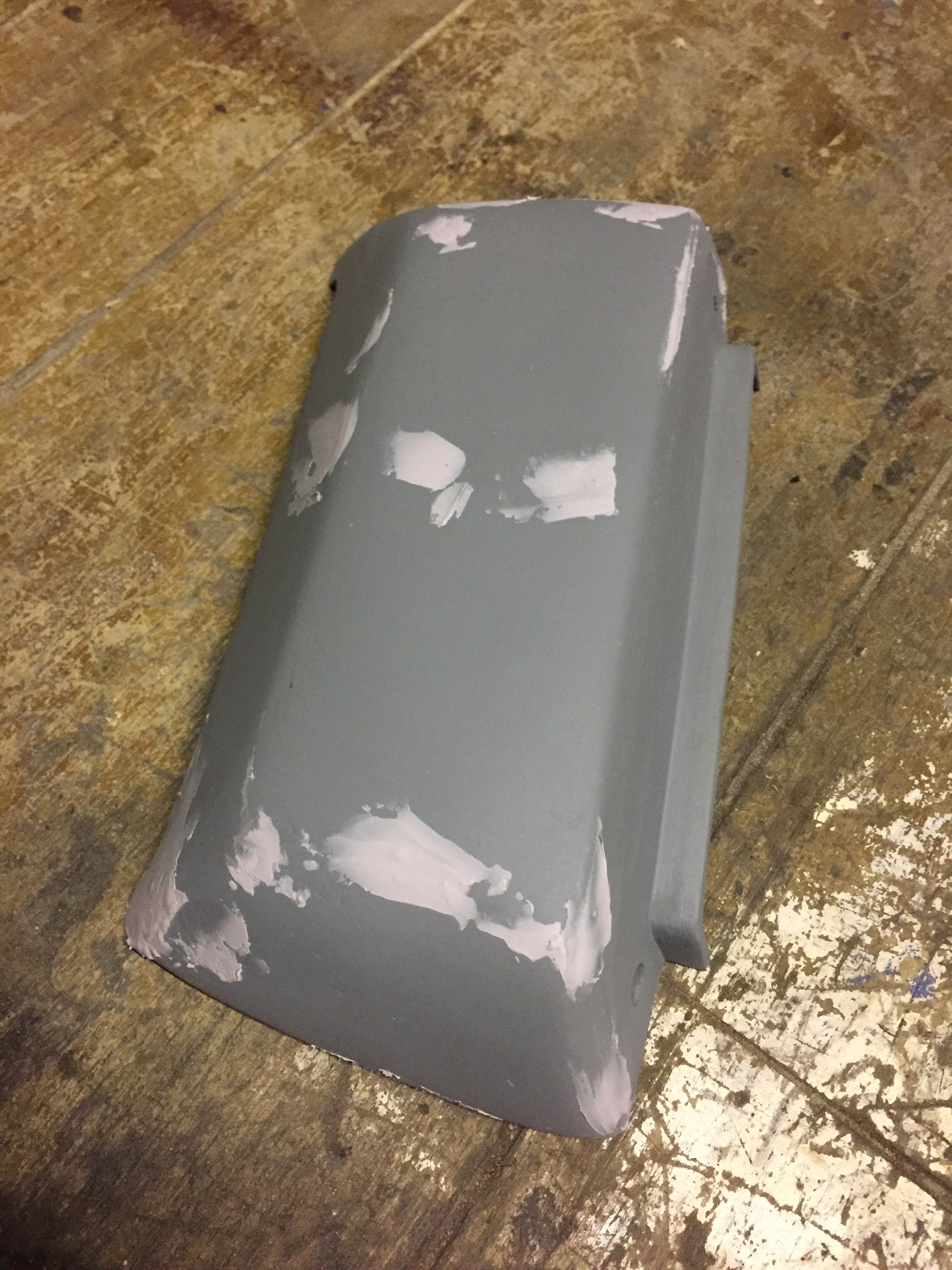

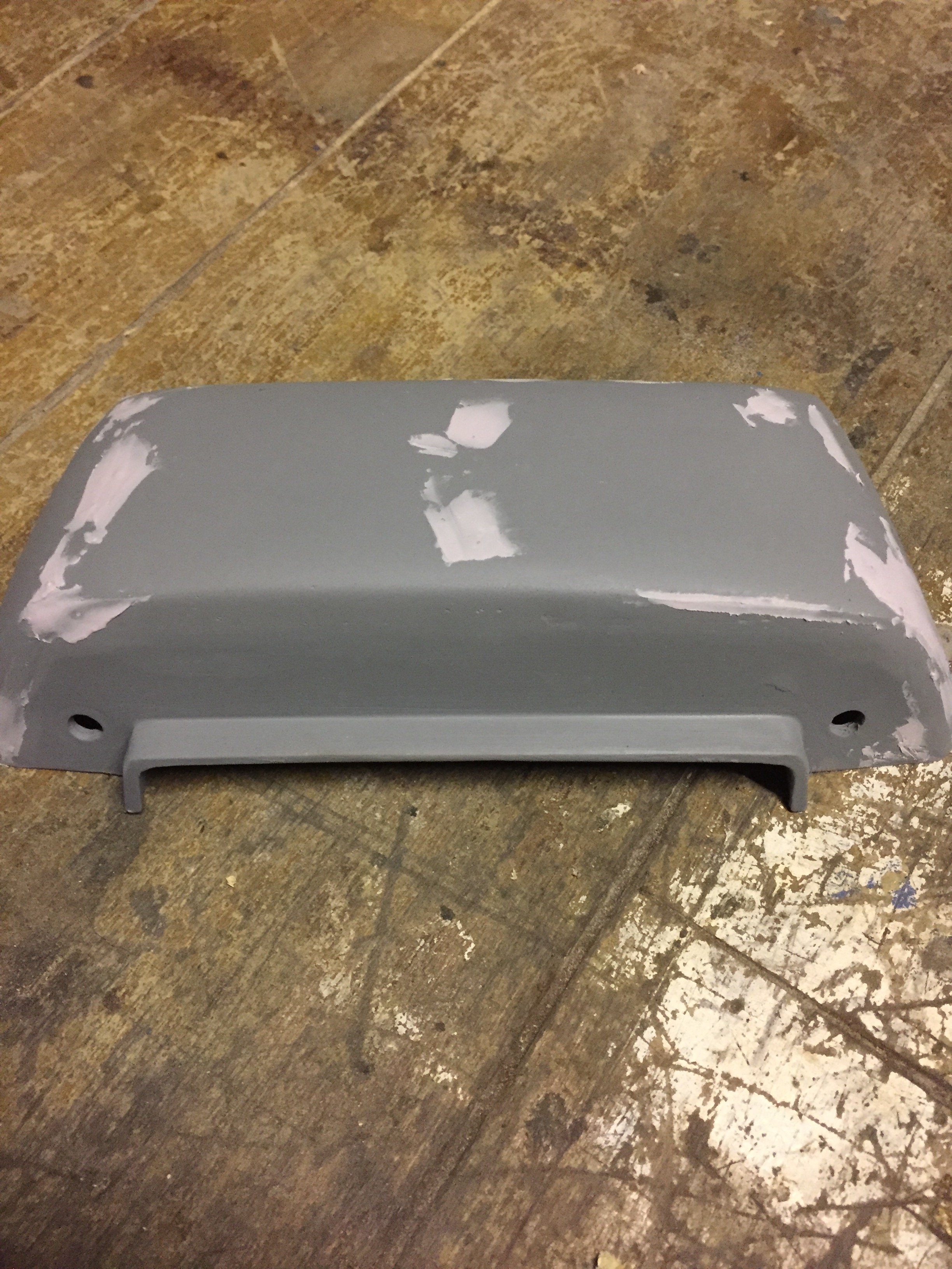

    Its beginning to take shape !
    So close now, just need some stopper to fill in the small craters and we'll be good for some paint.

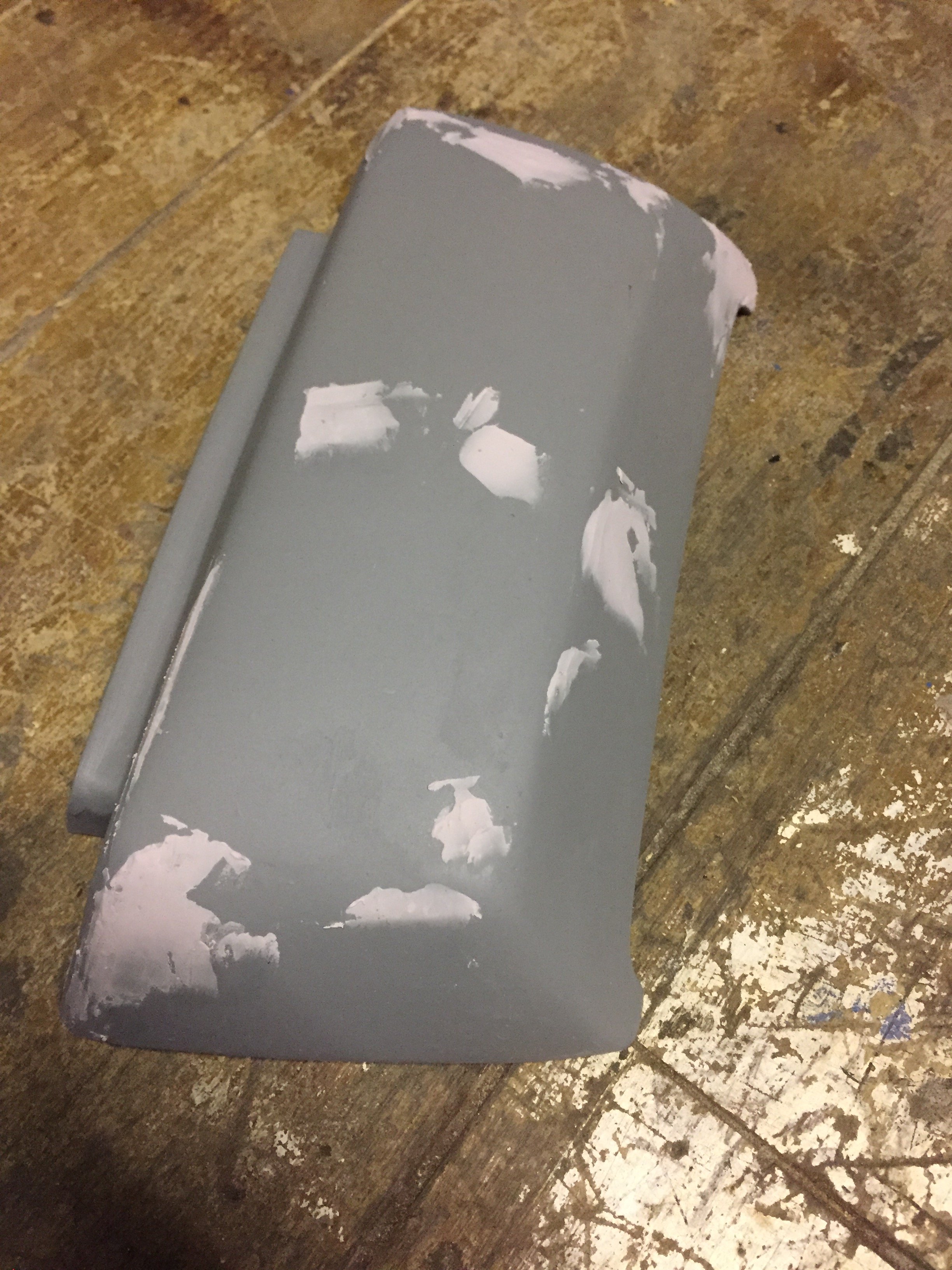

  15. Kelvin_2202
    Kelvin_2202 Member
    Oct 2, 2016
    26
    North Wales

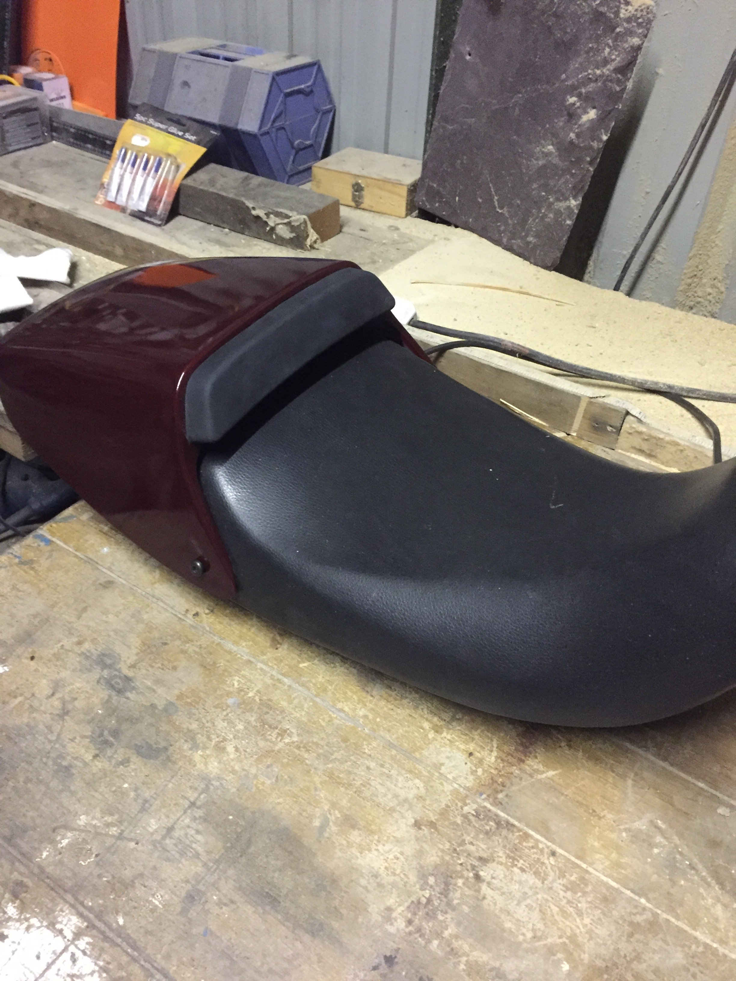

    More sanding, and added a bit more stopper, hopefully that will be the last before paint.
    Also test fitted the cowl on the seat.
    At this rate I'll be finished before winter properly begins!
    Cheers,

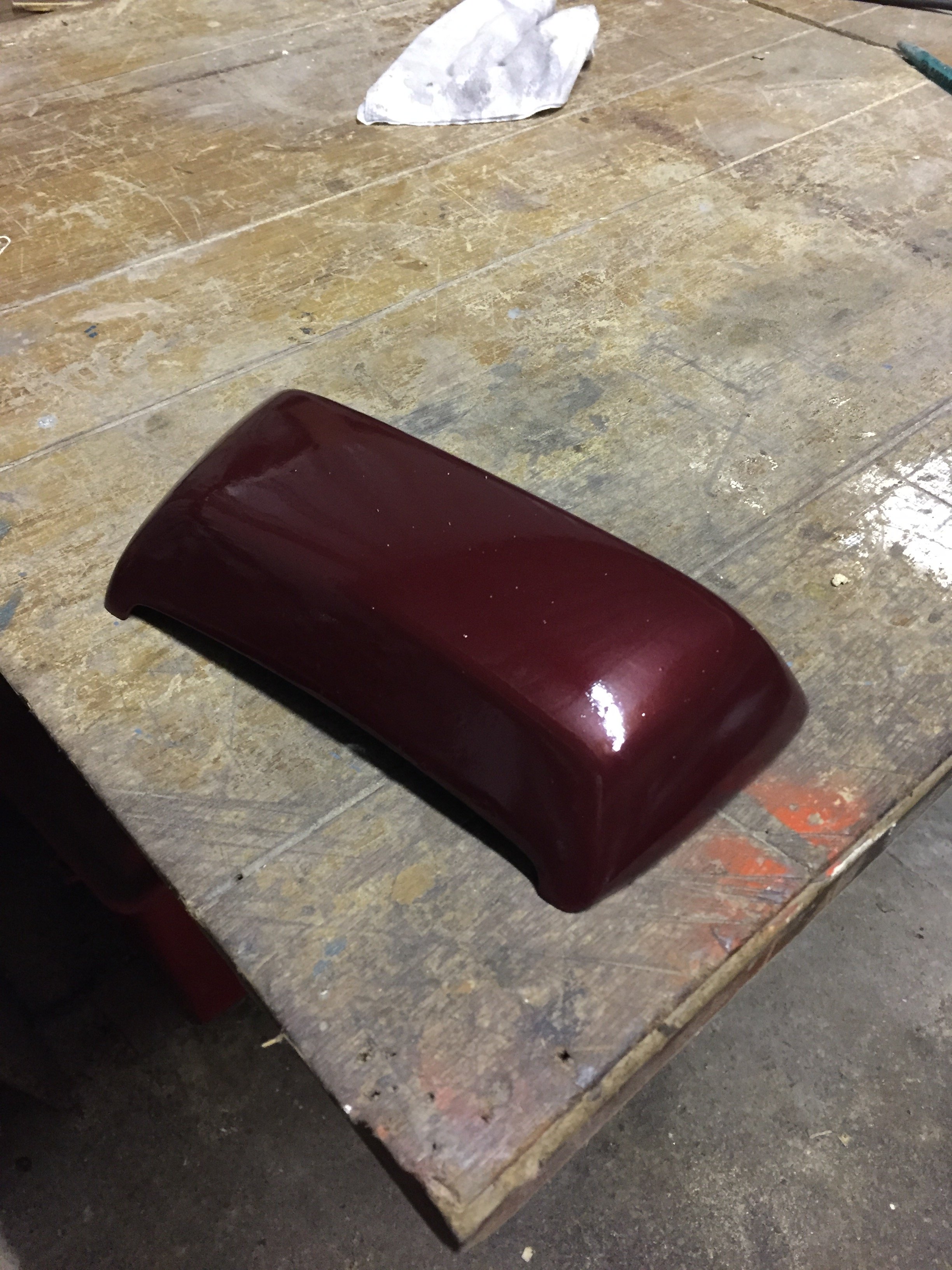

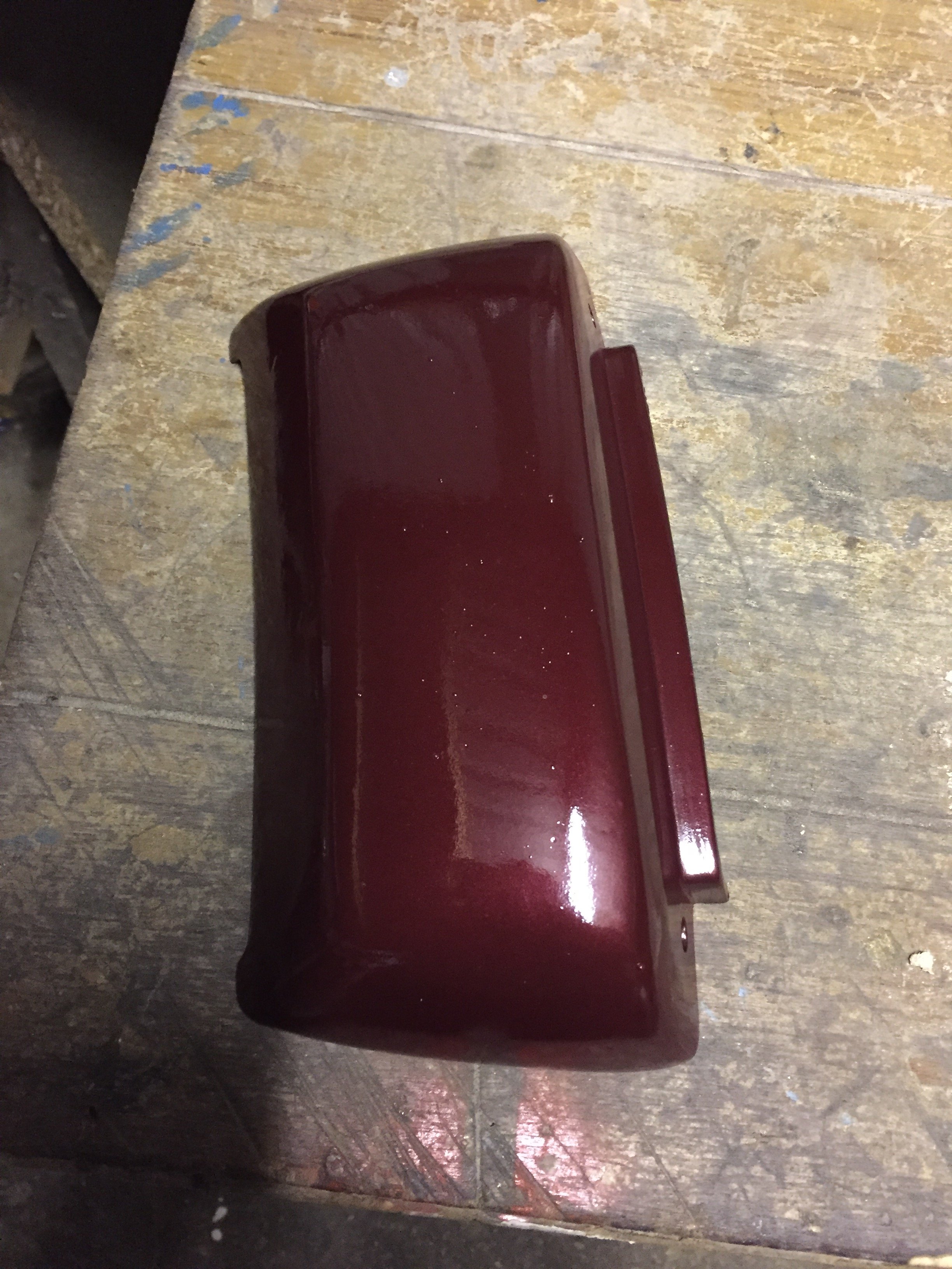

  16. Kelvin_2202
    Kelvin_2202 Member
    Oct 2, 2016
    26
    North Wales
    Final coat and it will be all ready to fit !

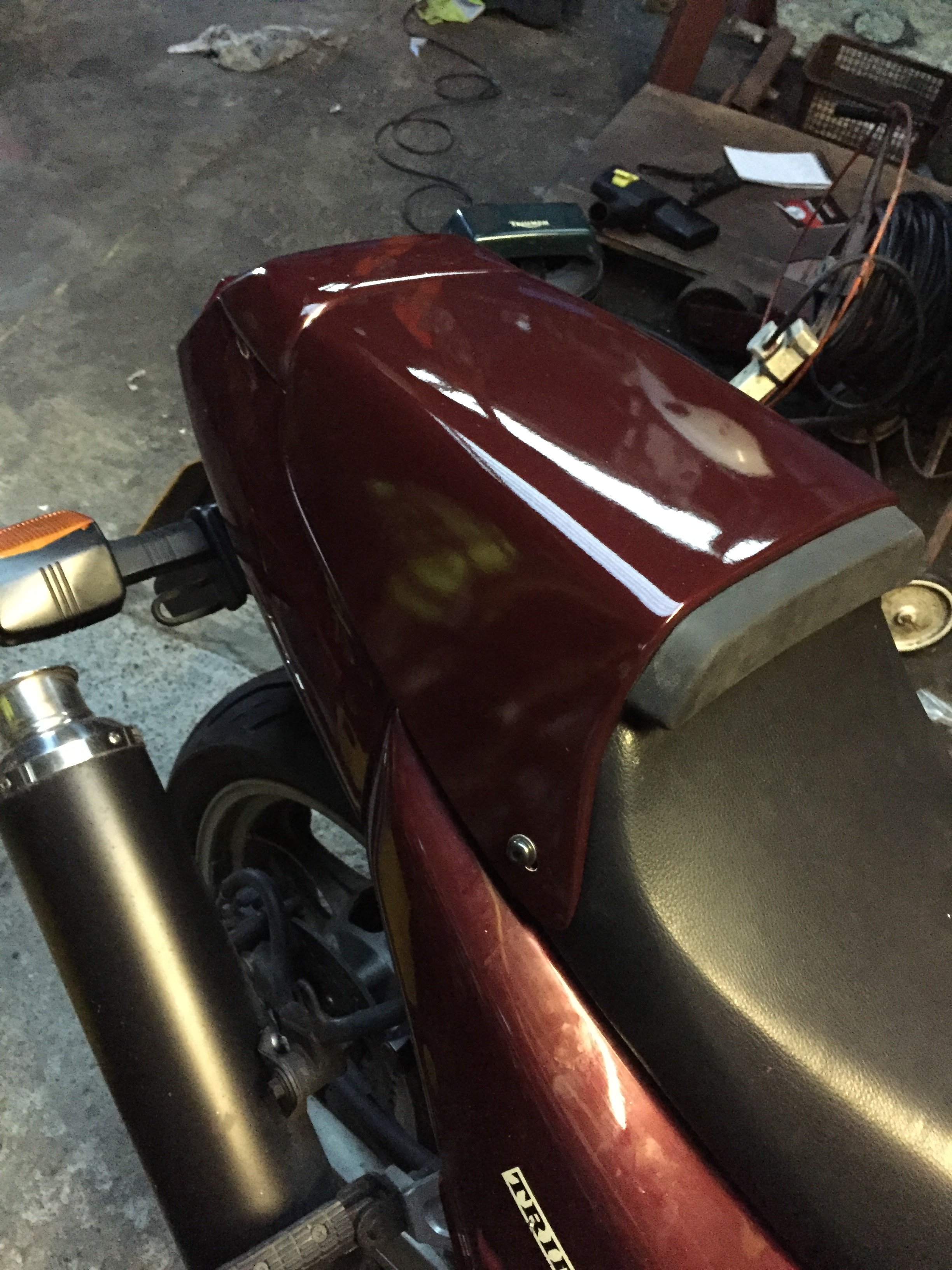

  17. Kelvin_2202
    Kelvin_2202 Member
    Oct 2, 2016
    26
    North Wales

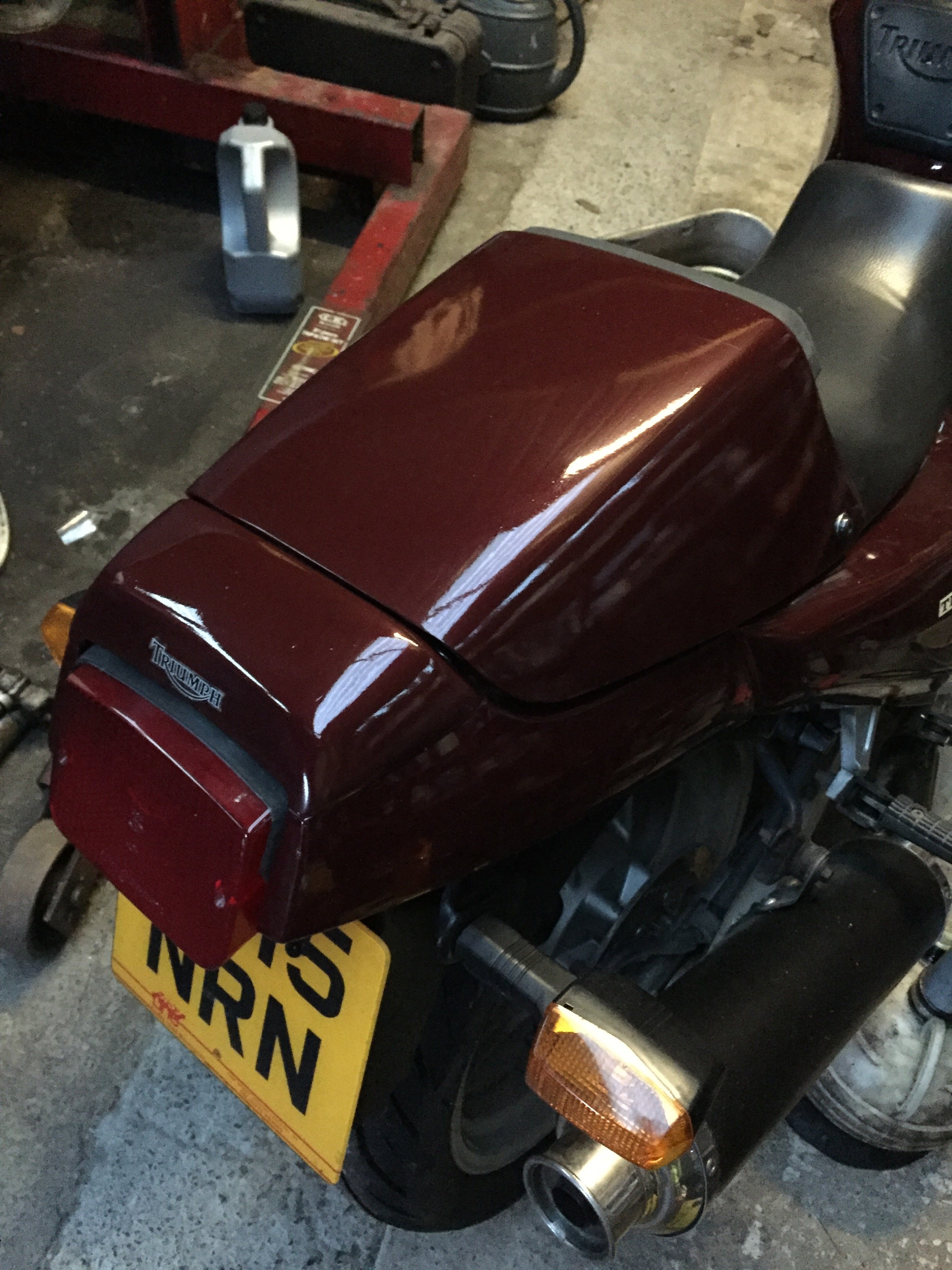

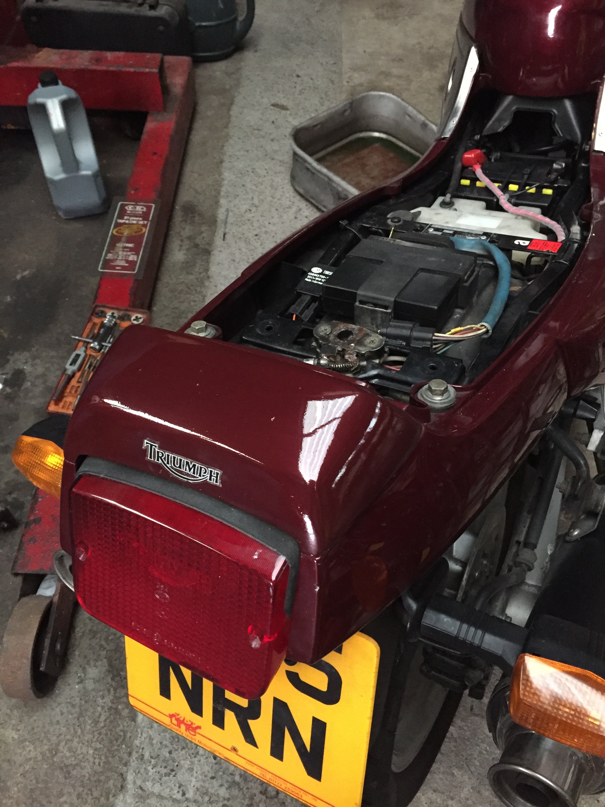

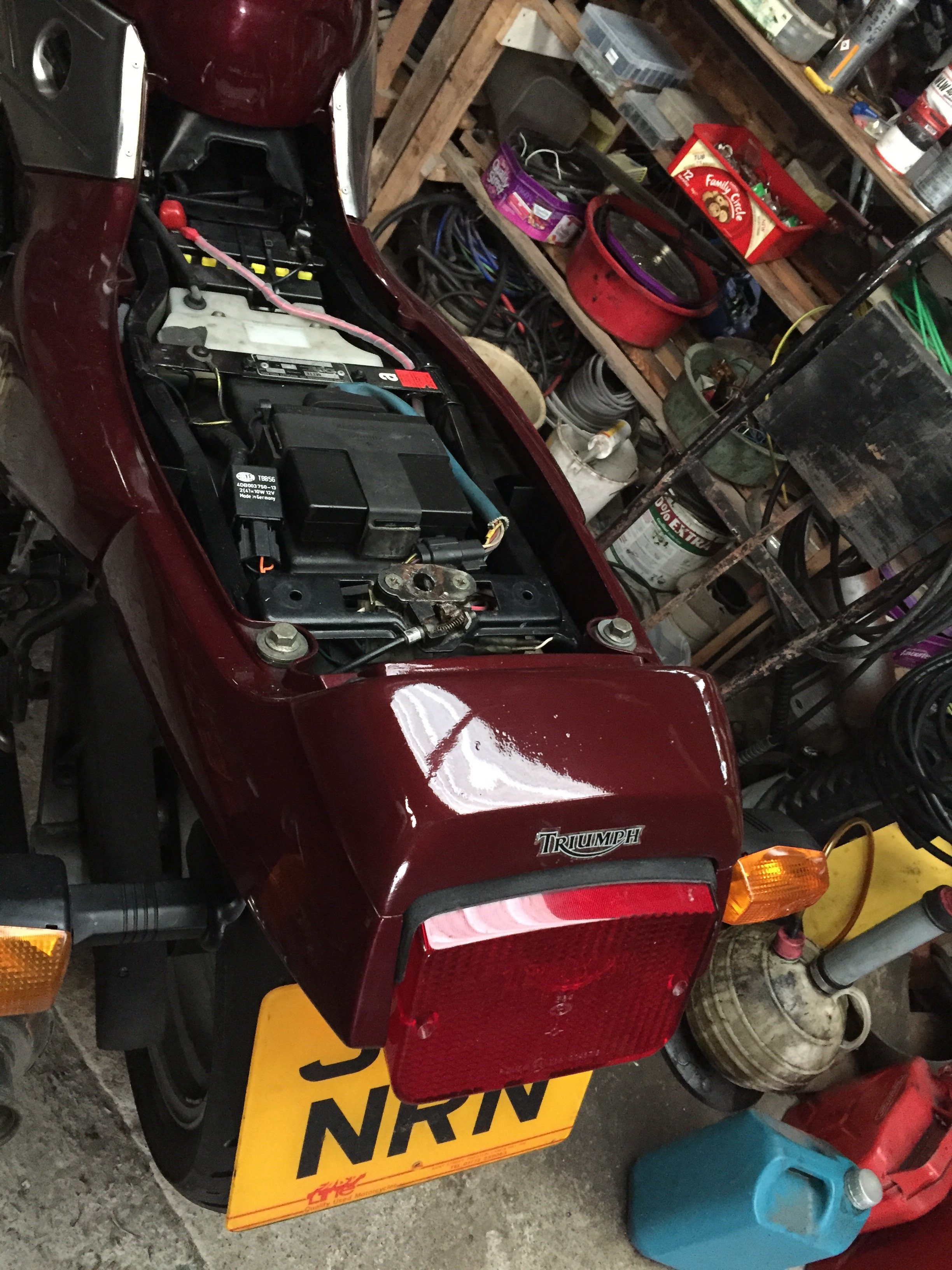

    Fitted !
    Can't believe how great it looks, almost looks like a standard item!

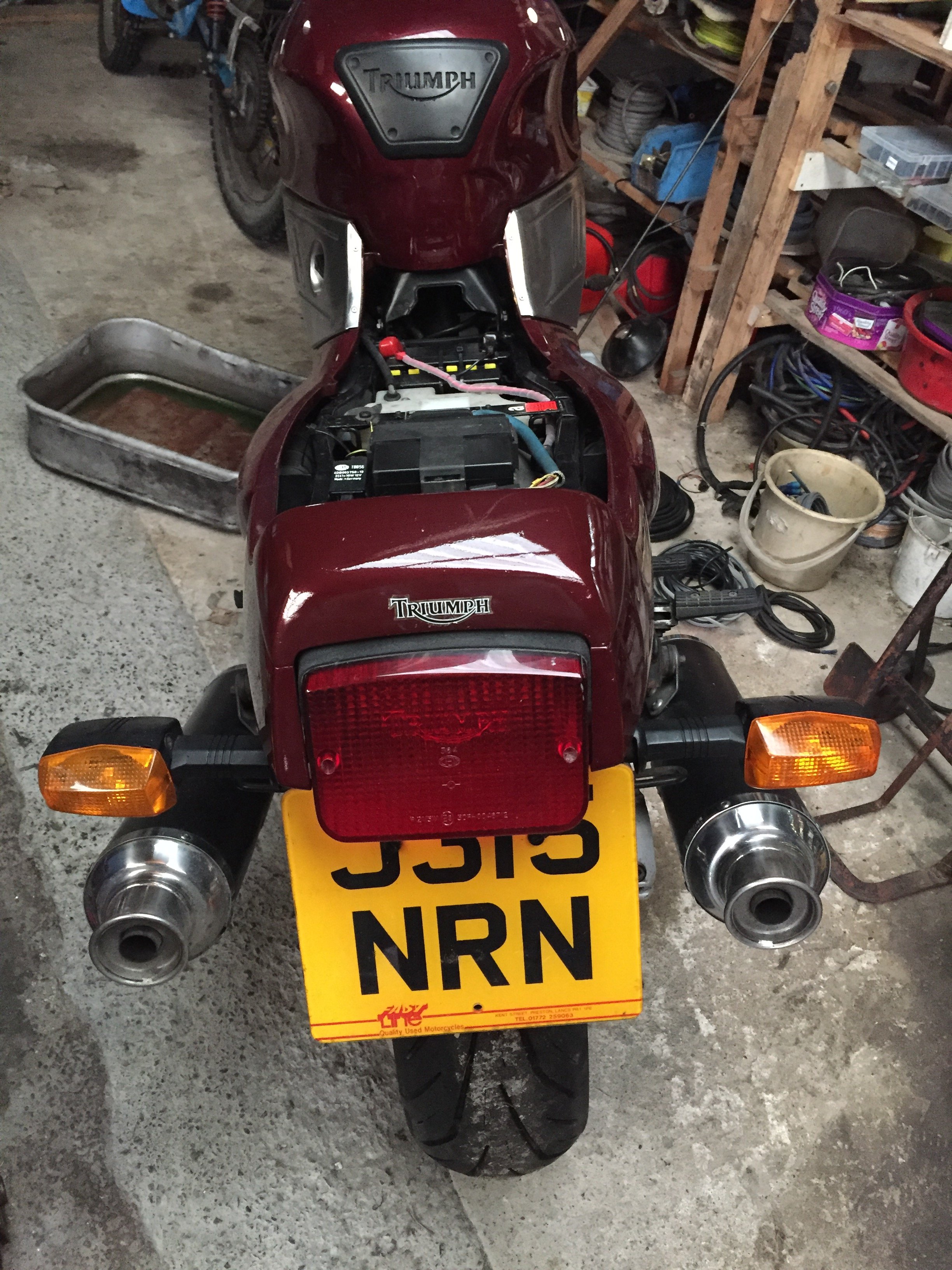

  18. Kelvin_2202
    Kelvin_2202 Member
    Oct 2, 2016
    26
    North Wales

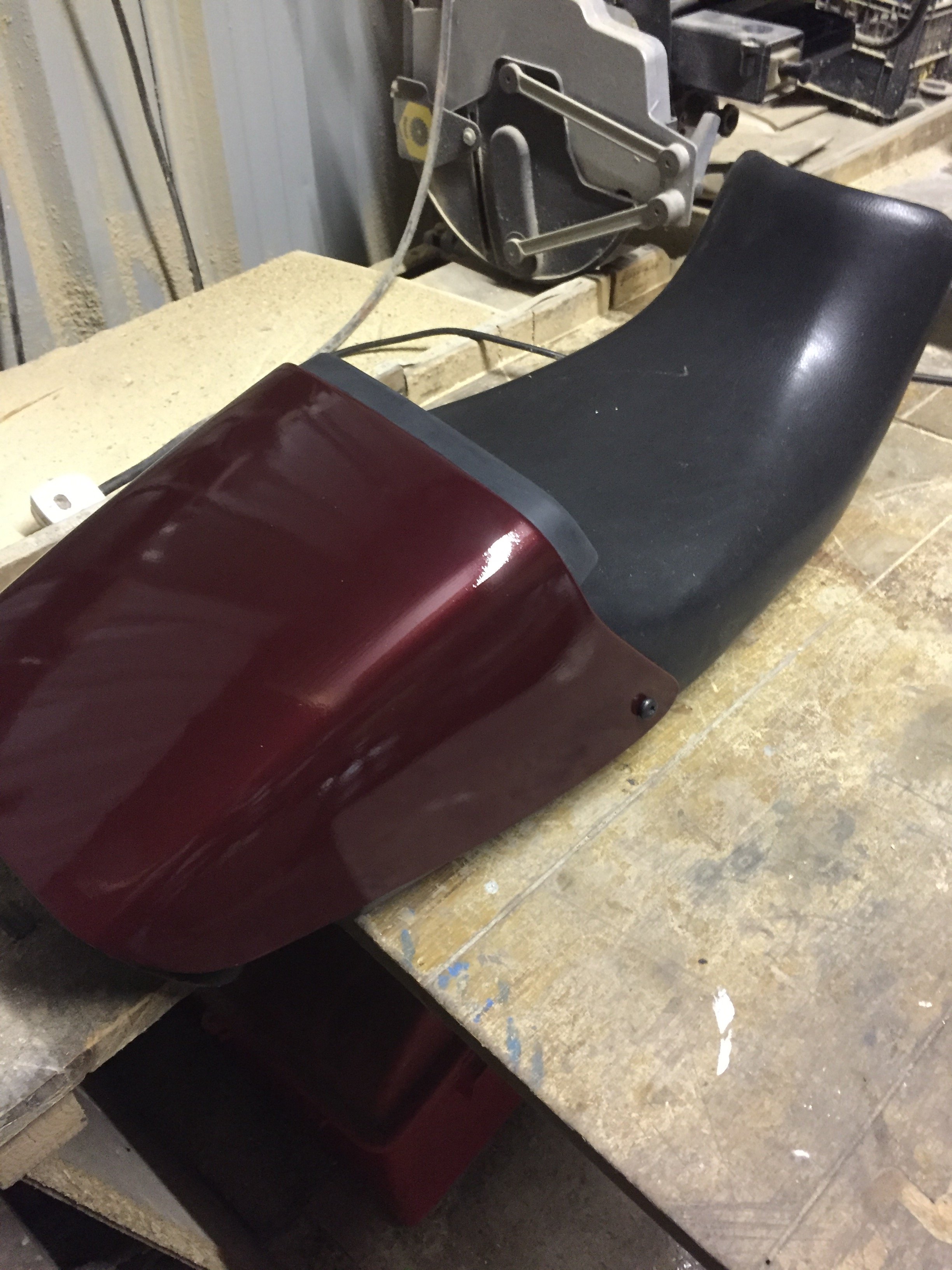

    And finally the cowl fitted.
    Was a bugger to fit, we had to shave a lot off the seat plastic and foam, and some of the cowl where it sits against the trim piece. We also had to re drill the original mounting holes.
