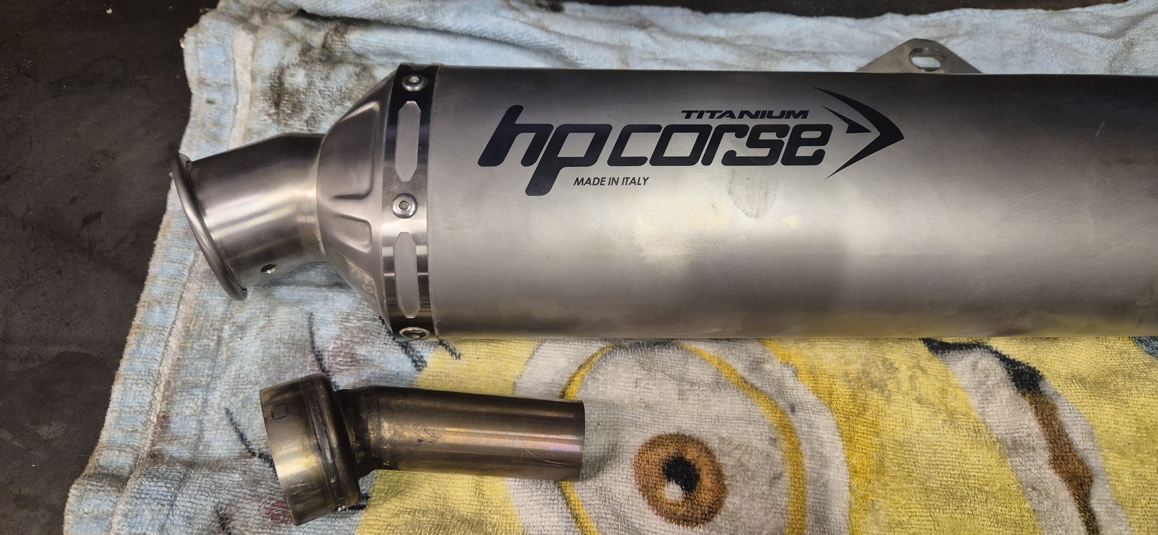

    Why not make a number of Pro Race suitable baffles and run them through a noise meter?
    I have a Kove 450 rally with a HP Corse pipe and decat. The dealer said they weren't too loud when I commented, but two separate bikes behind me on different days said otherwise and stated, when you go for it I simply can't hear anything :rolleyes::eek:
  16. Eldon
    Eldon Crème de la Crème
    9,136
    Here @Junglie25 is the baffle to start with and a very acceptable result after.
    It does take a bit of trial and error but is quite easily achievable with a few tools/skills and effort.

    It had crossed my mind, I must admit. And seeing how you've done it... yeah, I could look at that down the line.Thanks for the really useful picture.

    Here you go @Junglie25
    Stainless steel punched sheet 0.71mm thick (22 swg in old money). Easy to work with and form, not too heavy.
    3mm diameter holes.
