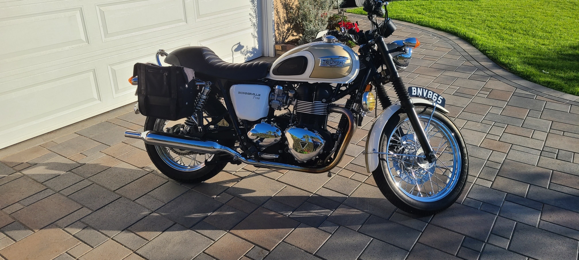

    Wow, thank you for valuable insight. Your experience is much appreciated. I guess it will have to be a watsonian. My question would now be which model sidecar should I go with? I've attached a picture of my Bonnie. I appreciate your assistance. Thanks again for all your help.

    I'd suggest that Watsonian is the most realistic choice from a limited resource pool and, of the range shown on the web site, I'd personally think that the GP or the Monza are the best suited to a modern Bonnie like yours.
    I can foresee quite a few questions that need to be asked and I'd be happy to make enquiries on your behalf should you wish. PM me if you like.
