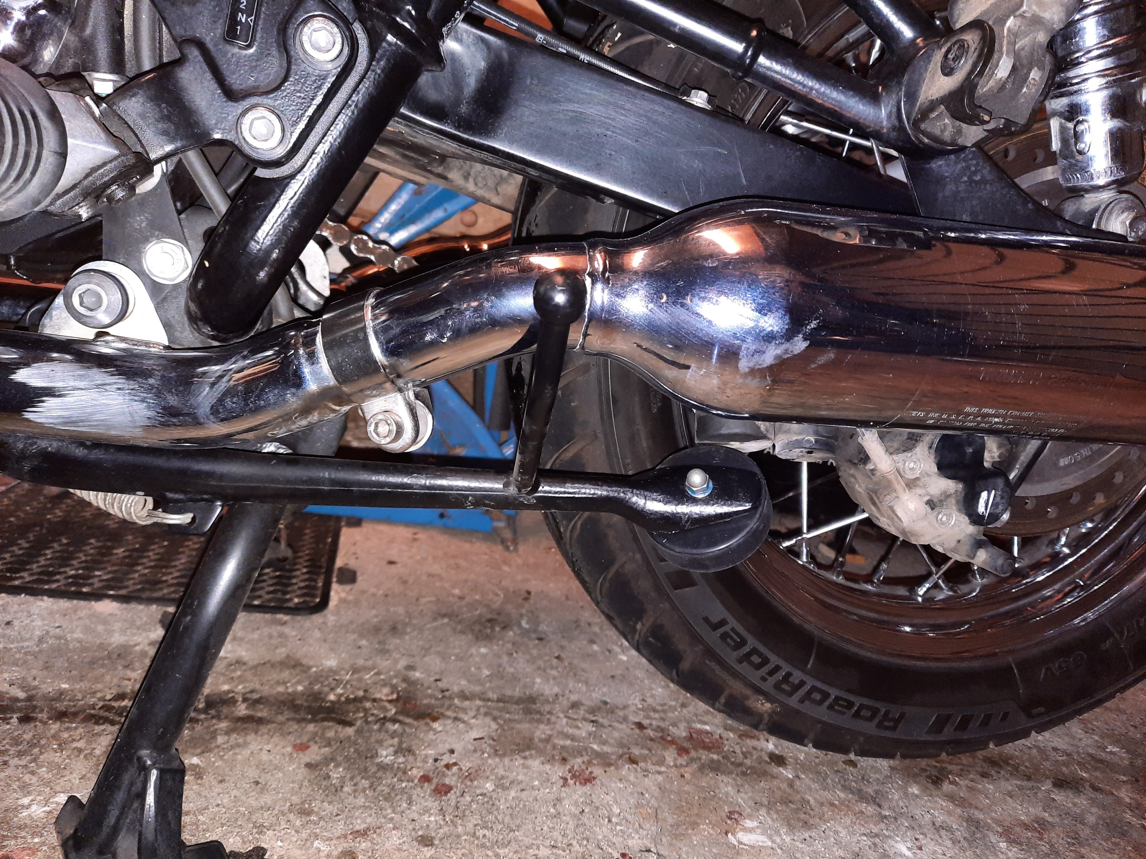

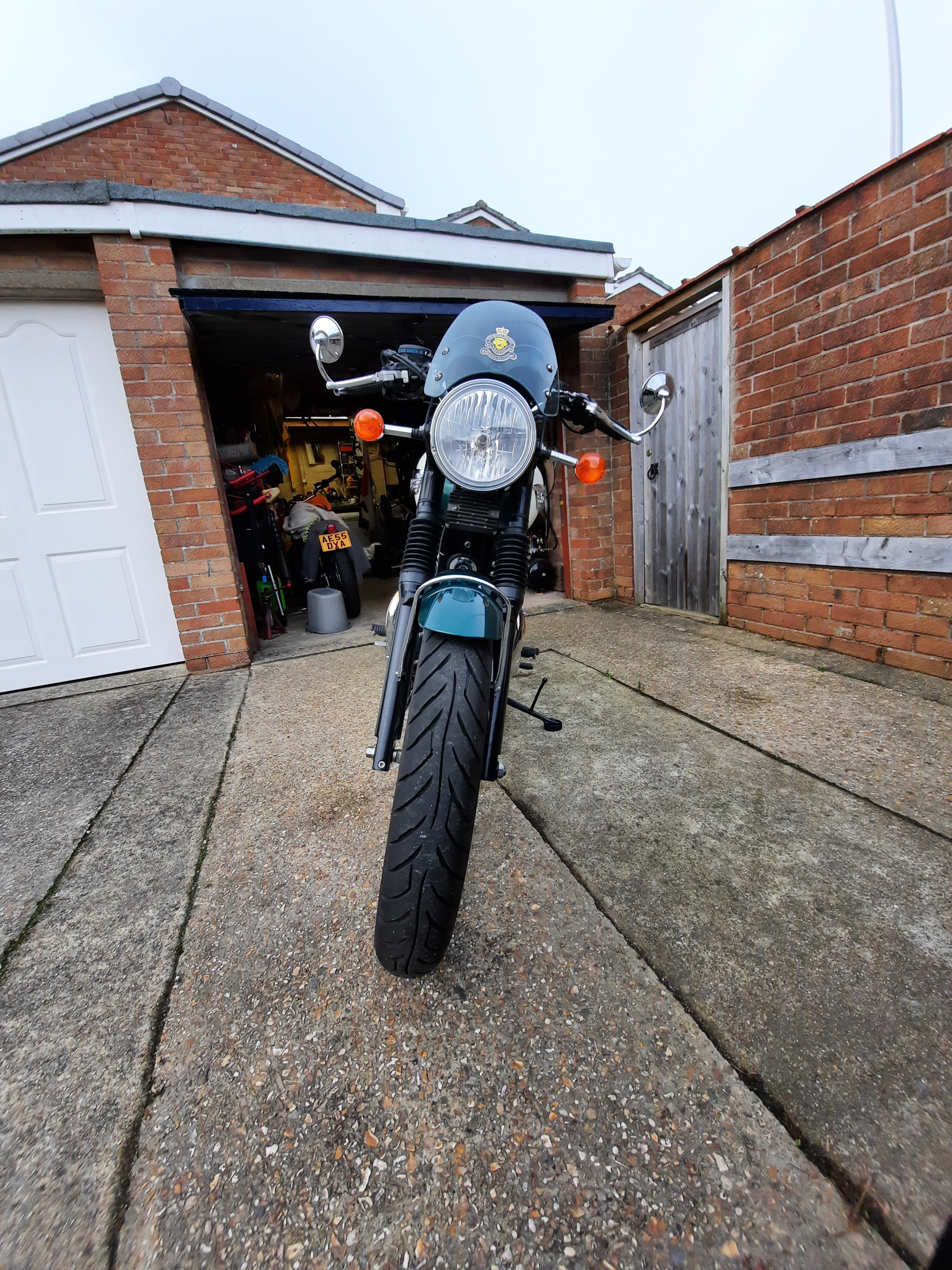

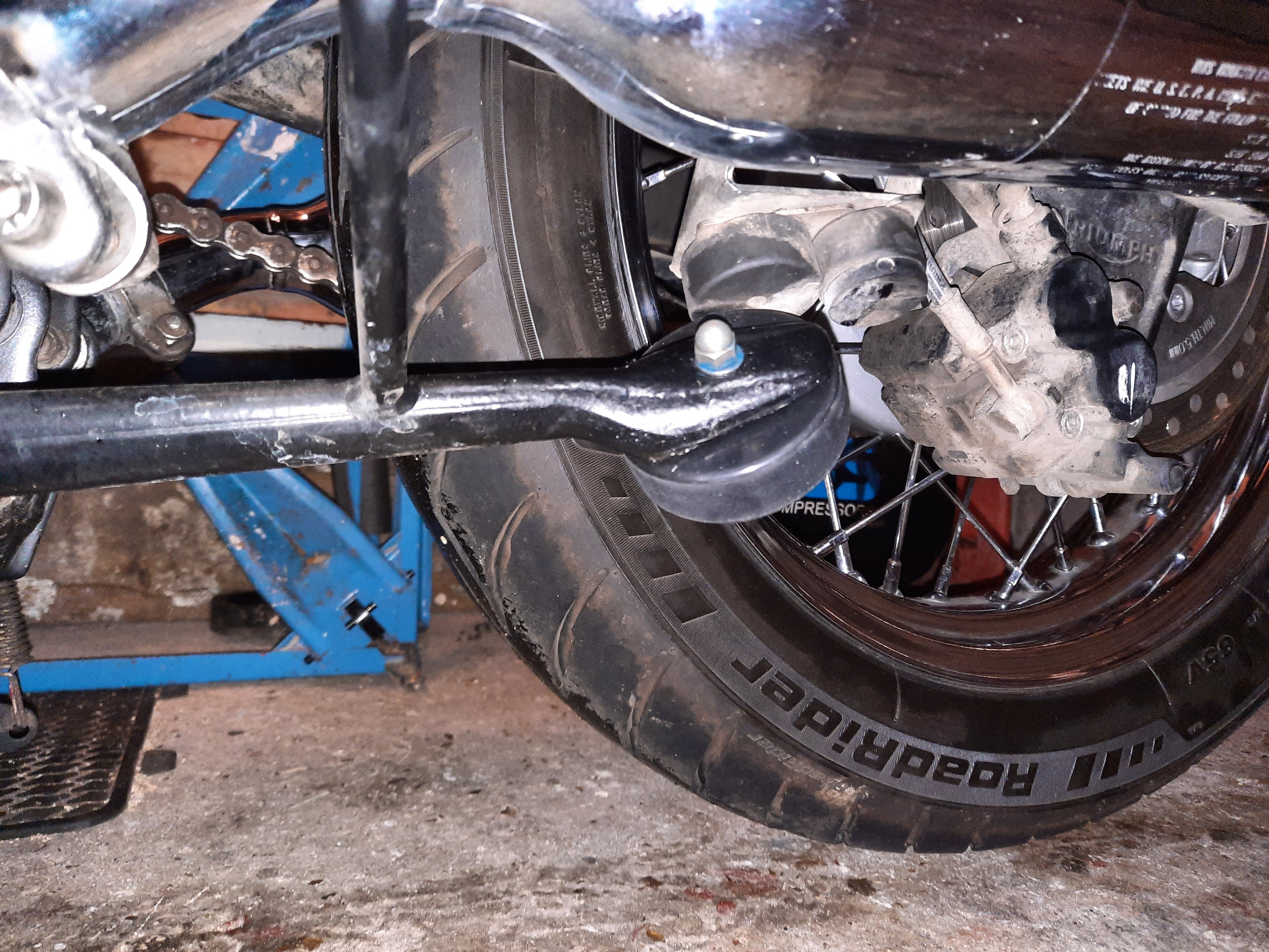

Finally got around to modifying the lean angle on my T100. Drilled through the side stand foot and bolted on a junior hockey puck, this gives a 20mm thick foot under the stand.
Doesn't look to bad, the puck is 60mm dia so only sticks out the side by about 10mm. If it becomes a problem could possibly cut it down to match the stand foot
Reminds me of the side stand on the Commando 850 I used to own back in the late 70's, the angle of lean, length of the stand, in fact everything about it used to fill me with dread!
Just found a problem with hockey puck idea! If you have the side stand up and then take the bike off the main stand the main stand will then stop the side stand from being lowered. Tried shaping the puck to match the foot on the side stand but the problem is the thickness of the puck fouling the main stand. So will have to live with it and remember to put the side stand down first, which is what i would normally do anyway. Back onto ebay now to buy another puck (good job they are only £4)
