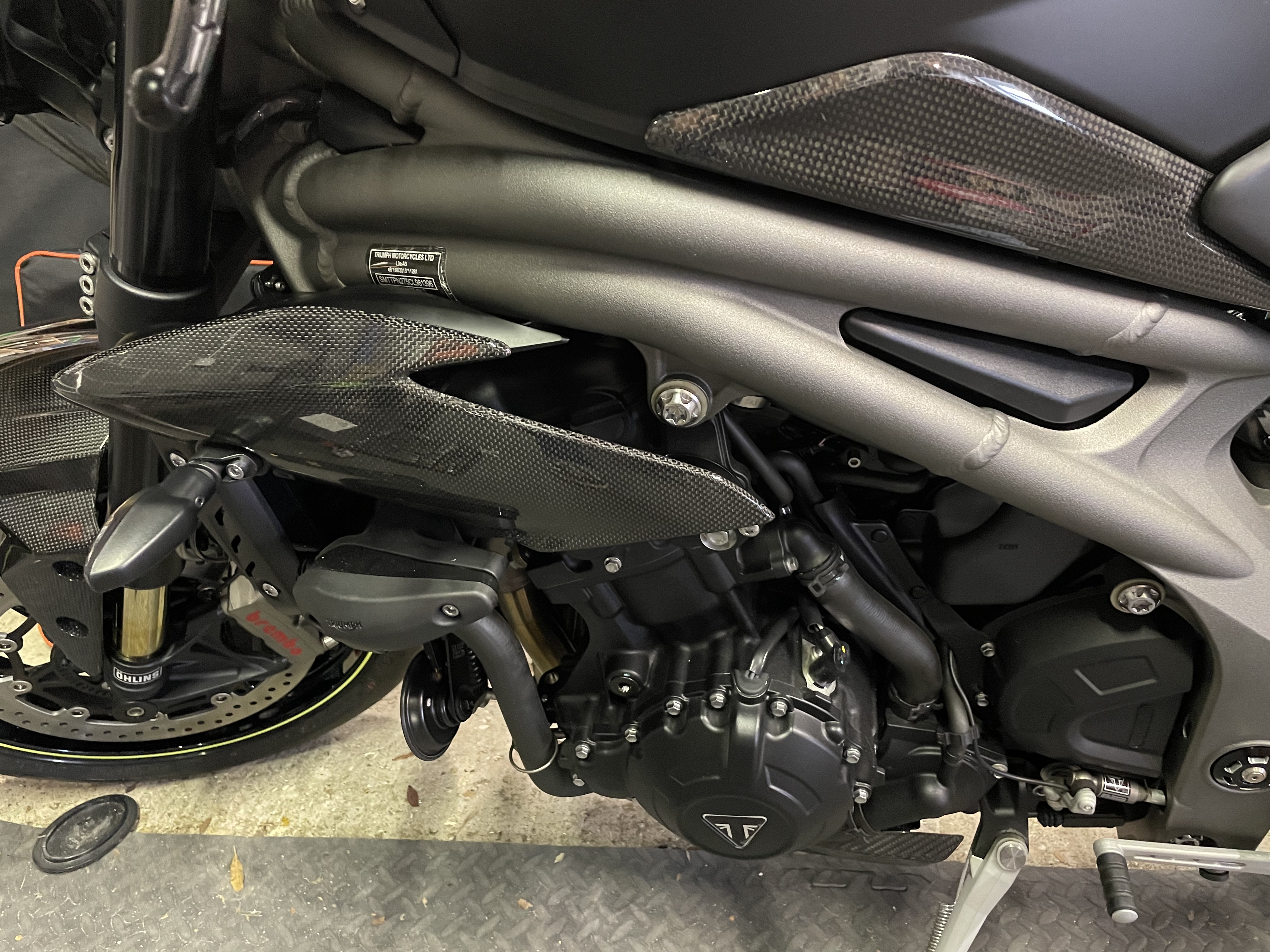

    Anyone know how to remove the side fairing of the speed triple?
    My neighbor backed into my RS knocking it over and damaging a few bits including the right side blinker & the bracket that supports it. I'm going to order the parts to replace it all but I can't figure out how to get the carbon fiber panel / fairing off to gain access to that bracket. Fortunately it didn't damage the CF (as far as I can tell; tbd once the fairing comes off); rear stanchion protected my exhaust and I've got the smallest of knicks on my clutch cover.
    Image is pre knock over but the fairing rocking the 'RS' & turn signal is the one in question.
    Thanks,

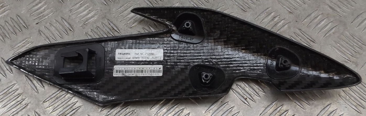

    I've taken mine off before - definitely remove the indicator bolt, then the whole thing slides forward and unclips (I recall).

    I wouldn't go full gorilla, but it might need half-monkey - it will unclip/slide off with some wiggling and gentle persuasion.
    Here's a picture of the back (from eBay). I think there's a bracket that attaches to those three holes that comes off with the side cowl. I definitely didn't have to unscrew anything that was out of sight or reach.

    Just as an update and for anyone else who’s interested, it’s dead easy.
    1. Undo the indicator bolt
    2. Wiggle free the whole panel (side panel and black plastic vented piece that it’s screwed to) by pulling forward and backward gently. There’s a small plastic clip that holds it to a front bracket.
    3. Disconnect indicator wires.
    4. Unscrew the carbon piece (which was the but I wanted to change).
    5. Screw on replacement and just do the above in reverse order.
    Photo of the new panel (without the bright yellow flash which I wasn’t a fan of). cheers
