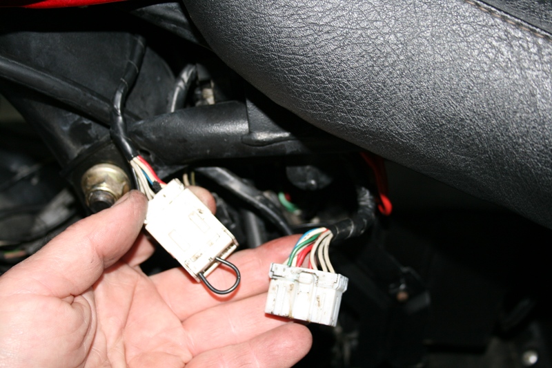

    Also I found these plugs behind the left side cover. One on left seems to be jumped across two pins, one on right goes nowhere. They do not fit together. Does anyone KNOW what they are?

  10. crispey
    7,323
    Not something to do with side stand cut out switch? Or clutch pull starter switch? I've heard if you want to do away with the hassle of them you disconnect them and jump it.
  11. Bob Chambers
    Bob Chambers Member
    Nov 23, 2015
    22
    USA
    Well now, that's a possibility. The sidestand switch is operable, but the clutch switch cutout is not.
  12. Sprinter
    yeah, what Bikerman says.
  13. thebiglad
    5,072
    My T100 had that plug and the jumper leads. I was led to believe that it the set-up if you have a factory alarm fitted.

    My 2010 T100 had both a Triumph alarm and this 'dummy' plug.
