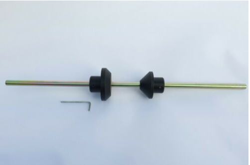

    No-Mar in the States produce a set of cones for a SSSA rear wheel but I really don't want to start buying stuff from over the pond but the only product I could find in this country was from ABBA. When I looked on their website, they offer two adapters, one generic and one BMW-specific. The problem is, their generic version didn't look appropriate for the Triumph wheel and I harboured some doubts that it would work and so I emailed them direct to enquire if it would fit and received the following reply
    "Hi Alan, Yes we have an adapter which will fit the new speed triple wheel.
    The adapter is not listed on the website yet, however we have sent you a direct link to pay (this should come in a separate email).
    It looks like the picture below
    sssa.JPG .
    Please let us know if you need further information"
    I have ordered one at £33.75 and when it arrives, I will fit it to the wheel, take a few pictures and comment on how well it appears to hold the wheel etc and post the part number. If anyone else out there likes to balance their own wheels then this would appear to be the only current viable option in the UK, short of making your own.

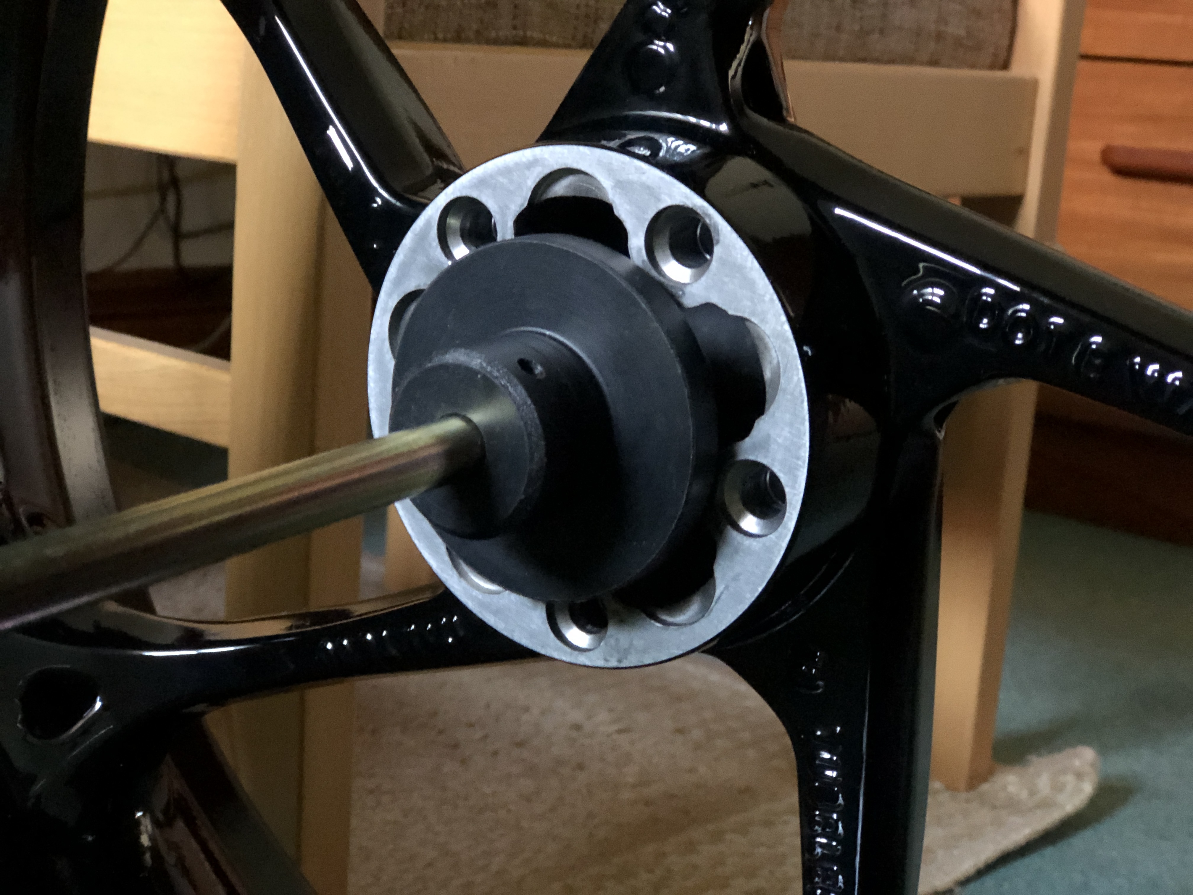

    Hi All - excellent service from Abba - I ordered the stand one day and it arrived the next courtesy of Royal Mail.
    I confirm it fits and will do the job it's intended for.

    For those interested in buying one, the item is not yet listed on their website. They currently have two listed - one generic for SSSA-equipped bikes and one for the various models of BMW. Be warned, the Generic item is not intended for the Triumphs and the one needed is "Single Sided Adapter - Type C Product Code 167.
    If still not available at the time of ordering, simply contact Abba direct.

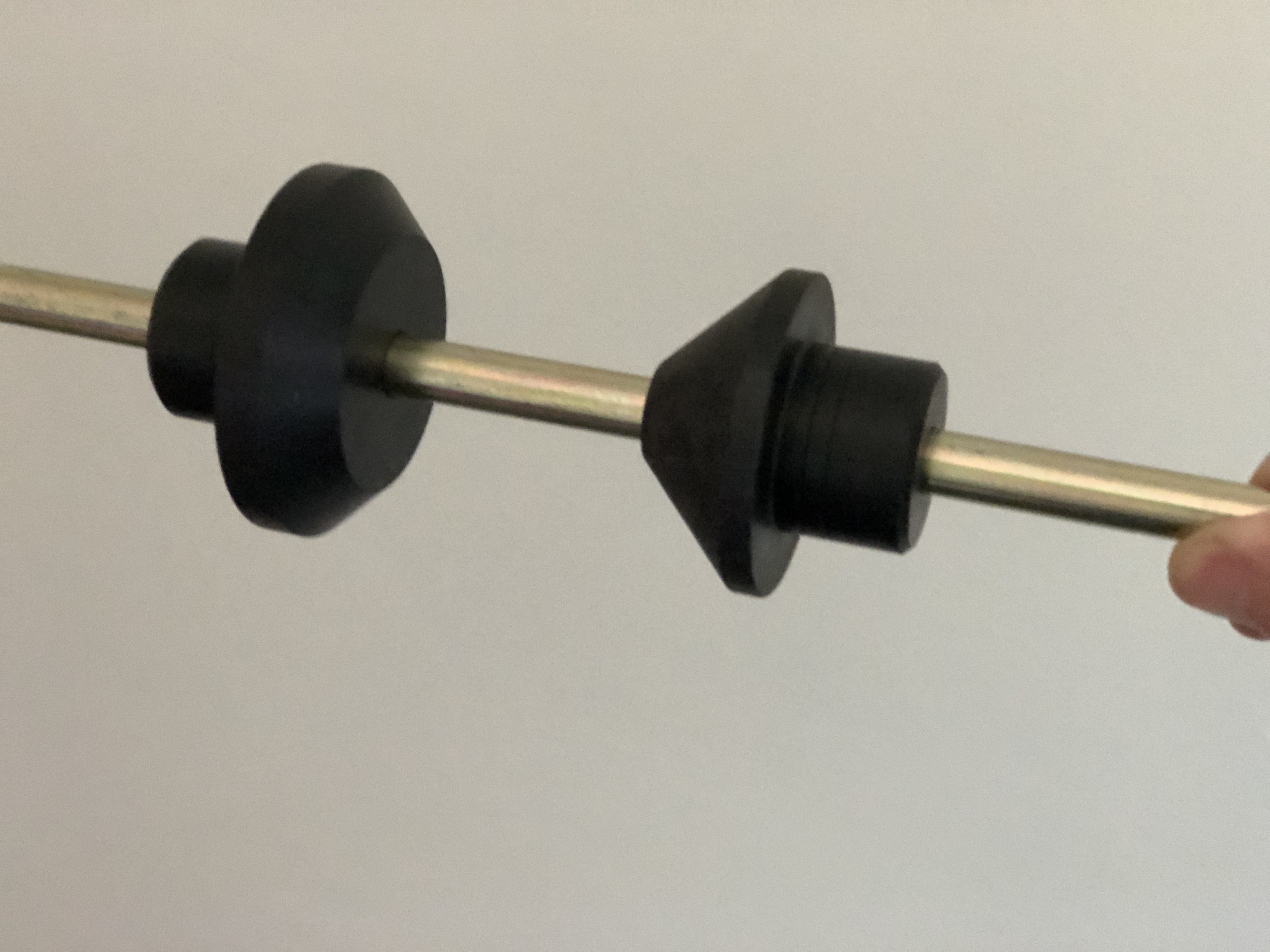

    The cones are some form of high density plastic - They feel harder than nylon 66 or acetal and so not sure what they are but certainly feel very strong.
    The one concern I had and why I didn't post the full details beforehand is because I wasn't convinced the cone would locate stably on the driven side of the wheel.
    The smaller cone is an accurate match and so no problem there. The larger cone does locate on the 5 edge "chamfers" on the inner edge of the drive flange and does so stably but with one caveat . . . .

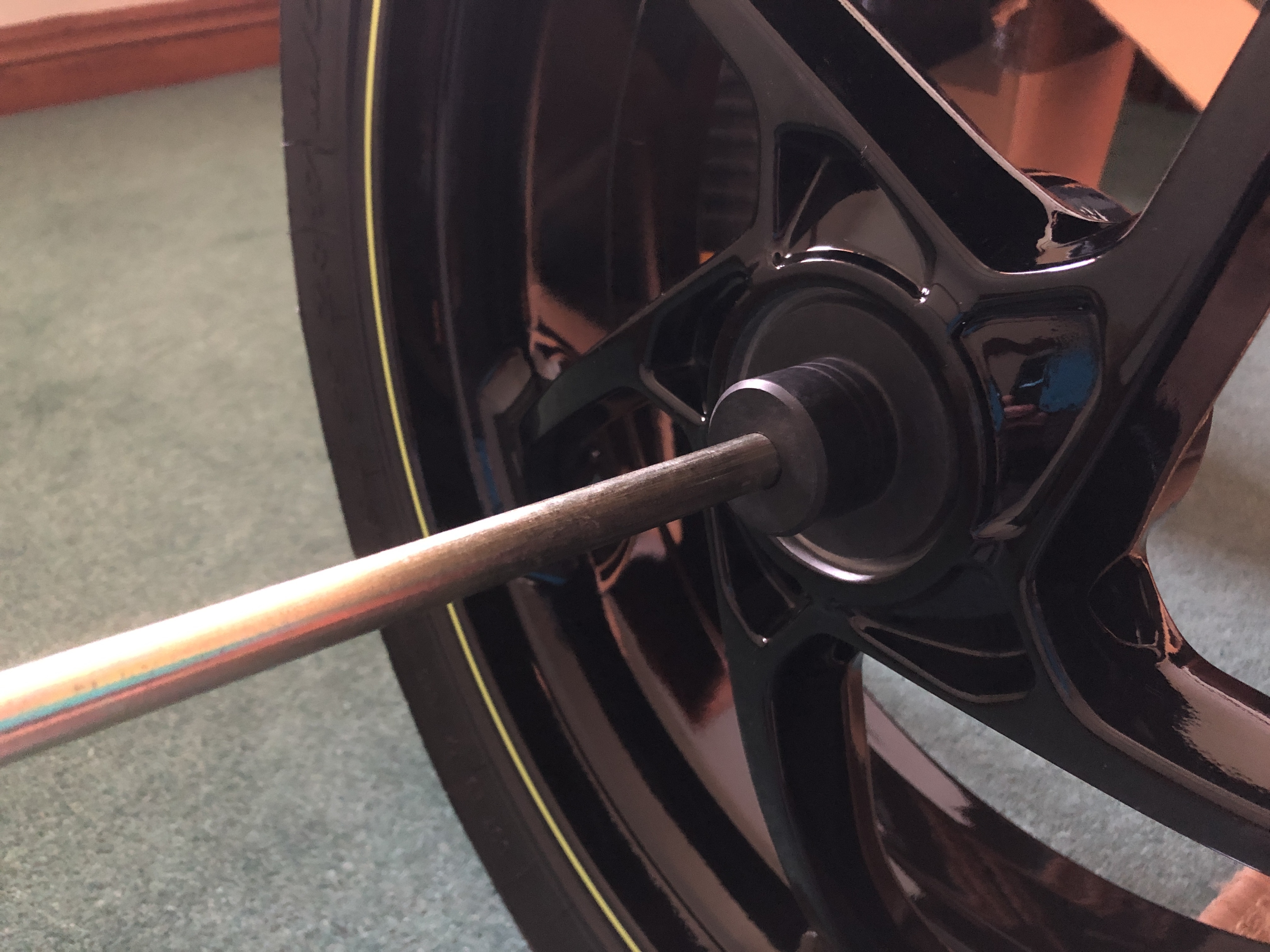

    The weight of the wheel is borne by the cones and thus the contact angle will try and push the cones outward. Any small movement will loosen the the fit and thus interfere with the accurate alignment of the cones within the hub and so it is necessary to nip up the grub screws reasonably firm. There is no need to hang off the allen key and do a gorilla job when tightening but they do need to be nipped up firm but not tight enough to risk stripping out the threads in the plastic. One saving here is the fact that without any bearings or discs etc, the S3 wheel is extraordinarily light.
    I mounted the wheel by securing the grub screw in the smaller cone, feeding the bar through the wheel and then sliding the larger cone into position and then whilst squeezing both firmly together with one hand, simply tightening the second grub screw - it self-centres perfectly well.
    A better design would have been to use an accurately machined cylinder which slides inside the hub and mates up to the 5 internal surfaces of the hub - they missed a trick there I think and when I have time, I might even turn up another "cone" on my lathe but not something I'm inclined to do at the moment as it will work fine as is . . . . .

    Material of the cones looks like Delrin. If so, it’s quite durable.

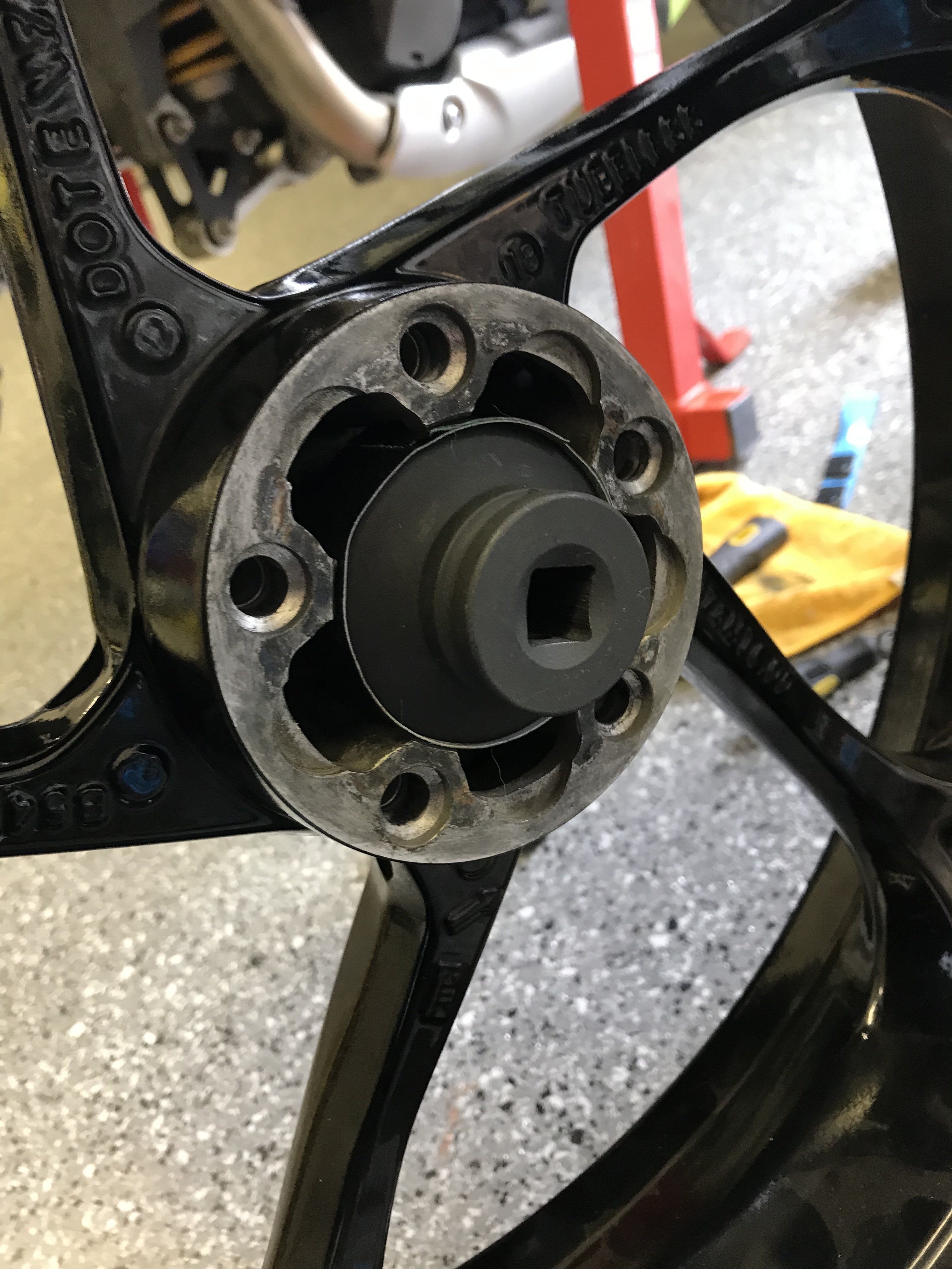

    Here’s a good shortcut if you’re stuck (this is not recommended by Triumph or good for your warranty but it does have the double advantages of being effective and free). Take the socket for the real wheel nut - it is an almost perfect fit for the larger gap in the hub. Roll bodge tape around the outside until it is just too big to fit then tap in gently with a mallet. Do the same on the other side with a smaller socket (20mm or so). Slot the balancing bar through the socket drive holes. The holes are square of course but if you have nice slim cones on your balancing bar it will snug up tightly. It works perfectly as far as I could tell. Balanced a wheel yesterday with this and test rode with no snags.
