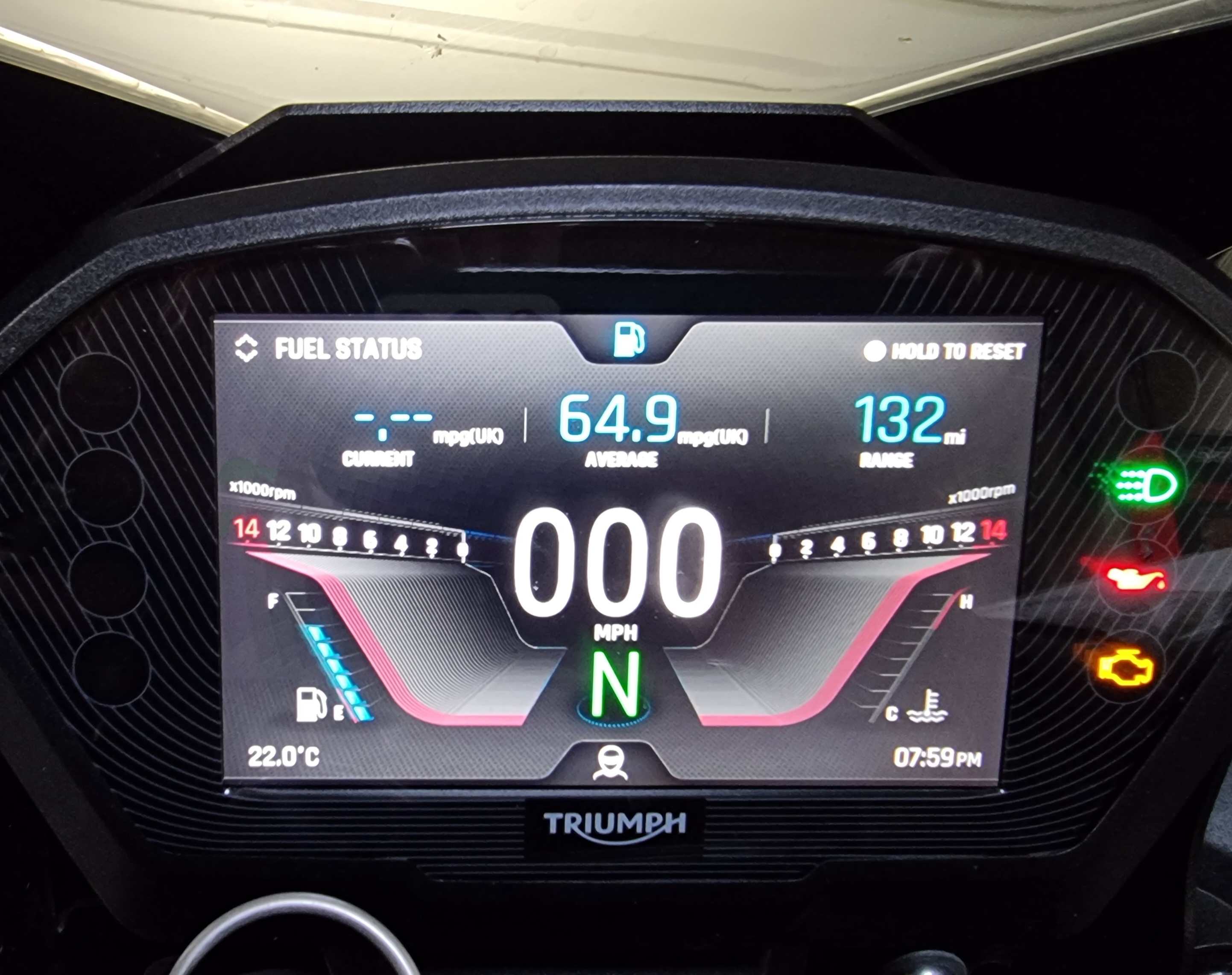

    My 2024 Street Triple RS is coming up for its 1st annual service. The bike was first registered exactly a year ago and had the initial (600 mile?) service in September last year. I bought the bike 2nd hand in October. By my reckoning, the dreaded yellow spanner light will make an appearance in about 6 weeks time, I'm well below the other servicing criterion ~ 6000 miles. In the past I've done all my own servicing and I was able to reset the service light on my '17 plate STRS using dealer tool software. I'm told that won't work on the post 2023 model Street Triples and I even spoke to dealer tool about this a few months ago. At that time they didn't have a package they could offer which reset the later bikes. I think that's still the case. I spoke to my nearest Triumph main dealership this morning asking for a price to reset the light. They said they wouldn't do it unless they undertook the servicing themselves. So it looks like I'm locked in to having them do the work which pi**es me off tbh. Is anyone with a late model bike having the same issues? I'm assuming its all or most post 2023 models of Triumph that have this 'locked in' feature?
