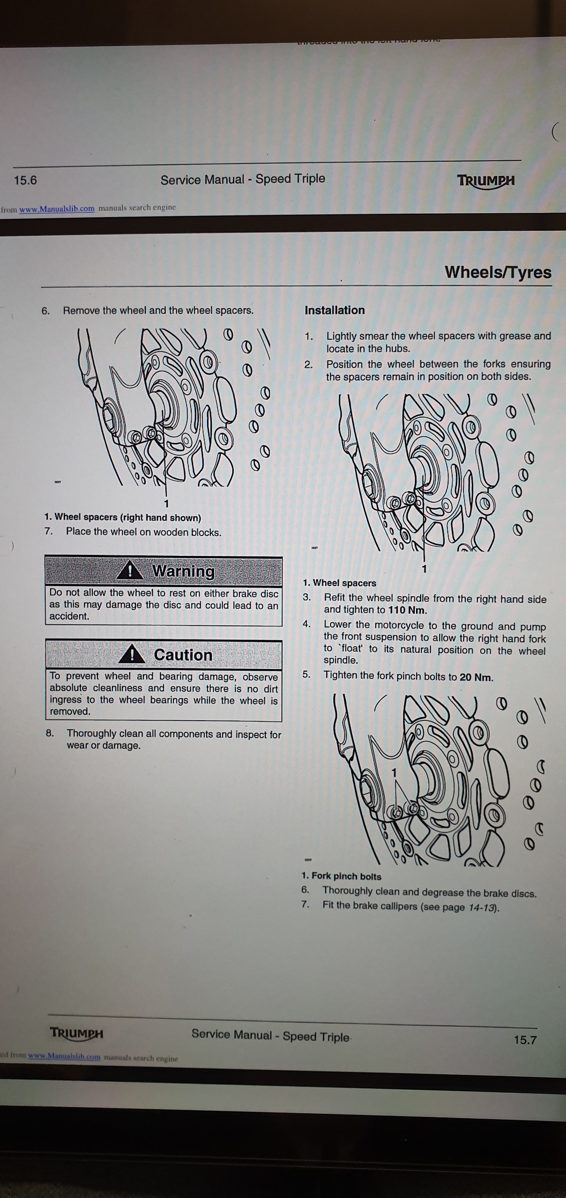

    This manual says 110nm which is massively different to 65nm hence my concern

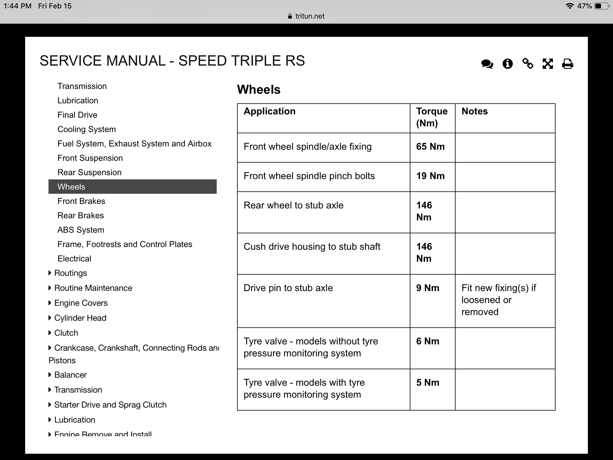

  8. SteveRS
    SteveRS First Class Member
    Jan 12, 2019
    862
    British Columbia
    From the service manual that I purchased online.
