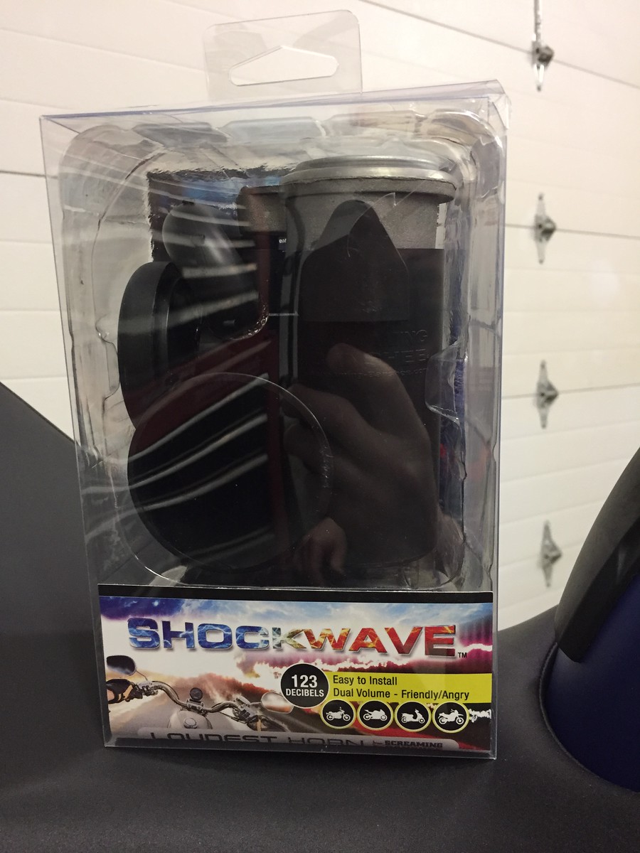

    One of the items on my "wish list" for the bike was a more robust horn. SWMBO came through this Christmas with a Screaming Banshee brand "Shockwave" air horn, which I promptly installed as follows:
    As you can see, it's quite a bit larger than the factory horn. The instructions indicate that it should be mounted in place of the factory piece, but they also say it shouldn't be exposed to driving rain. A bit contradictory. Plus it's sort of unattractive, and I"m not sure it would even fit in the stock location (I didn't even bother trying). Instead, I found space behind the panel on the right side aft the radiator.
    It's a tight fit, and took some trial and error to find the best position and angle. The air horn is intended to mount with a single bolt that is held in a slot cast into the metal body of the horn's motor. I reached into my junk parts bin and found a plastic spacer that would do the trick with some modification. I drilled a hole through the factory plastic body panel back piece and secured the air horn using its supplied bolt and a fender washer on the other side (along with the aforementioned spacer and the supplied lock washer and nut).
    After that it was a matter of wiring things up per the instructions (though I much prefer to solder and heat shrink my junctions). Here's the finished install:
    It protrudes a little beneath the body panel, and I might try and seal up the cavity where the electronics reside better. I did use some dielectric grease on the terminals and connector, but I'm not sure that's enough for the long haul.
    I must admit I'm a little disappointed in one thing with this horn. They advertise it as having the feature of a "friendly beep" at first until you hold the button down for at least .15 seconds before it goes into full "GTFO" mode. However, it seems the "Shockwave" model is version 2 of the Screaming Banshee horn system. Version 1 came as two pieces and either retained the factory horn or came with its own secondary - less angry - horn. This one has a jumper/shunt that is supposed to enable that decreased volume for the first .15 seconds. I can tell no difference between the two settings.
