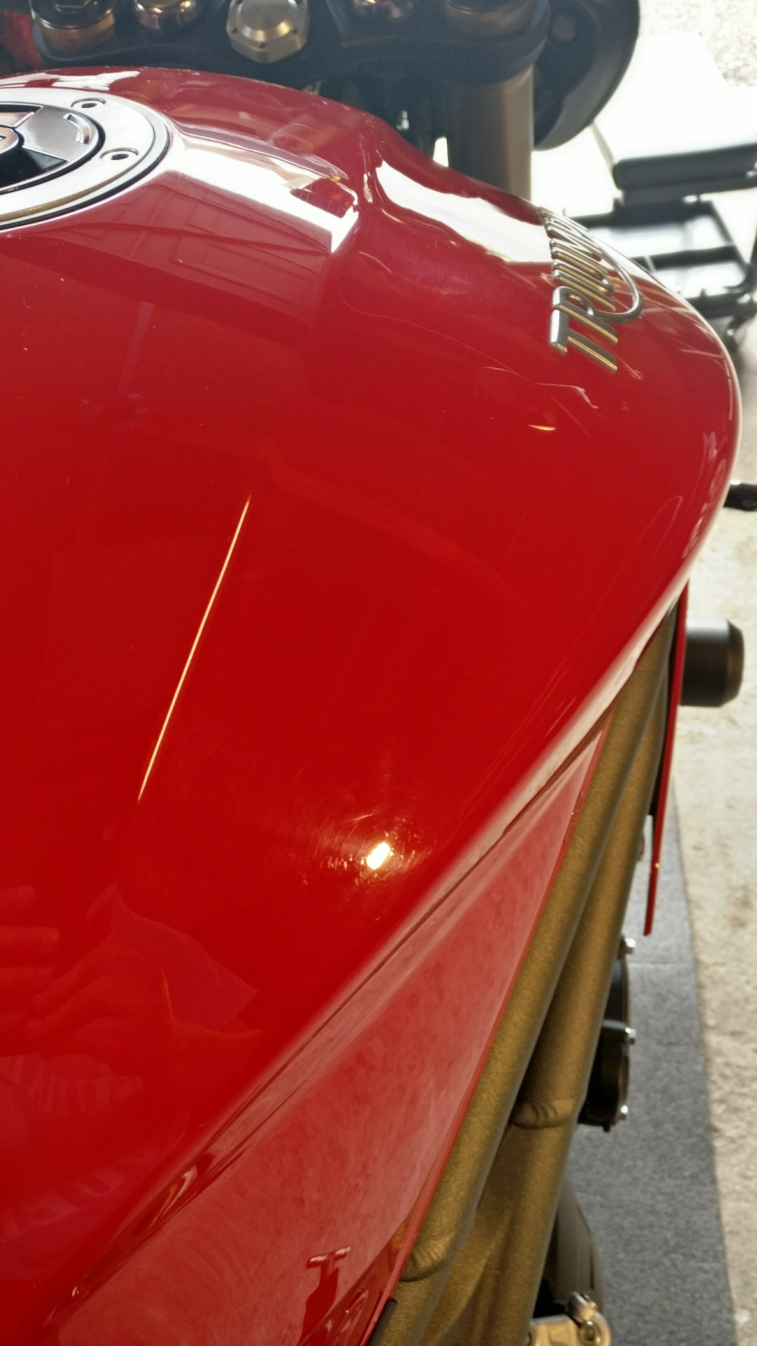

    looking for advice ive noticed my triples paintwork had lots of minor scratches and swirl marks ive now bought grit guards and stopped using sponges,got a halfords brand microfibre dreadlock type car wash sponge i will use but have seen conflicting advice on removal of scratches/swirlmarks,is it worth paying somebody to professionaly remove the scratches and or detail the bike,ive got bottle of tcut but have read this is too abrasive seen simoniz website advice on using their paint restorer and waxing but im unsure whether to diy and risk further damage or get it done professionally,its just annoying me and seems like its just the clearcoat that has the fine scratches any product recommendations from personal experience welcome.

    After fecking up the paint on my tank my son suggested I clay bar it then use some Autoglym paint renovater then wax and polish, worked a treat

    Hi mate,
    I had the same, I use meguirs, easily available.
    Wash the bike with washing up liquid to get rid of old wax the use ultimate compound to polish out the swirls, by hand takes a while but does the job. Then polish then wax

    This is using meguirs ultimate compound with a da polishing machine

    I'm assuming that's what you mean by scratch's and swirl marks, used the same on my car and it comes out the same.
