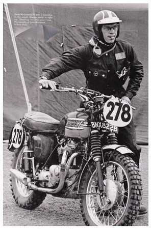

    Triumph should sell a "Steve McQueen ISDT Front Mudguard". :)

    Yes and they should make the bike again as well ... just look at the size of that mudguard ...very functional I’d say and not even having to protect a rather vulnerable radiator!

    Oh yes, ... and what a great photo of a real inspirational motorcycling enthusiast ... top marks from me !

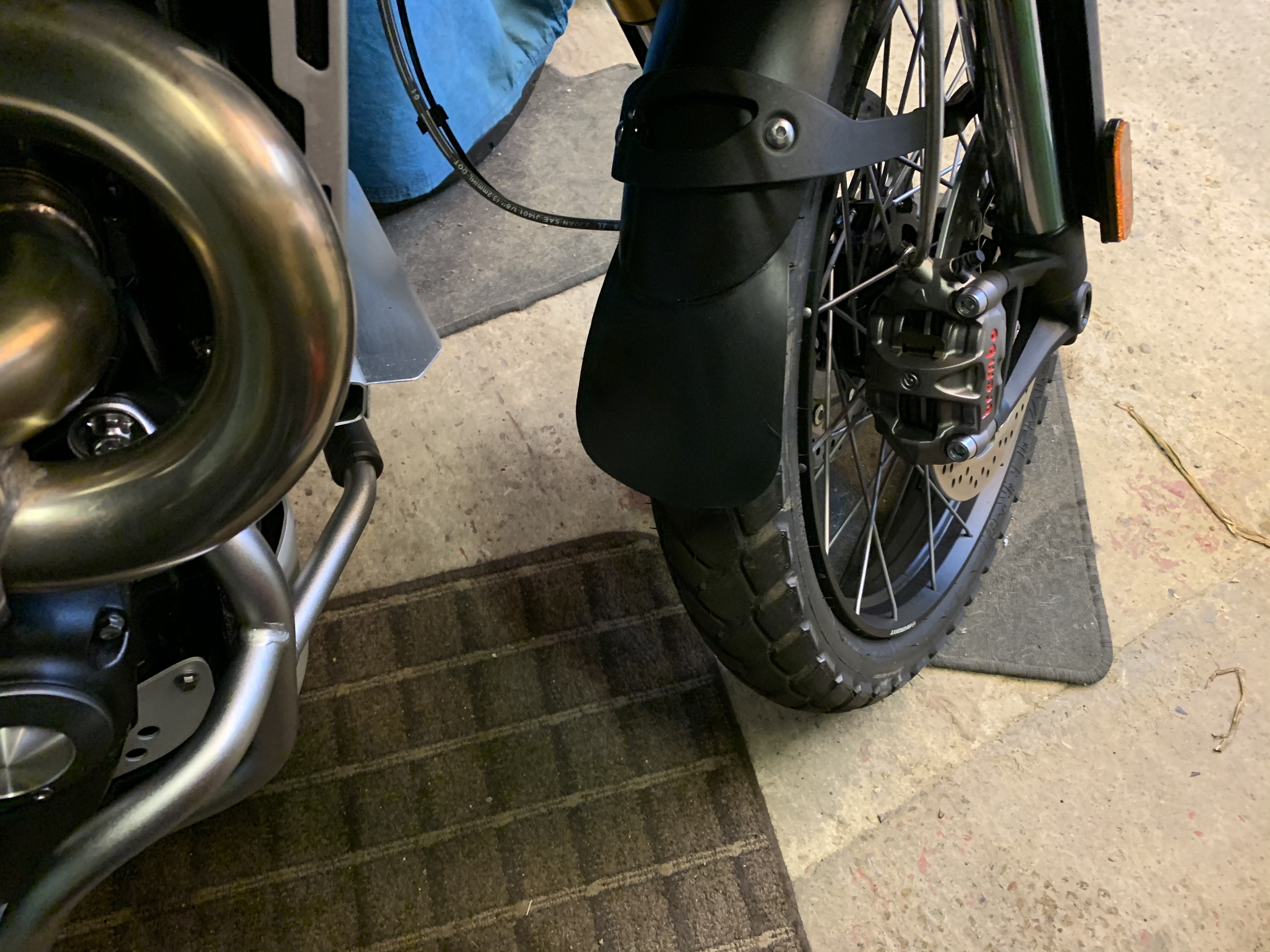

  8. Haro
    Haro Well-Known Member
    Jul 13, 2020
    174
    83
    Australia
    Fitted one a bit longer than this one and it works great. Good solid mounting the way the low front guard is put together.

  10. Pegscraper
    Pegscraper Elite Member
    Jun 12, 2020
    3,878
    If I'd have been designing the 1200 Scrambler with more off road "intent" as triumph claim I'd have fitted 2 small side mounted rads, like most other dirt bikes including my Husaberg, instead of one large rad mounted centrally directly in the line of fire from the front wheel. Just sayin'.
