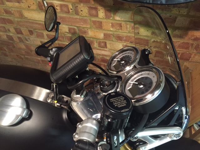

    Hi Guys, I started looking into how to mount my satnav and although I can do it I'm not too impressed with my solution. Ideally I'd like to mount it above the clocks and behind my screen, when the screen comes, so it will be unobtrusive. My plan was to make/alter the screen mounting bracket and attach the satnav to this but now don't think there will be enough space.

    I've used a ram mount ball, screwed into one of the clip-on bolts on the LHS (needed to purchase an extended bolt). Short RAM extension bar then into a RAM compatible iPhone case. Works really well, cost about £30. When i'm off the bike, I can either drop it down to just the ball, or leave the plate in place - it's fairly discreet. If you zoom in on the pic you can just about see the plate location.

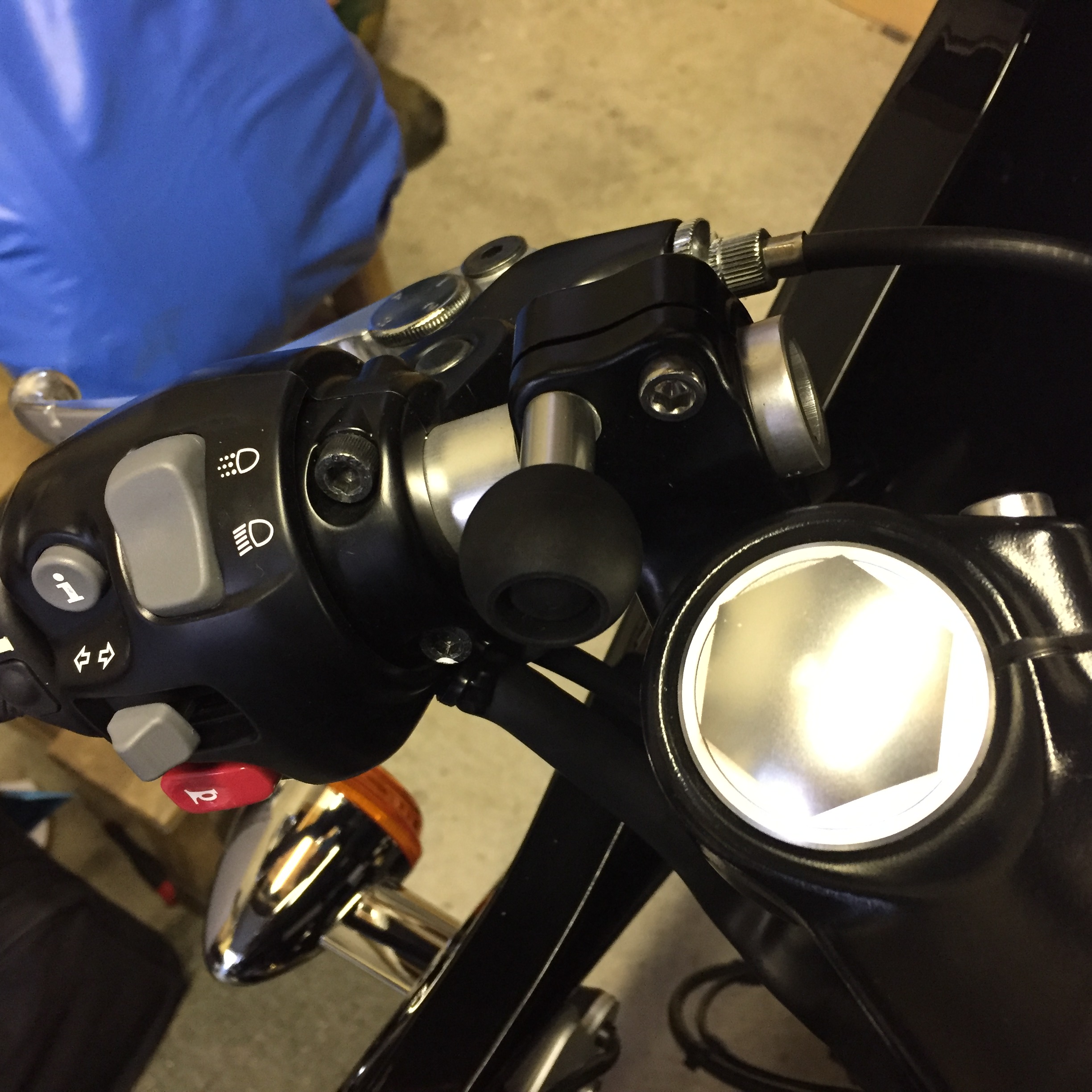

    I'm really interested in what you have done there, could you give me some more details on specific parts, maybe a closer photo please

    Here's the ball mount screwed into the clip-on bolt location. One of the bolts in the pack fits, will need chopping with a dremel or similar for a tidy fit
    Motorcycle Handlebar Top Clamp M6 Fitting with 1" / 25mm Ball - Use with RAM / SW-Motech Mounts by BuyBits http://www.amazon.co.uk/dp/B00GGKXDFW/ref=cm_sw_r_cp_udp_api_HcMOxbGTFM6J9
    There's also an extender
    Double Socket Standard Arm 1" Ball https://www.amazon.co.uk/dp/B0074WMQLS/ref=cm_sw_r_cp_api_6dMOxbBQJVXJW
    Then I used the RAM mount iphone case
    Ultimate Addons IPX5 Waterproof Anti Shock Tough Case for iPhone ... http://www.amazon.co.uk/dp/B00XA4R91G/ref=cm_sw_r_cp_udp_api_1eMOxb6D8QJBQ

    ..the shank beneath the ball doesn't fit exactly into the bolt head recess, but it compresses tightly.

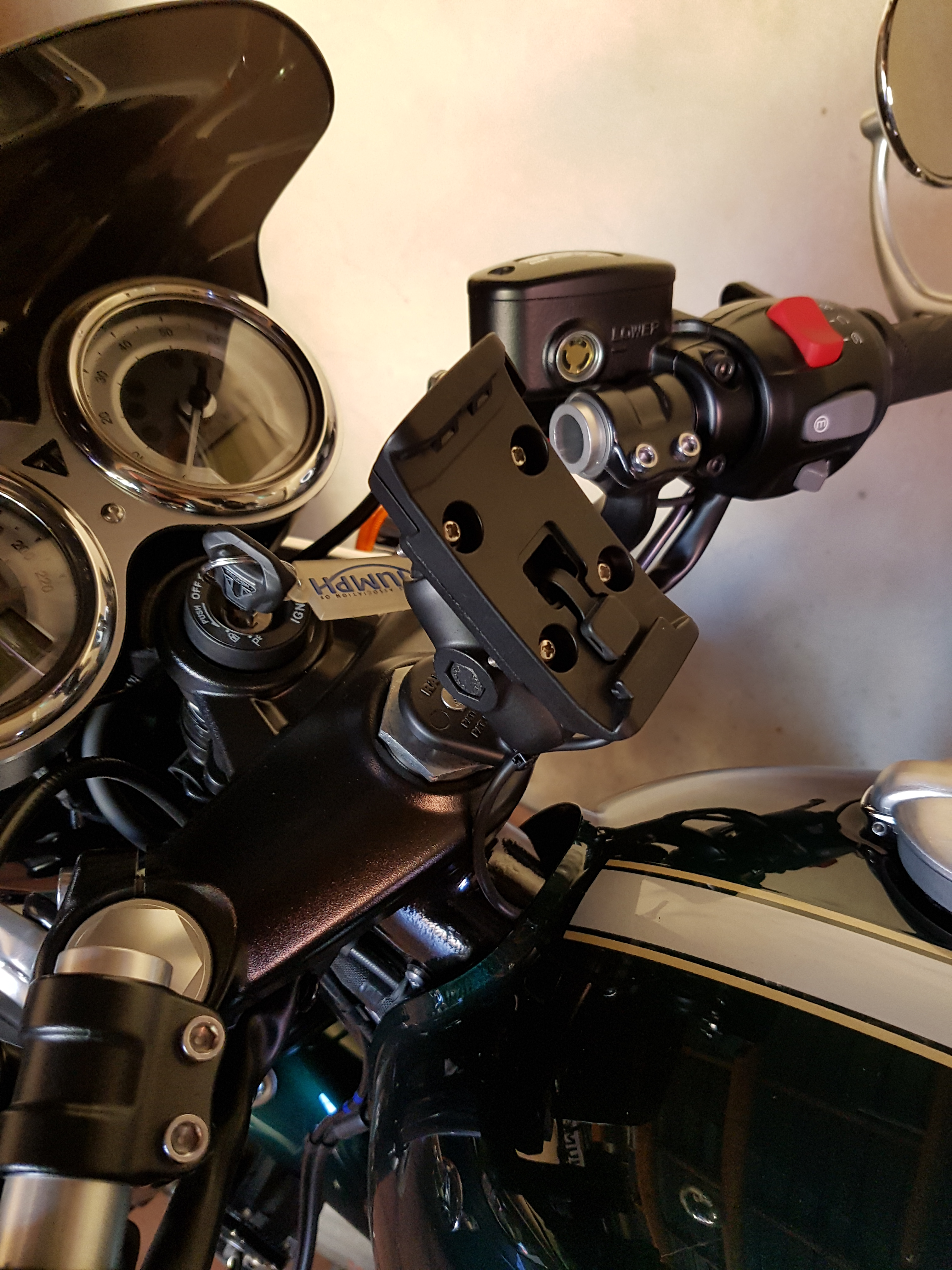

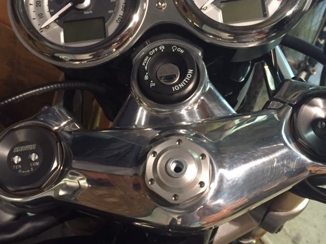

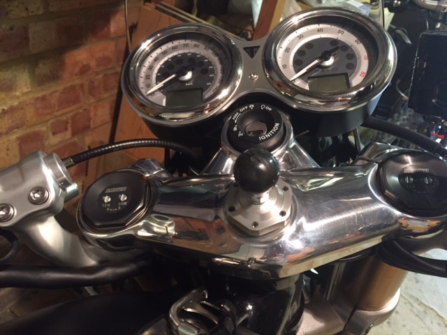

    After a bit of a search I found a product from http://www.telferizer.com/ great service and a neat, in my opinion, solution. It's a stock Triumph Yoke Top Nut which is drilled and threaded to accept a ram ball ;)

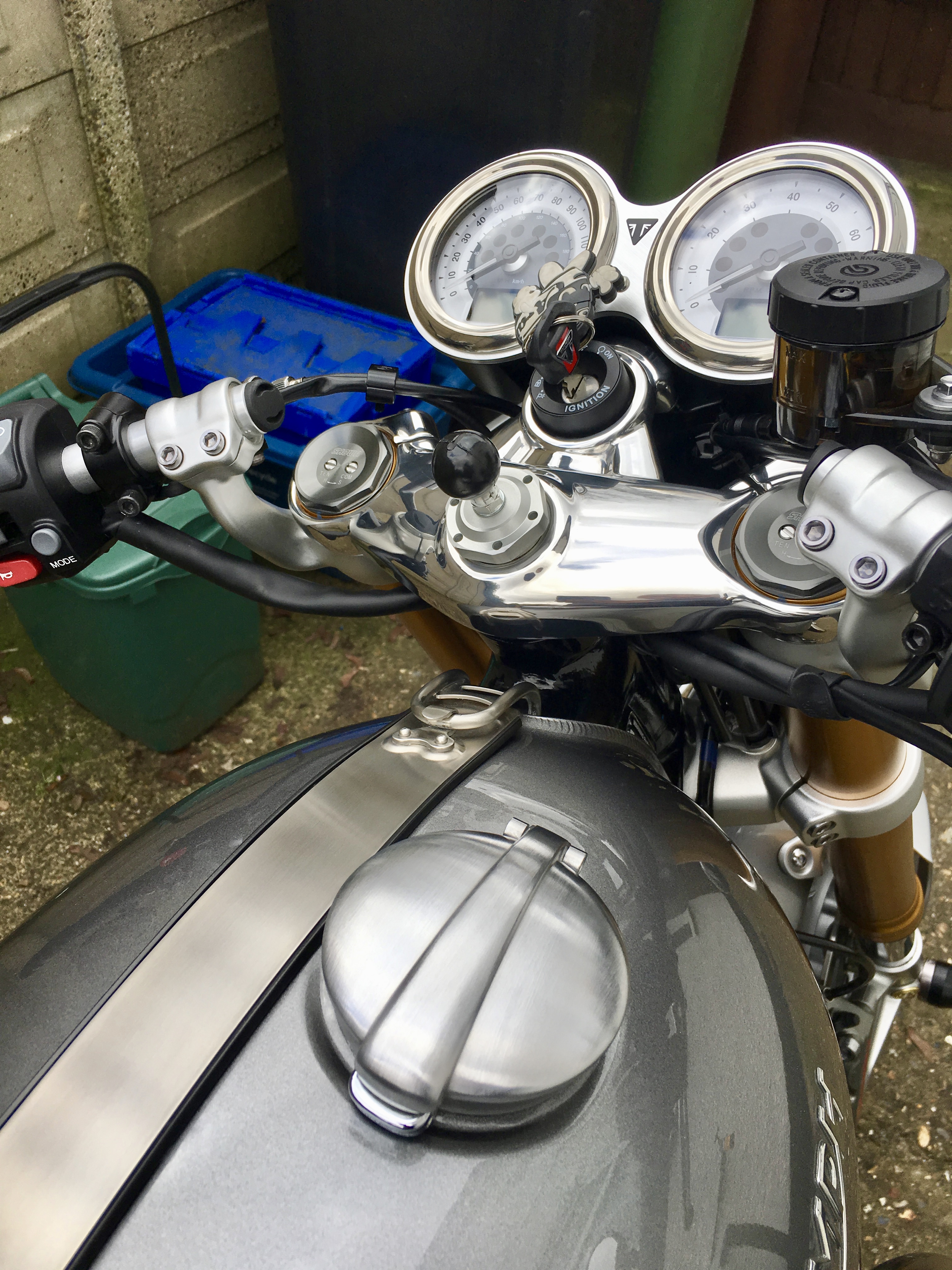

    Finally got round to doing my Telferiser mount.Turned the Monza cap the other way too!!! fullsizeoutput_a27.jpeg

    That looks like they've just drilled a hole in the centre of the top nut and fitted a rivnut, got a rivnut kit in my garage so now I know how I'll do mine if I need to. Clas Ohlson do Ram Mount kits I notice, not sure if they are cheaper though.
