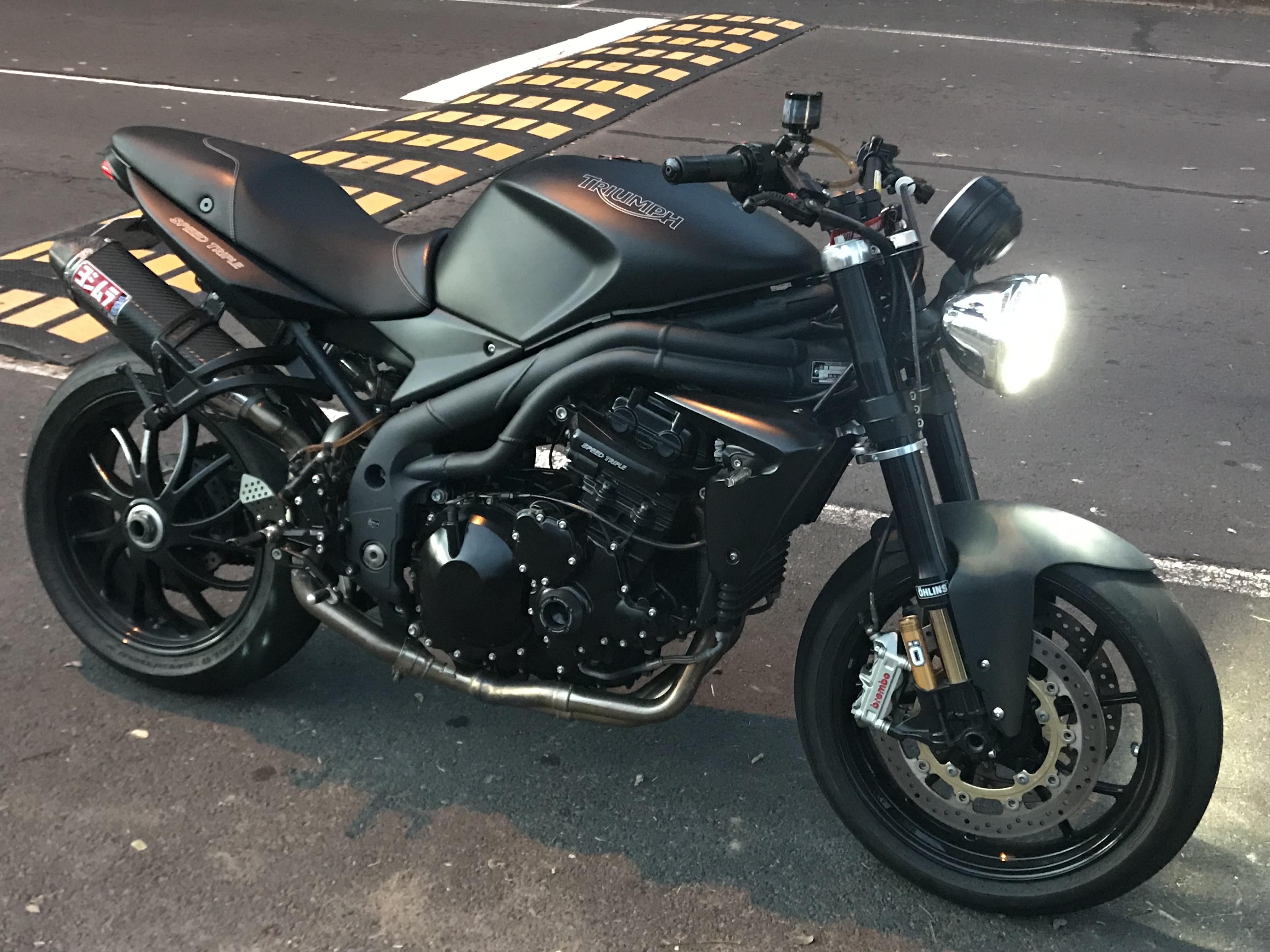

    Just went for a ride on my new LED headlight bulbs love it
    And it doesnt bother incoming traffic
    Best mod i ve done in years
    The light is so bright and white very happy
