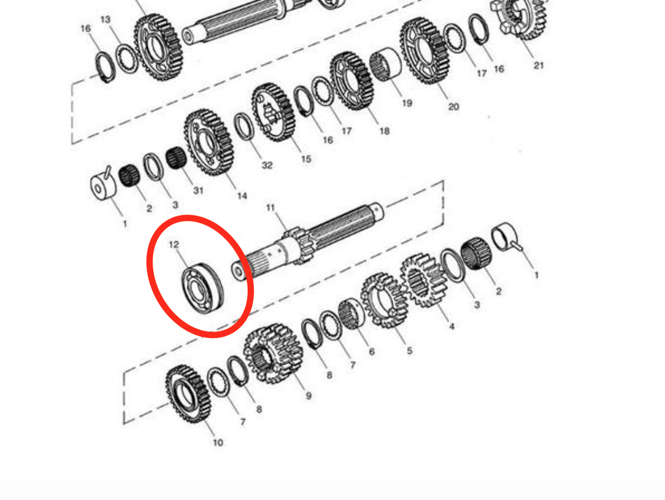

    Try to adjust the video settings, they are all HD. Not sure which bearing you mean, is this one?

    No. I am talking about the wheel on the detent arm that rides on the irregular star shaped detent wheel. Excessive slack there would not create sufficient movement in the selector drum.
    I am not saying there IS a problem just that I cannot be certain from the picture.
