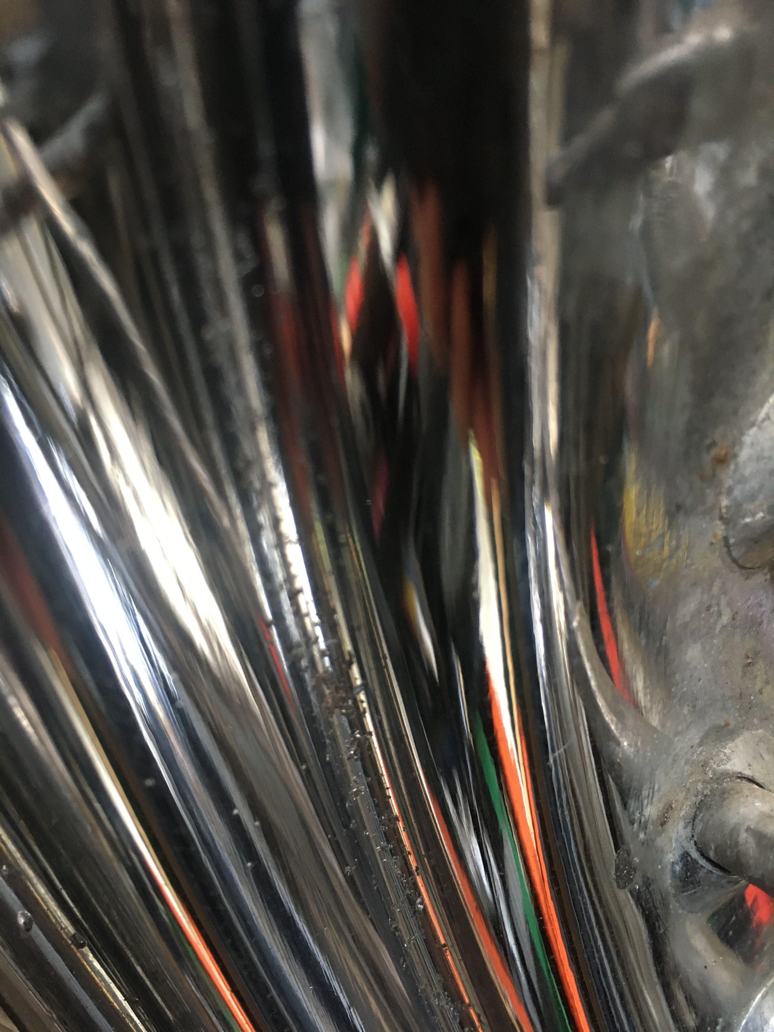

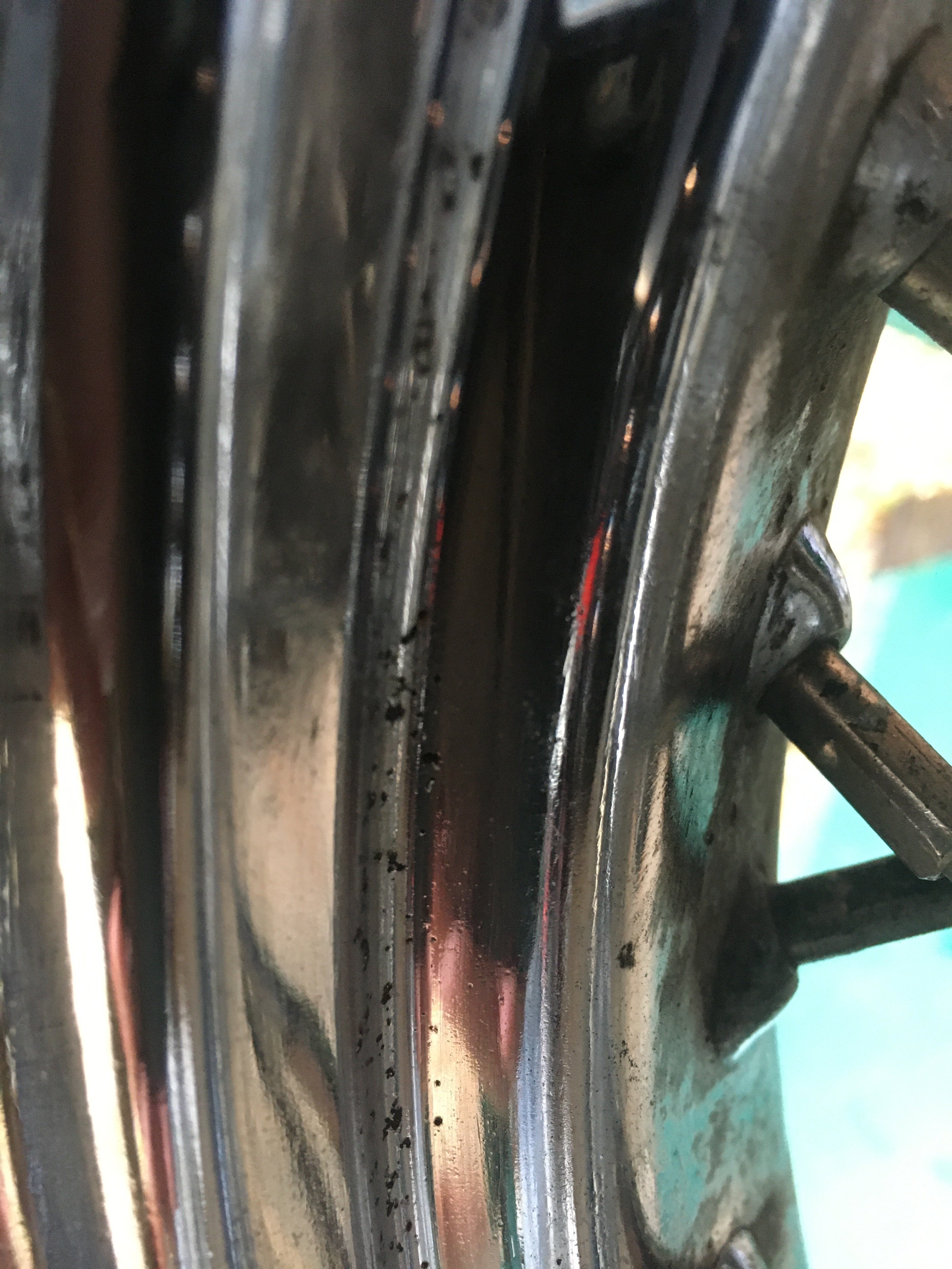

  9. Tom Gillam
    Tom Gillam Guest
    As promised the photos,which aren’t that great.
    Has anyone out there tried one of those chrome repair pencils,I’m more interested in titivating than a long term solution,which would probably be a strip,powder coat and rebuild?

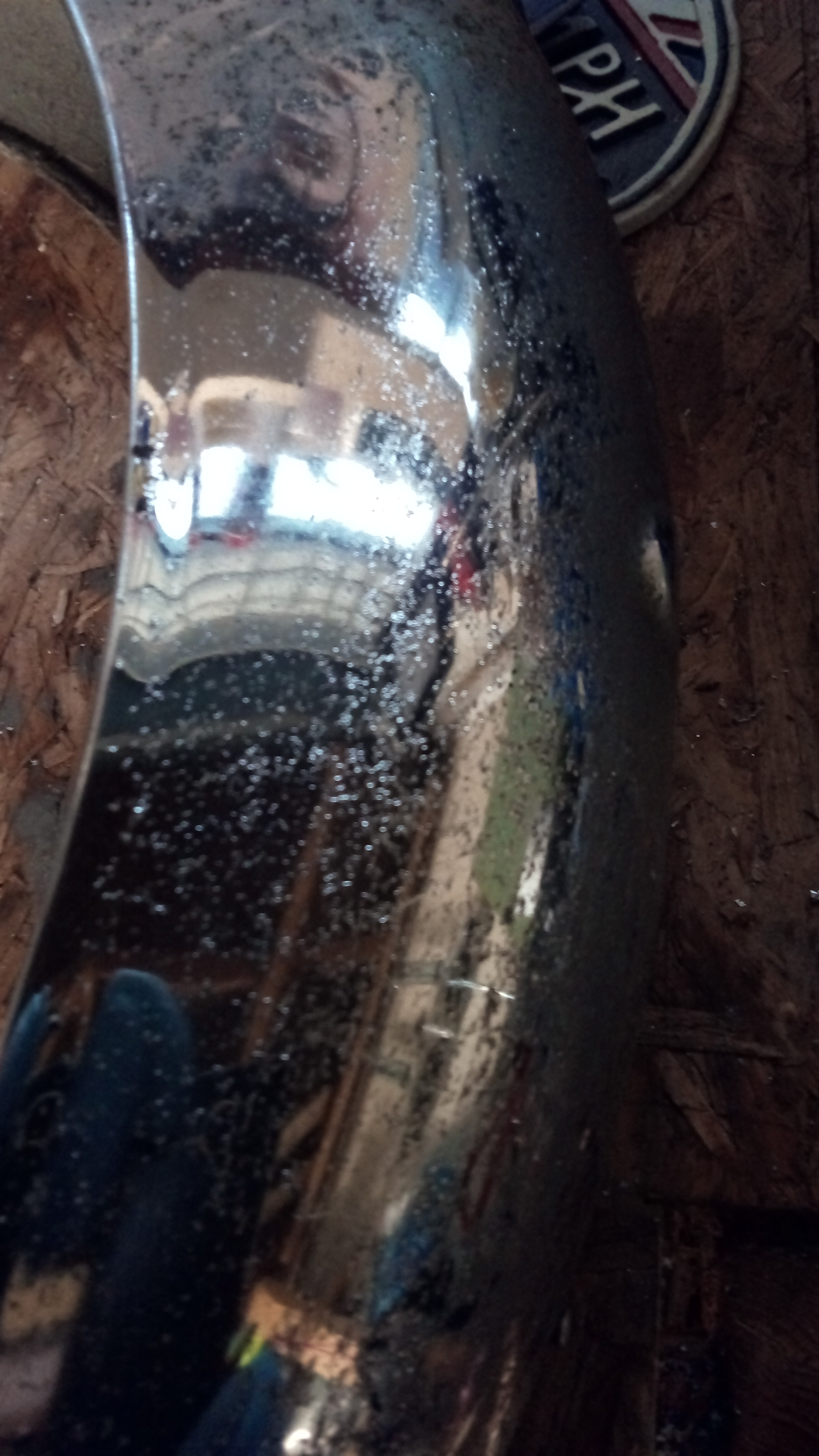

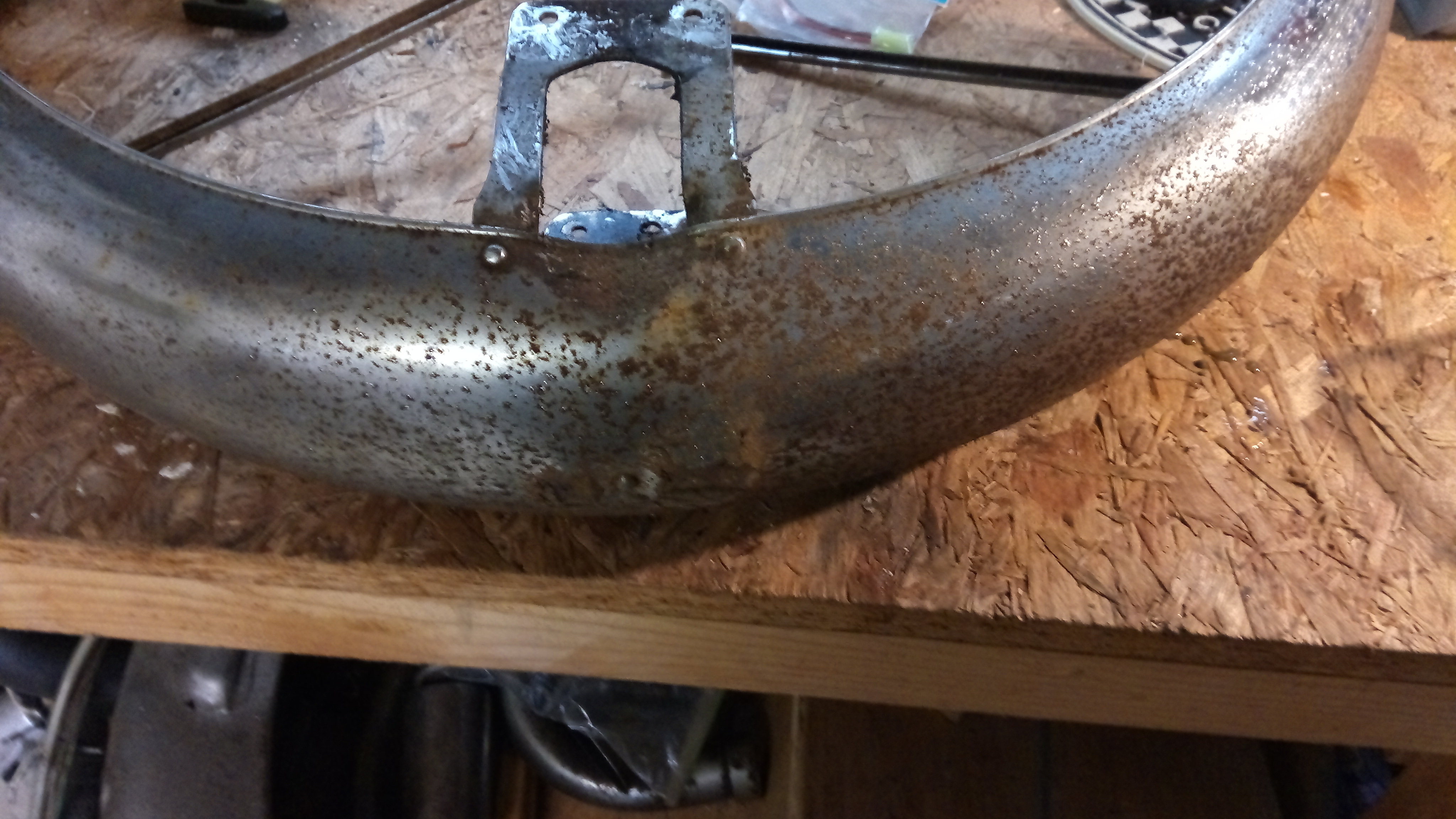

  16. andypandy
    4,083
    I did a bit of work on my 71 cb250 mudguards yesterday.
    Here is a before and after picture.
    I just used ali foil and water.
    I haven't finished yet but I don't expect to get all the pitting out, they are quite bad.
    I'll probably end up buying a new front but making do with the rear as not much of it
    will actually be visible.

    You only used foil and water? Does it matter which side of the foil?
  20. brown mouse
    brown mouse Elite Member
    Sep 15, 2018
    2,288
    943
    East Midlands, UK
    Both sides are essentially the same, I just use it scrunched up. I believe it's just a soft (compared to chrome) scrubber so doesn't scratch it, but it's harder than cleaning rags you may use for bike and so requires less effort to rub off the rust.
    I must admit I usually just rub wheels hard with the microfibre cloth I have handy when I'm cleaning, rather than fetching some aluminium foil.
