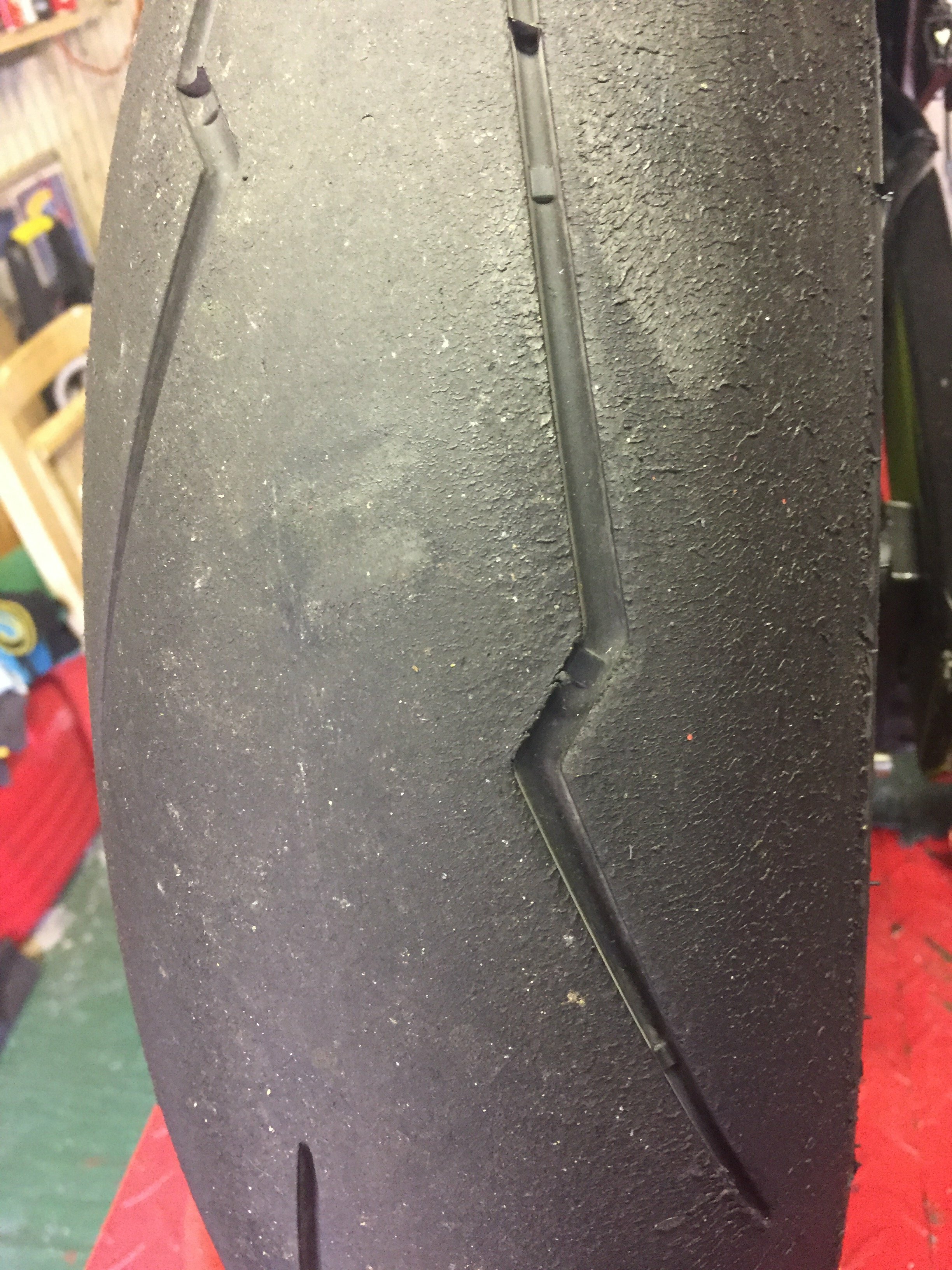

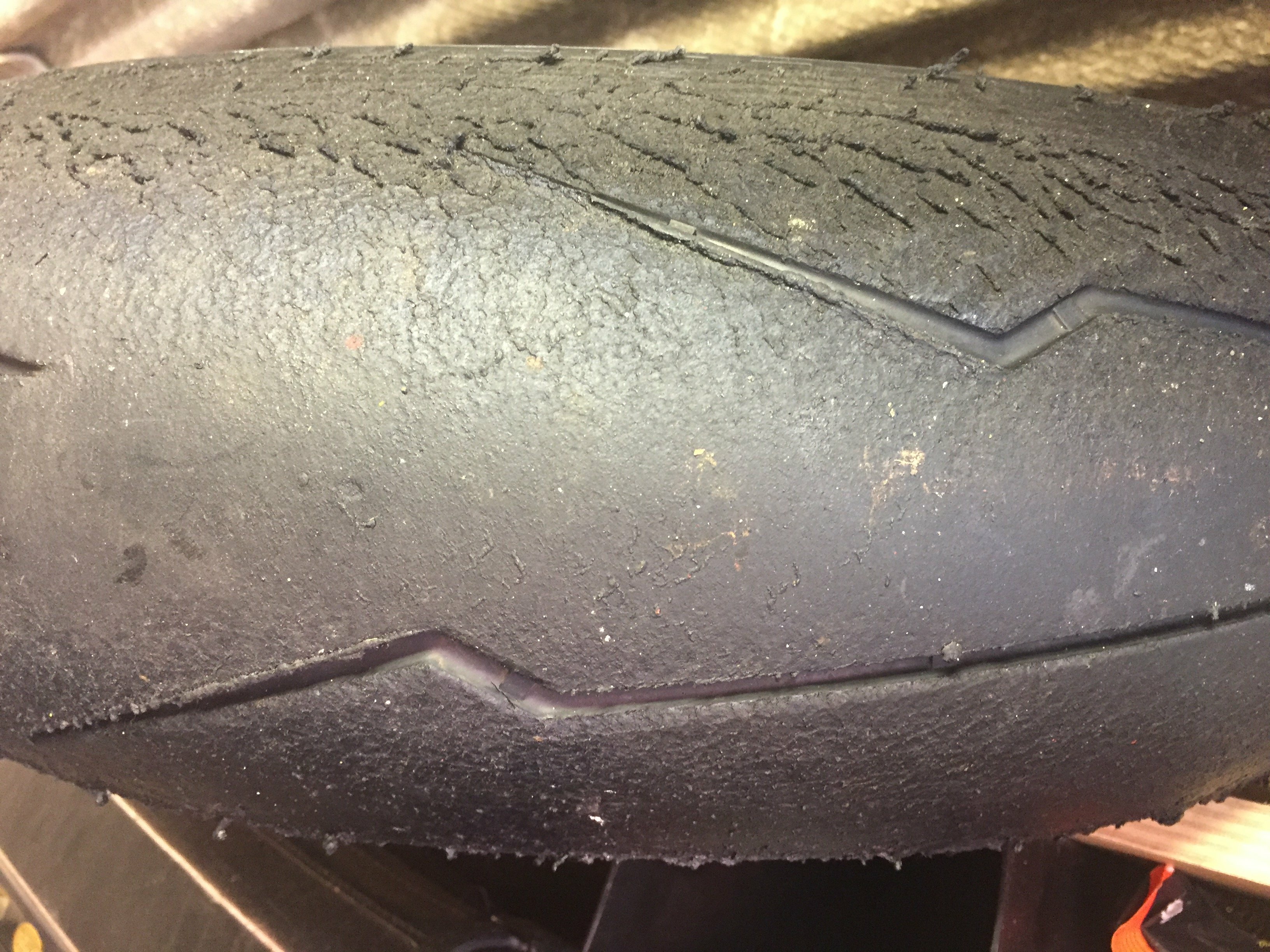

    Just thought about tyre pressure s, set at 30 psi front & rear to start with & if not using tyre warmers give 2 laps of every session before going for it.

    Thanks mate great advice. I didn't realise I should drop the psi that much.
  11. Bad Billy
    6,800
    If you don’t you will chew rear tyre up, there is much more heat generated when riding on track. If you’re a little unsure then only drop to 32 psi front but would set rear at 30. I use Pirelli Super Corsa SC2’s for racing a 600 Bandit & my pressures are set to 30 front 26 rear measured cold.

    3F06CC72-1555-43D0-B6C5-1B52E23E690B.jpeg 34BA5A4B-A5A9-4D1A-8E7E-CF20A82F1417.jpeg First pic shows tyre run on 4 psi higher (30) second is running 26, this at race pace though.

    Wow! Yeah, that is quite a noticeable difference
