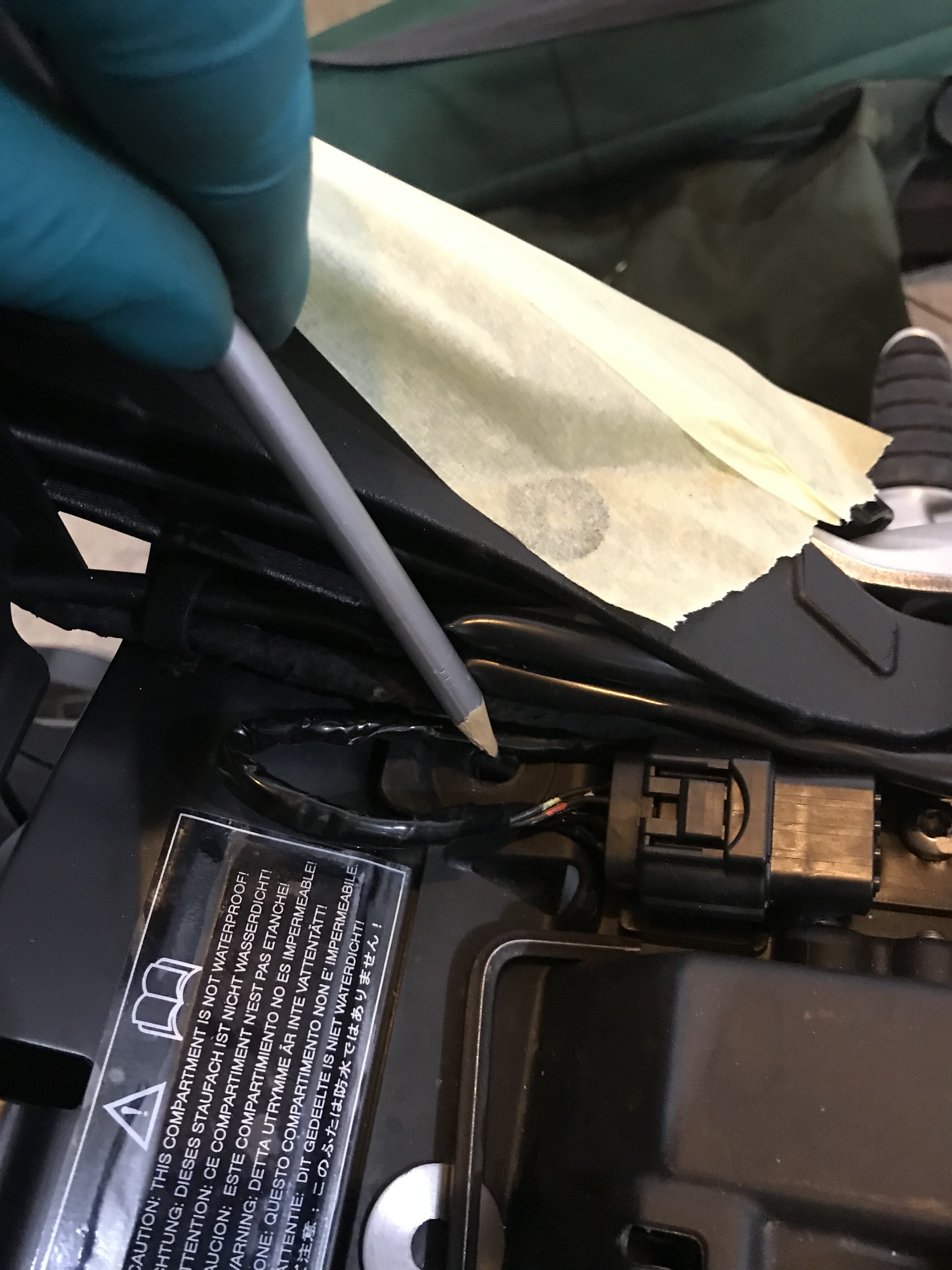

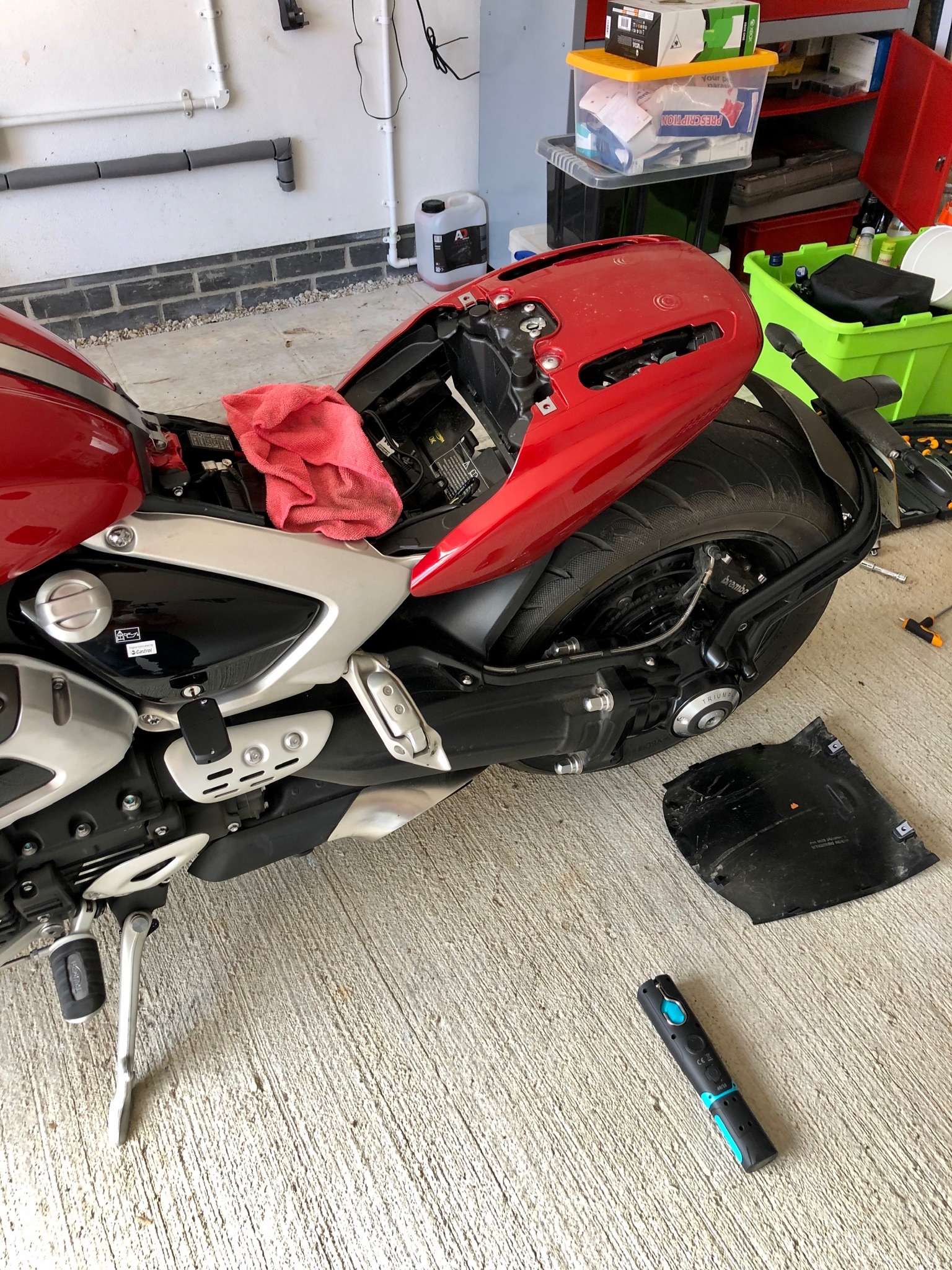

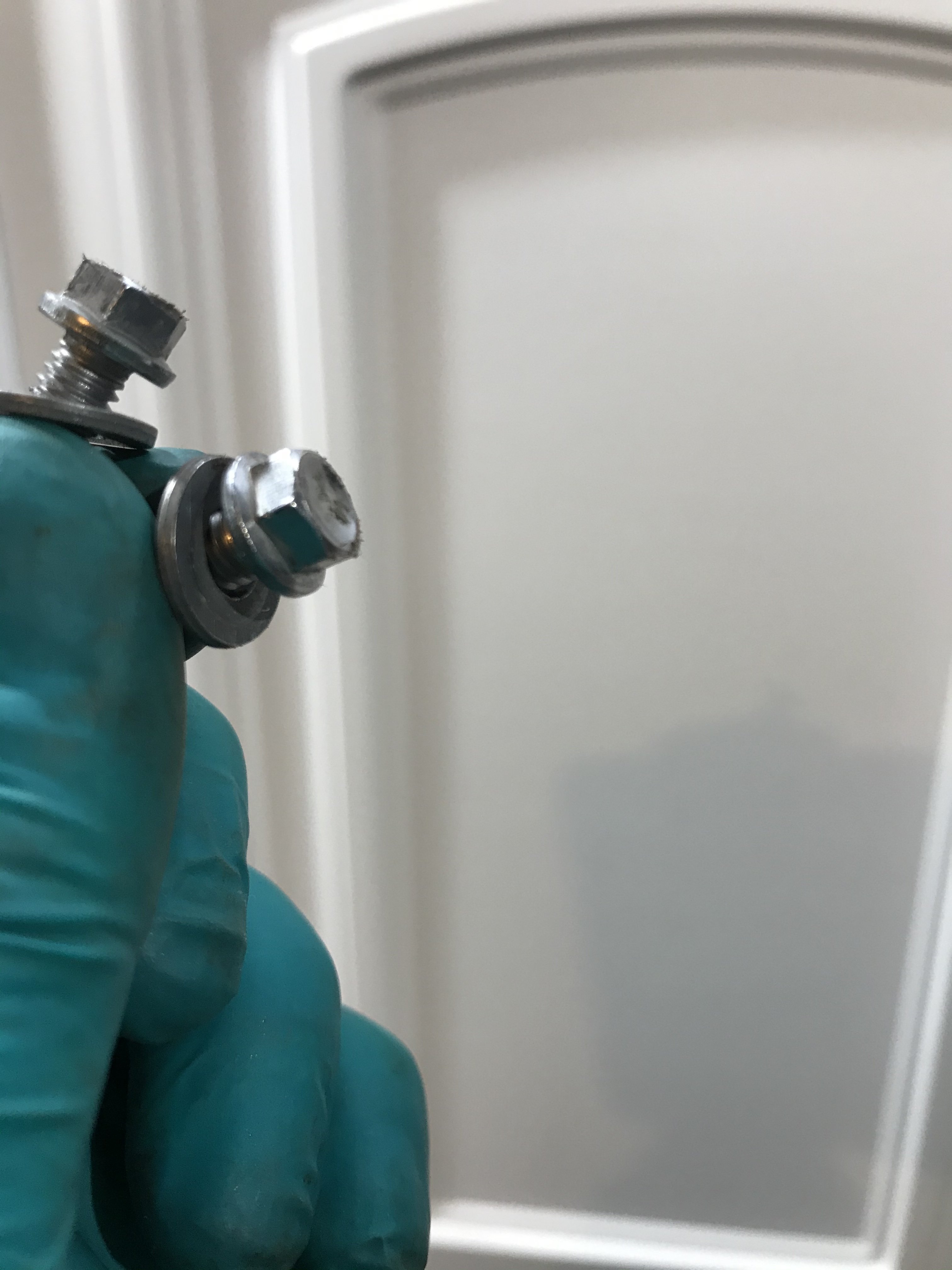

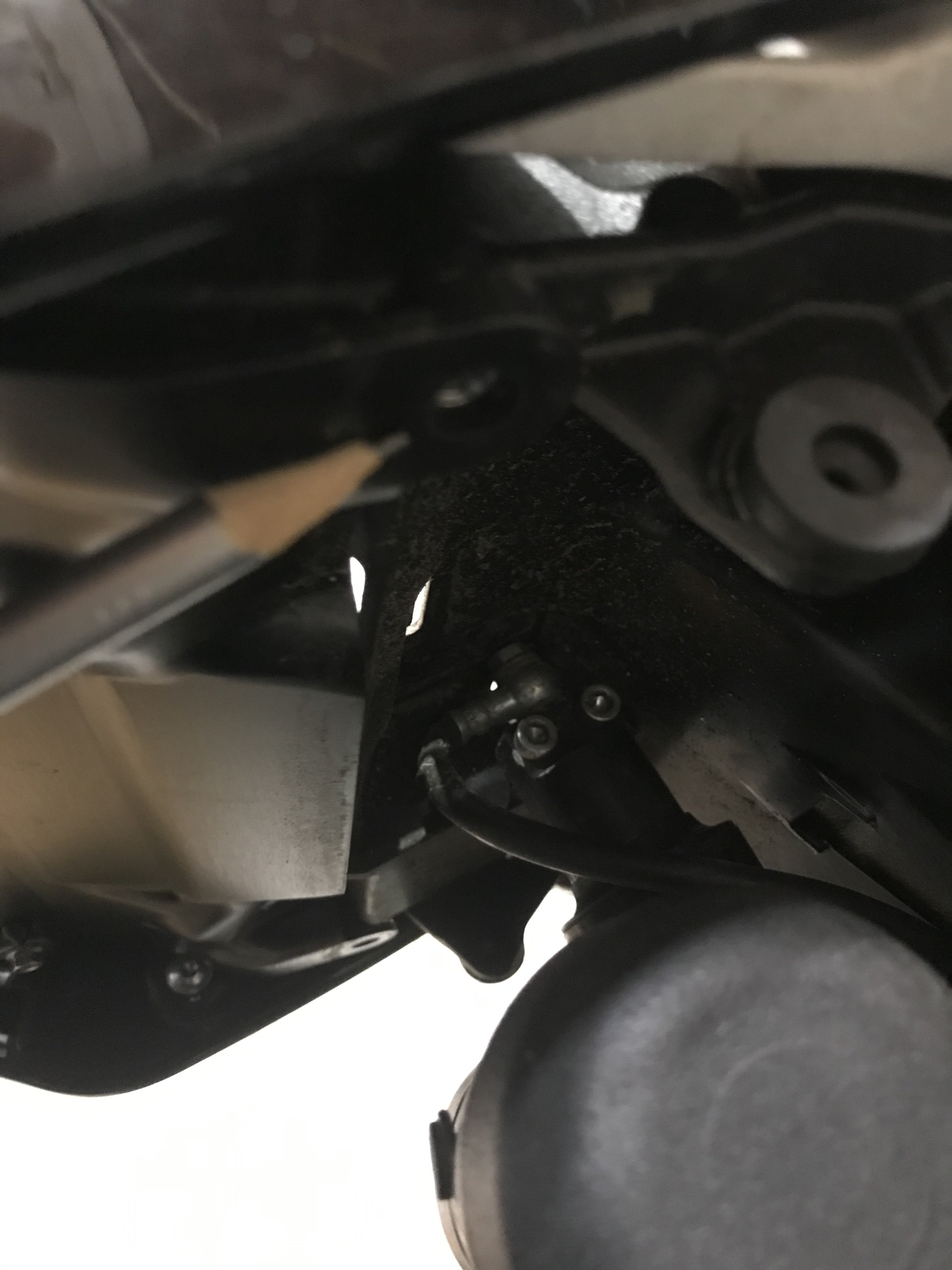

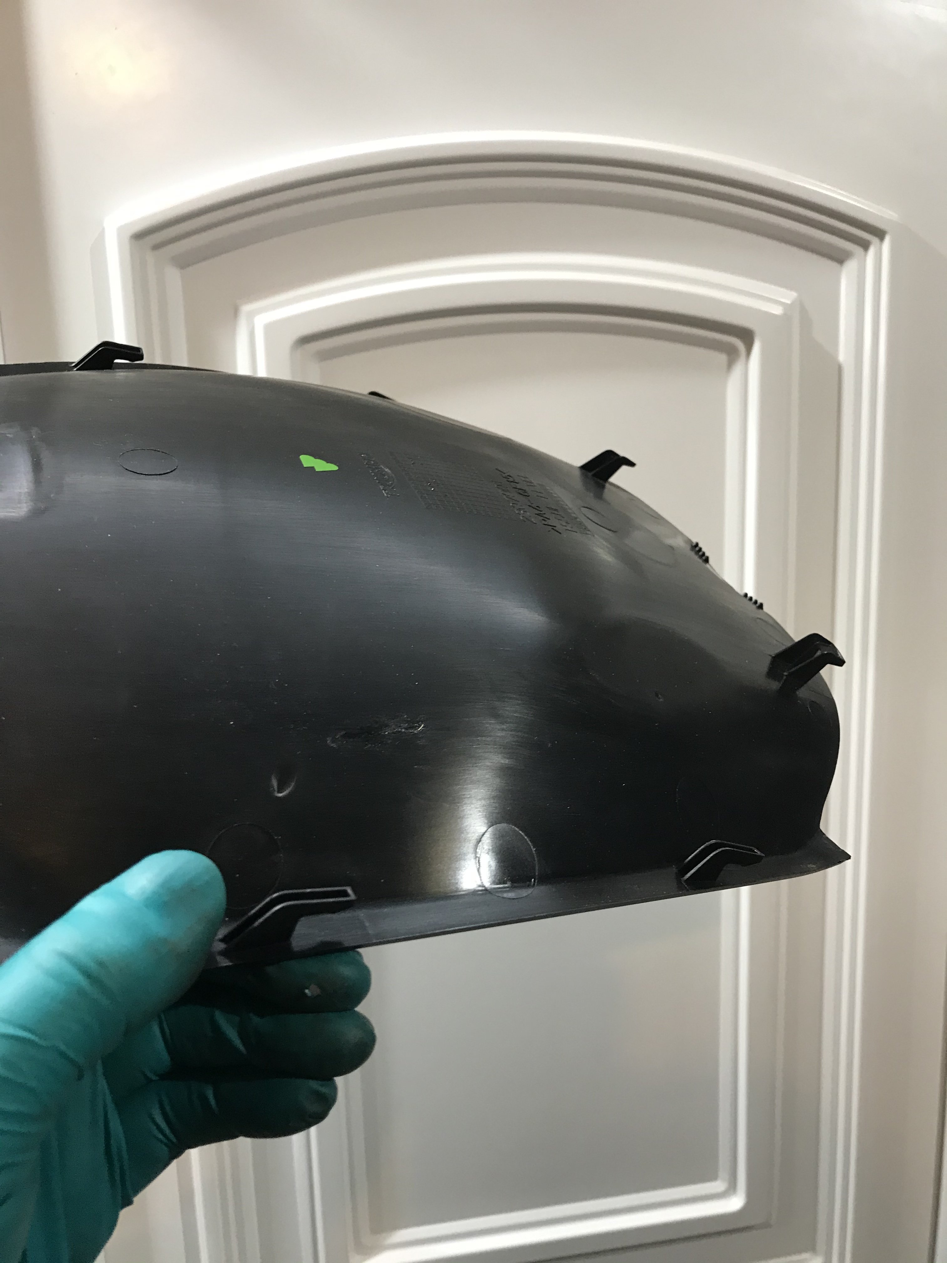

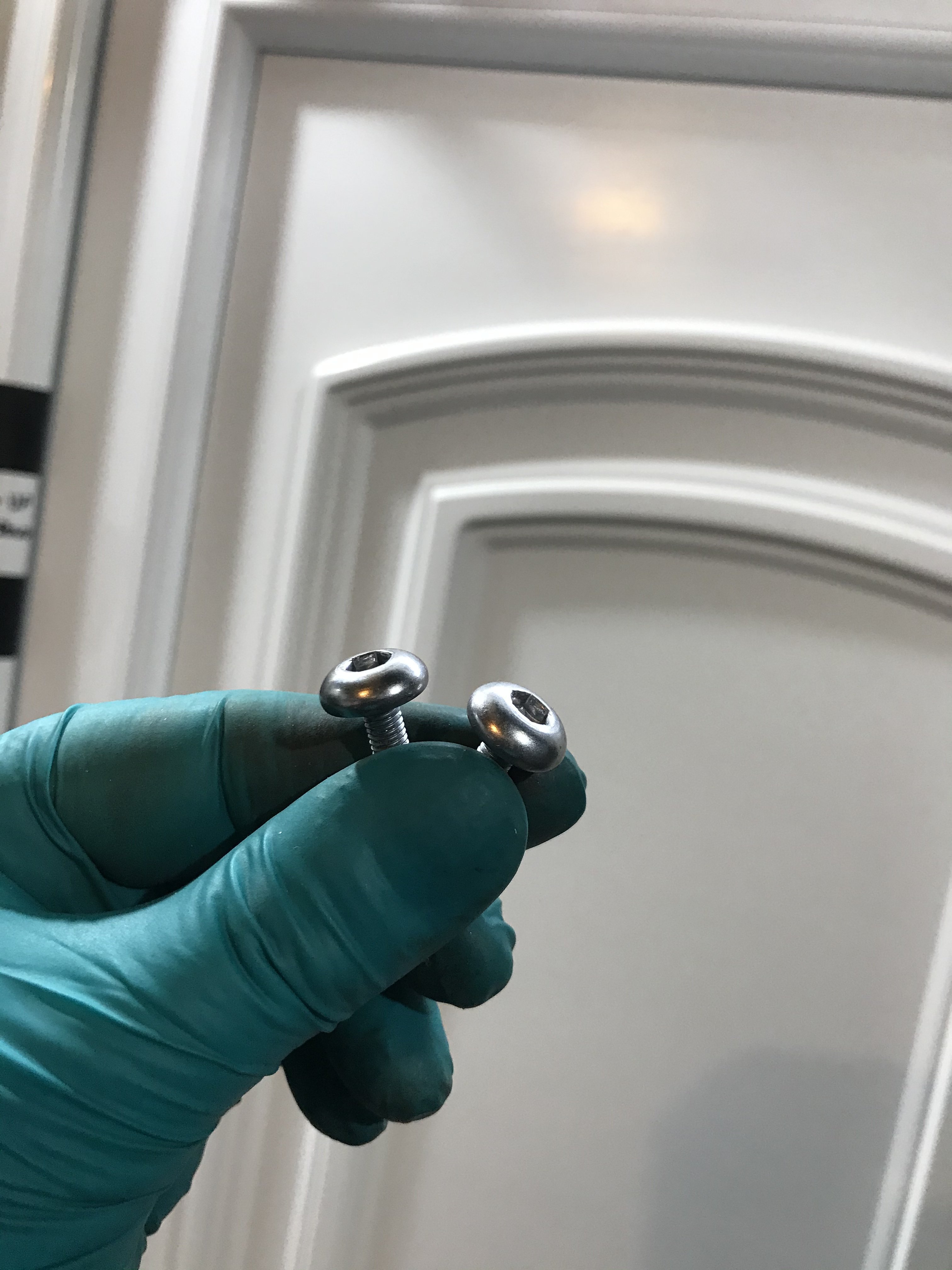

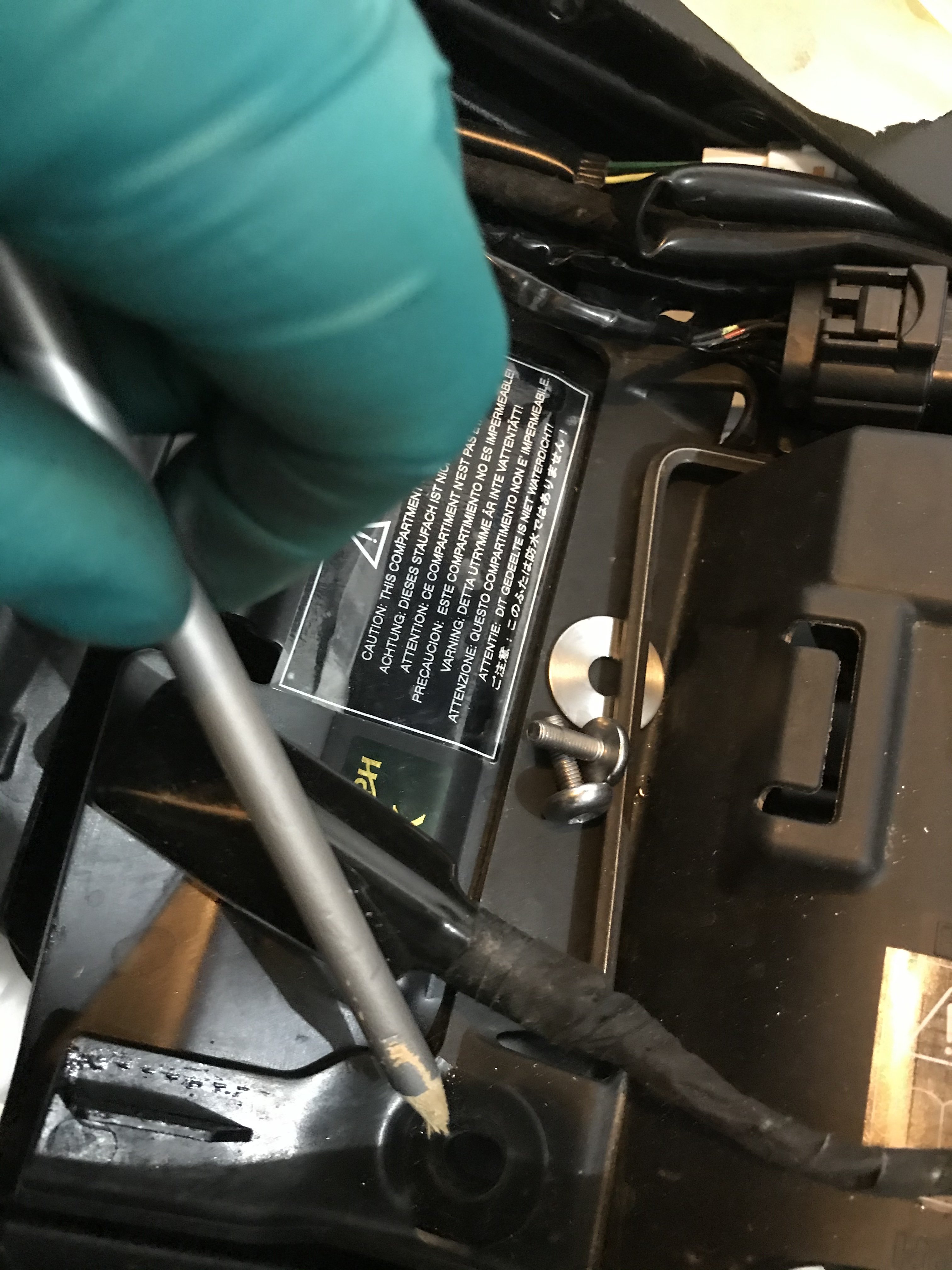

Hi @Dobbo The under tray is held in with four bolts These two are underneath Here....one either side of the bike 8mm socket or spanner two from the top underneath the seat Allen heads here and here after removing these I used the side of my hand/fist and bumped the tray towards the shock to release it from the clips six of them hold it in place and they can be a bit of a pain trying to get them back into position but I’ve done this a few times now and now have the hang of it Hope this helps

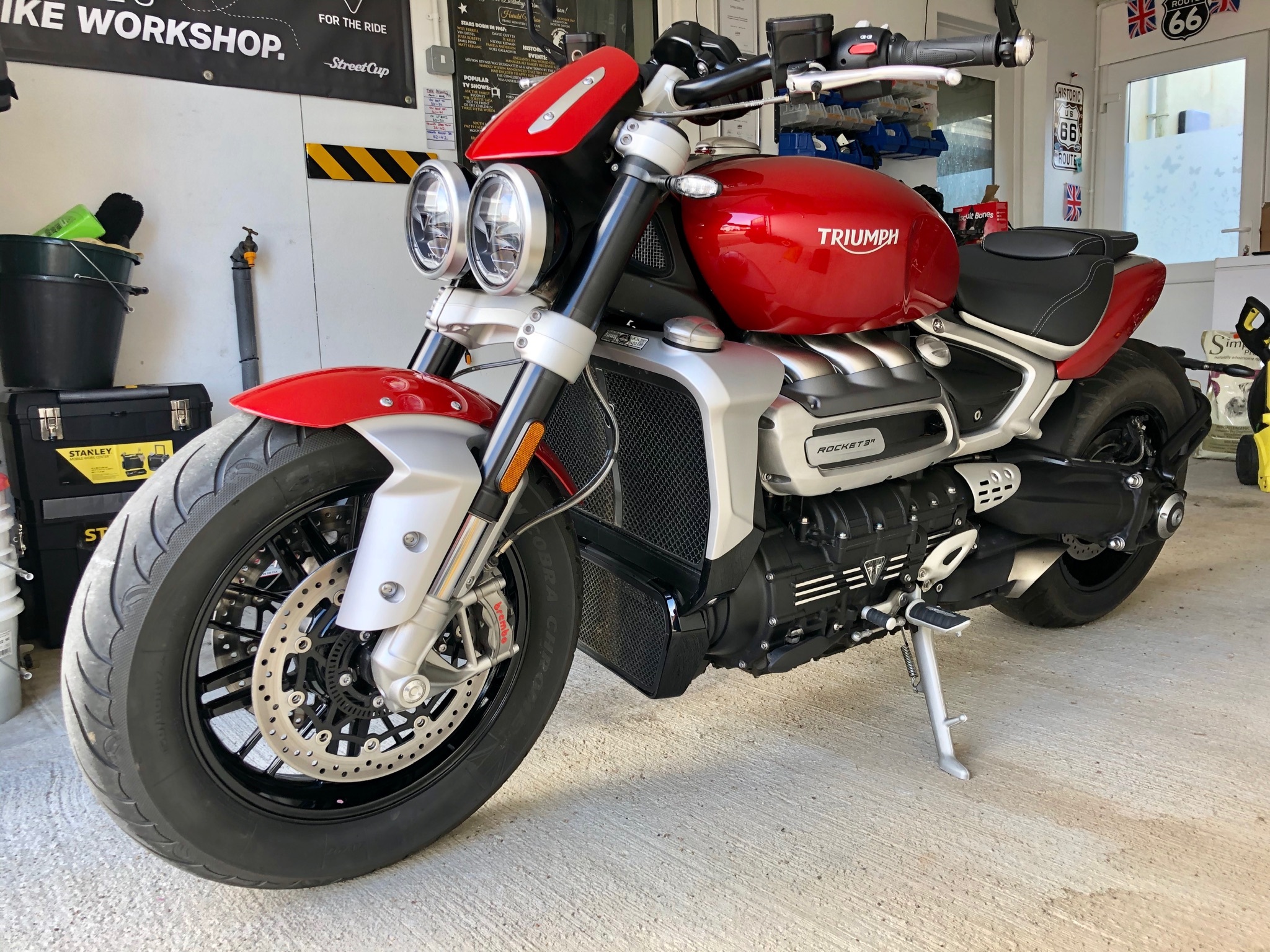

All done, nice and straightforward - thanks to Dilligaf for the photos and guide! Nice to see my Rocket back in standard trim without the backrest.
