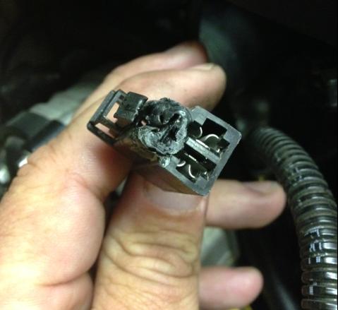

  5. Spudda
    Spudda Member
    May 2, 2012
    33
    6
    Penn, Nr Wolverhampton
    The bike started off a battery pack at the roadside but the volts dropped
    I'm getting a constant reading off the lead that goes from the stator to the rectifier with the bike off
    I too think the rectifier is fried. I reckon its over charged and melted the plug :eek:

    Yep that looks like your culprit - at least you know what it is now! Do you know someone close with the same bike? could swap the rectifiers and give it a go?
