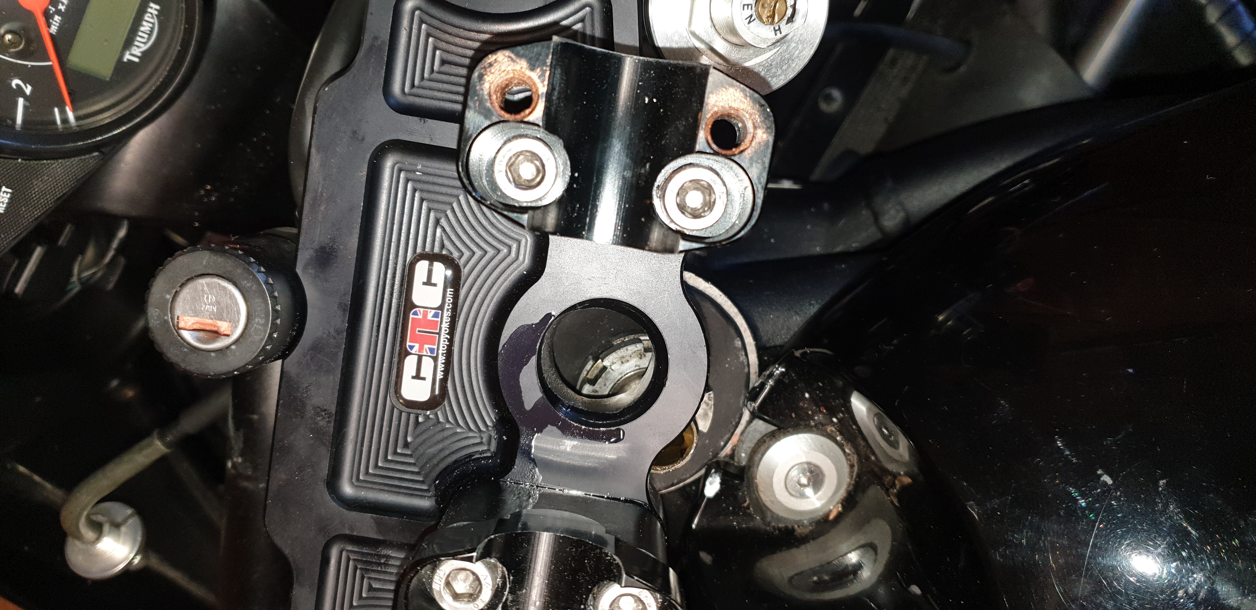

    then spotted a local member who was selling a cnc top yoke risers and bars and he lives about 10 Mile's away, yippee!! deal done on phone he even dropped them round to me !! fantastic, but as I'm not 100% sure If all 955i /595 top yokes are the same so I asked him will they be right for late06 model but he assured me as a bike enthusiast and mechanic YEP THERE ALL SAME,
    no there absolutely NOT,
    the one he sold me was for 98/04 yoke with a 25mm stem, changed from 04 onwards to 22mm stem and conventional stem nut. now my friendly local triumph forum member is refusing to take them back and completely ignoring all messages despite specifically saying mine had conventional top yoke nut and was he sure it would be ok ,ANYWAY just a cautionary note to all the genuine forum users A; yokes aren't all interchangeable B; there are unfortunately some not so scrupulous folk using the forum. BE AWARE! dont want any one else losing over £150.

    Foxy if the issue is just the stem diameter can't a sleeve be machined up and slipped under the nut?
    Post some pictures of the top yoke, top and bottom views?

    no its bit more, the threads are totally different on the stem from 04 onwards, the top yoke nut is completely different both in thread and the way it sits I'm ordering brand new setup from topyokes,(cnc) and ill sell this one but will be sure to say it only fits pre 04 with the round tapered seated top nut I'm on 12/13 hour days all this week till sunday so not have much time for pics heres a few already on phone :eyes: 20190311_152949.jpg
    20190311_142837.jpg 20190311_142823.jpg 20190311_152949.jpg and the stem pics I've already taken 20190311_142935.jpg
