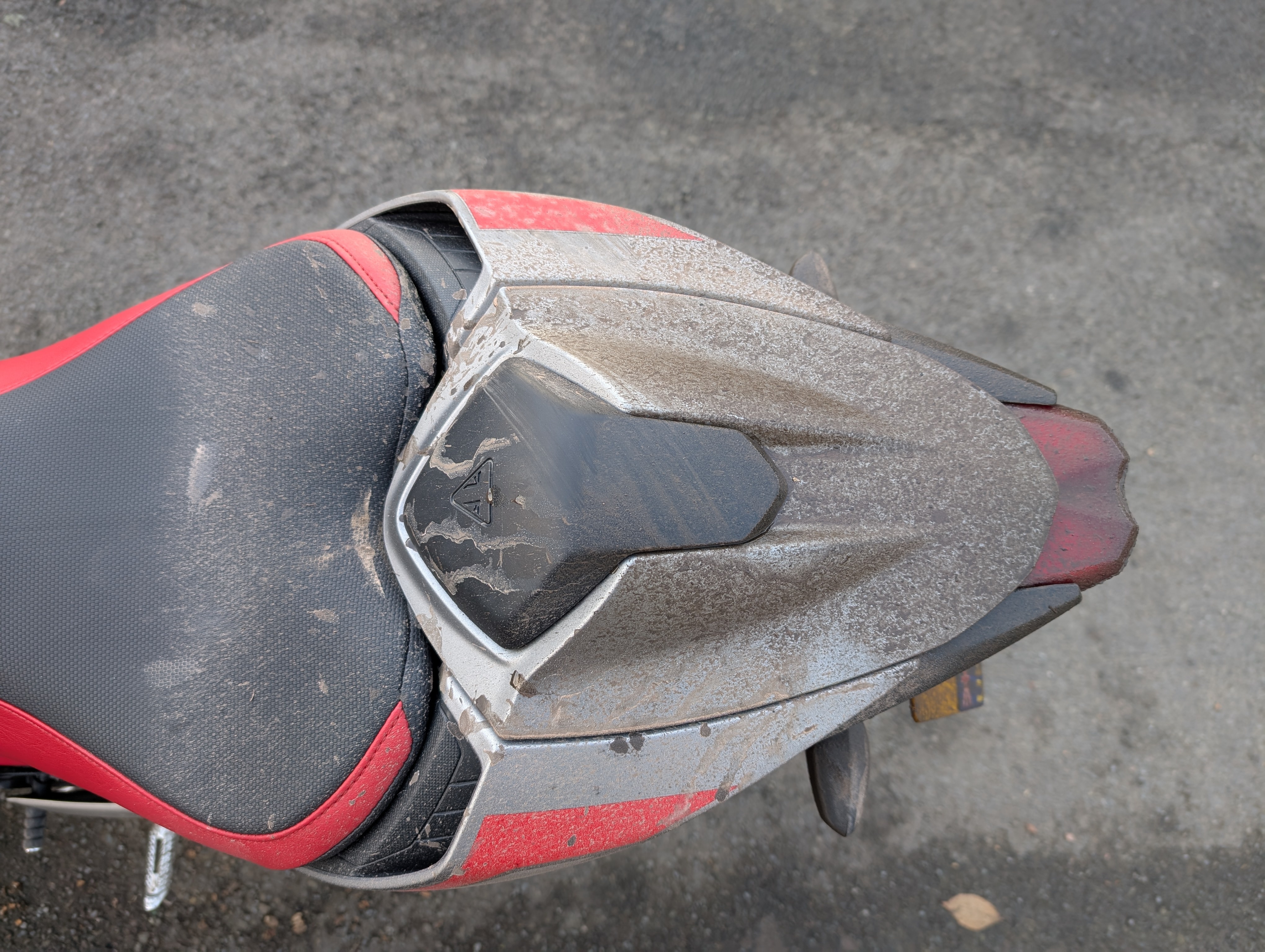

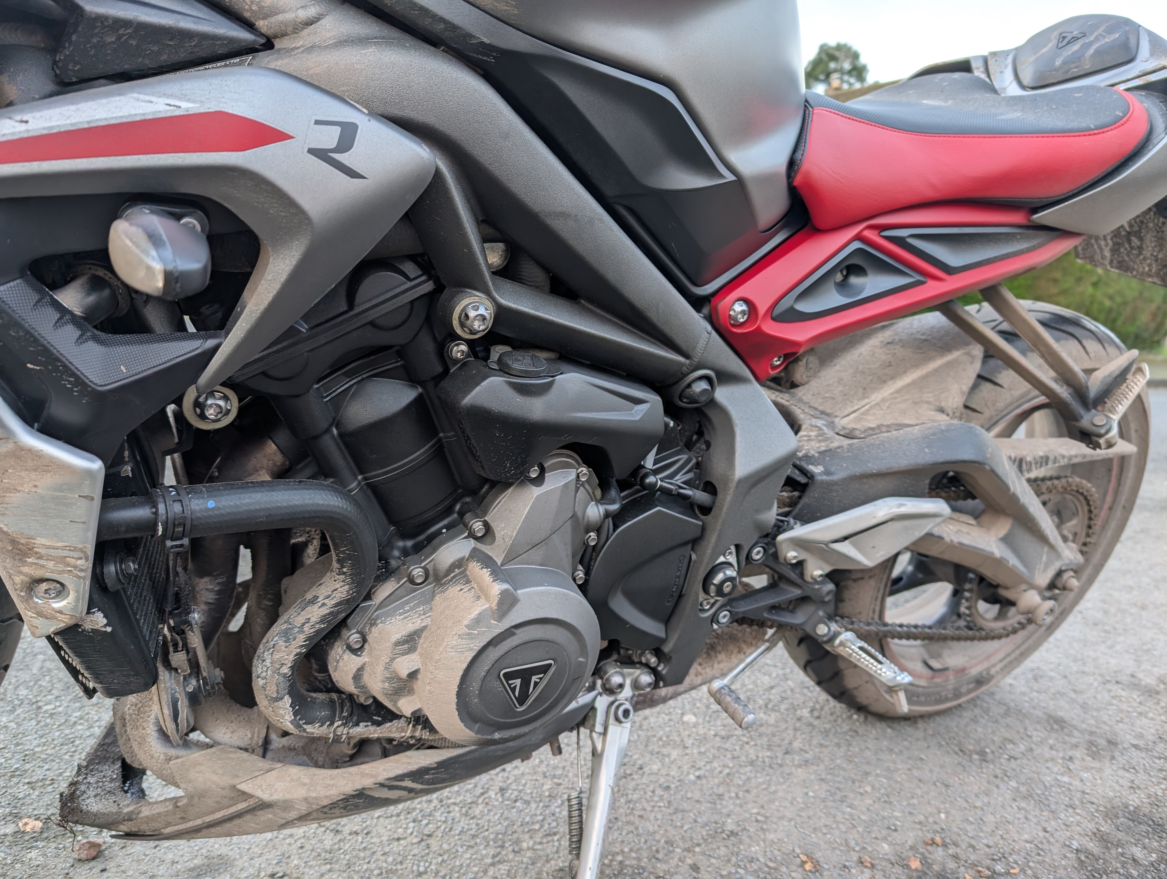

    I have a cheap pet dryer, but other than that resign myself to my street triple looking like this:
    And me like a mud monster. The short tails on these bikes look great.....but keeping them clean is not easy!!

    3,835
    Blimey, do you live on a farm Mrs V?:laughing:
